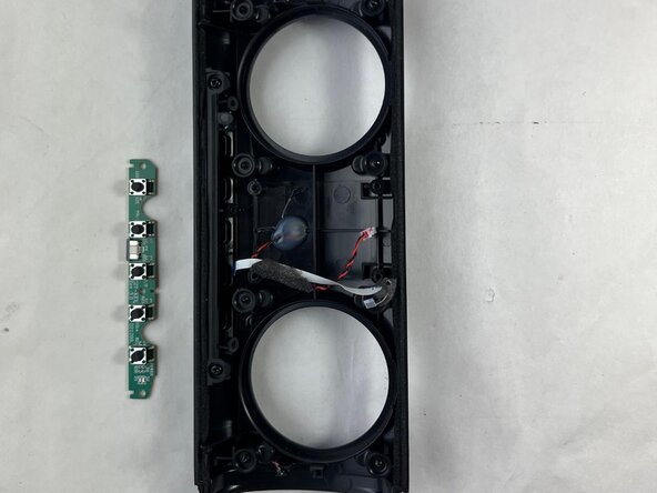

  8. BolaButty X-GO C27-C Daughterboard Replacement, Drivers: crwdns2935265:08crwdnd2935265:01crwdnd2935265:02crwdne2935265:0 BolaButty X-GO C27-C Daughterboard Replacement, Drivers: crwdns2935265:08crwdnd2935265:02crwdnd2935265:02crwdne2935265:0
    • Remove the LED board.
    • There will be some adhesive securing the board in place, so it won't feel like it will come out easily. Wiggle the board back and forth to loosen it before pulling vertically to remove.

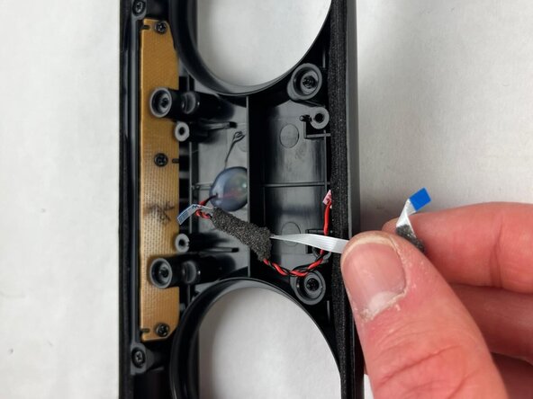

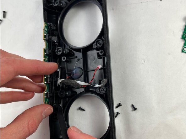

  14. BolaButty X-GO C27-C Daughterboard Replacement, Daughterboard: crwdns2935265:014crwdnd2935265:01crwdnd2935265:02crwdne2935265:0 BolaButty X-GO C27-C Daughterboard Replacement, Daughterboard: crwdns2935265:014crwdnd2935265:02crwdnd2935265:02crwdne2935265:0
    • Disconnect the ribbon cable from the daughterboard.
  15. BolaButty X-GO C27-C Daughterboard Replacement: crwdns2935265:015crwdnd2935265:01crwdnd2935265:01crwdne2935265:0
    • Remove the three 10 mm Phillips screws that secure the daughterboard.
  16. BolaButty X-GO C27-C Daughterboard Replacement: crwdns2935265:016crwdnd2935265:01crwdnd2935265:03crwdne2935265:0 BolaButty X-GO C27-C Daughterboard Replacement: crwdns2935265:016crwdnd2935265:02crwdnd2935265:03crwdne2935265:0 BolaButty X-GO C27-C Daughterboard Replacement: crwdns2935265:016crwdnd2935265:03crwdnd2935265:03crwdne2935265:0
    • Gently lift out the daughterboard and remove it.
