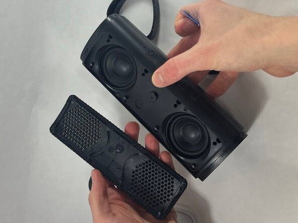

    • Take an opening tool or pick and wedge it into the groove between the endcap and the main casing. Wiggle it back and forth.
    • Strike the speaker endcap firmly against a solid surface to pop the end caps off.
    • Removing the end caps requires a good amount of force. There is a realistic chance that you will damage your speaker or break the caps.

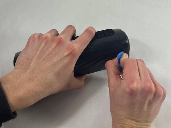

    • Wedge an opening tool or a pick under the speaker cover and work it back and forth to loosen it. Repeat for all four sides.
    • Remove the speaker cover.

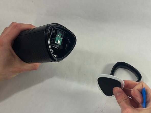

    • Remove the eight 12 mm screws securing the driver housing using a Phillips #0 screwdriver.
    • Gently pull apart the two halves of the speaker.
    • Take care not to strain the cables.

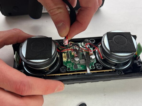

    • Use a Phillips #0 screwdriver to remove the three 10 mm screws securing the charging housing.
    • Separate the charging port from the battery.

    • Use a pair of tweezers to lift the black ZIF locking flap securing the ribbon attached to the charging port.
    • While pulling up on the latch, remove the ribbon.
