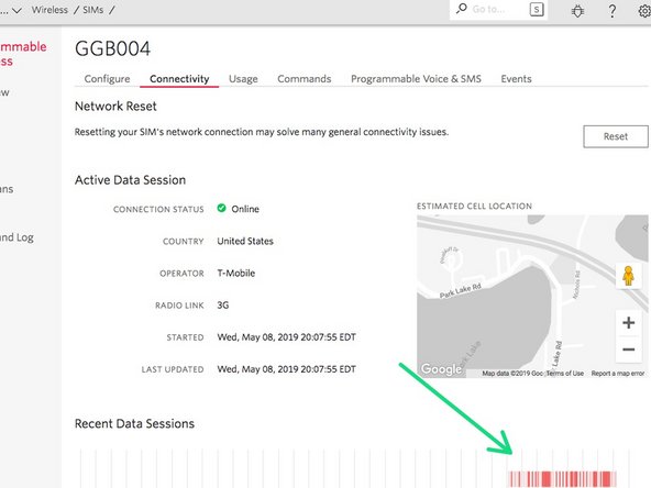

  3. Board Configuration for Nodes - RTWS Branko Kerkez, Before You Begin: crwdns2935265:04crwdnd2935265:01crwdnd2935265:02crwdne2935265:0 Board Configuration for Nodes - RTWS Branko Kerkez, Before You Begin: crwdns2935265:04crwdnd2935265:02crwdnd2935265:02crwdne2935265:0
    • Make sure SIM cards have been activated by checking their status on Twilio while attached to a board and modem known to be working.
    • Here's a link to where you can check a SIM cards connectivity in Twilio: https://www.twilio.com/console/wireless/... The page should look like the first photo
    • Type in the first two rows of numbers on the SIM card in the search bar to find it
    • Once at the page for your specific SIM card click on connectivity and check to see if any red shows up on the timeline. An example of this can be seen in the second photo.
    • It takes a while for the connection to register on Twilio so wait a while and keep refreshing before determining the SIM card is not active.

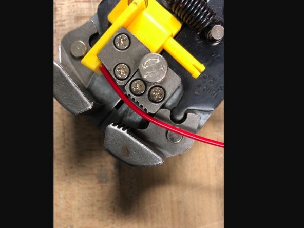

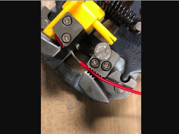

  4. Board Configuration for Nodes - RTWS Branko Kerkez, Fashion Connectors: crwdns2935265:05crwdnd2935265:01crwdnd2935265:03crwdne2935265:0 Board Configuration for Nodes - RTWS Branko Kerkez, Fashion Connectors: crwdns2935265:05crwdnd2935265:02crwdnd2935265:03crwdne2935265:0 Board Configuration for Nodes - RTWS Branko Kerkez, Fashion Connectors: crwdns2935265:05crwdnd2935265:03crwdnd2935265:03crwdne2935265:0
    • Obtain red, black, and white wires from spools seen in the first photo
    • Cut a length of six inches of each color
    • Strip the wires by placing them in the wire stripper and pressing together as seen in the second and third photos

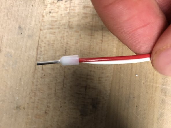

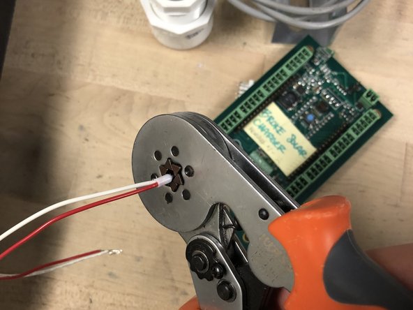

  5. Board Configuration for Nodes - RTWS Branko Kerkez, Fashion connectors continued: crwdns2935265:06crwdnd2935265:01crwdnd2935265:03crwdne2935265:0 Board Configuration for Nodes - RTWS Branko Kerkez, Fashion connectors continued: crwdns2935265:06crwdnd2935265:02crwdnd2935265:03crwdne2935265:0 Board Configuration for Nodes - RTWS Branko Kerkez, Fashion connectors continued: crwdns2935265:06crwdnd2935265:03crwdnd2935265:03crwdne2935265:0
    • Twist one end of the red and white connectors together as seen in the first photo
    • Insert the wires into the head as seen in the second photo. Make sure they are inserted as far as possible
    • Crimp the metal end of the head by placing it in the crimper and pressing all the way down as seen in the third photo
    • Insert all remaining wire ends into heads and crimp the heads as previously described

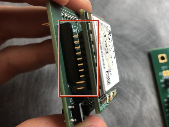

  8. Board Configuration for Nodes - RTWS Branko Kerkez, Attach Cell Module to Small Board: crwdns2935265:09crwdnd2935265:01crwdnd2935265:02crwdne2935265:0 Board Configuration for Nodes - RTWS Branko Kerkez, Attach Cell Module to Small Board: crwdns2935265:09crwdnd2935265:02crwdnd2935265:02crwdne2935265:0
    • Align and insert modem pins into the small board pushing them all the way in as seen in the first photo. Make sure the ports of the modem are on the same side as the button of the little board.
    • Make sure ALL pins are aligned. The second photo is an example of misaligned pins

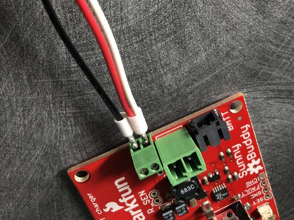

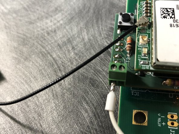

  10. Board Configuration for Nodes - RTWS Branko Kerkez, Wire Connections: crwdns2935265:011crwdnd2935265:01crwdnd2935265:03crwdne2935265:0 Board Configuration for Nodes - RTWS Branko Kerkez, Wire Connections: crwdns2935265:011crwdnd2935265:02crwdnd2935265:03crwdne2935265:0 Board Configuration for Nodes - RTWS Branko Kerkez, Wire Connections: crwdns2935265:011crwdnd2935265:03crwdnd2935265:03crwdne2935265:0
    • Screw in red and black connectors into big board terminal as seen be in the first photo
    • Screw in black connector and combined red and white connectors into sunny buddy terminal as scene in the second photo
    • Screw in white connector into little board terminal as seen in the third photo
    • Make sure the connectors are in the exact same orientation as in the photos!

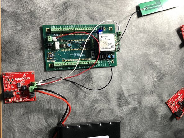

  11. Board Configuration for Nodes - RTWS Branko Kerkez, Plug in the Battery: crwdns2935265:012crwdnd2935265:01crwdnd2935265:02crwdne2935265:0 Board Configuration for Nodes - RTWS Branko Kerkez, Plug in the Battery: crwdns2935265:012crwdnd2935265:02crwdnd2935265:02crwdne2935265:0
    • Insert the battery as seen in the first photo
    • The final configuration can be seen in the second photo
  12. Board Configuration for Nodes - RTWS Branko Kerkez, Monitor the Configuration: crwdns2935265:013crwdnd2935265:01crwdnd2935265:01crwdne2935265:0
    • Log into the same Twilio page as before and periodically monitor the connectivity
    • The connectivity should display a similar pattern to the first photo, and the packets downloaded and uploaded should be nonzero
    • Record the status of the connectivity in the google sheet you created in Step 4
