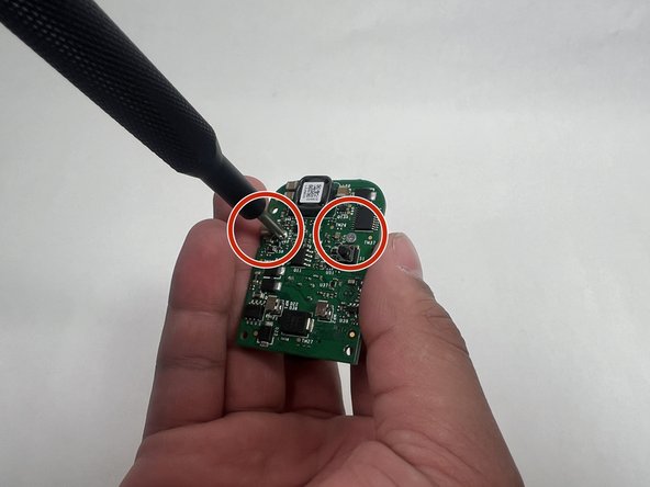

  5. Blink Video Doorbell Lens Replacement, Lens: crwdns2935265:05crwdnd2935265:01crwdnd2935265:03crwdne2935265:0 Blink Video Doorbell Lens Replacement, Lens: crwdns2935265:05crwdnd2935265:02crwdnd2935265:03crwdne2935265:0 Blink Video Doorbell Lens Replacement, Lens: crwdns2935265:05crwdnd2935265:03crwdnd2935265:03crwdne2935265:0
    • Remove the three 6 mm screws from the upper part of the motherboard using a JIS #1 screwdriver.
    • Use an opening tool to release the motherboard from the device.
  6. Blink Video Doorbell Lens Replacement: crwdns2935265:06crwdnd2935265:01crwdnd2935265:02crwdne2935265:0 Blink Video Doorbell Lens Replacement: crwdns2935265:06crwdnd2935265:02crwdnd2935265:02crwdne2935265:0
    • Carefully lift up the small daughterboard which contains the camera.
    • Remove two 5 mm screws from the back of the camera using a Phillips #0 screwdriver.
  7. Blink Video Doorbell Lens Replacement: crwdns2935265:07crwdnd2935265:01crwdnd2935265:02crwdne2935265:0 Blink Video Doorbell Lens Replacement: crwdns2935265:07crwdnd2935265:02crwdnd2935265:02crwdne2935265:0
    • Use tweezers to detach the white connector from the adapter on the motherboard.
    • Remove the lens.
