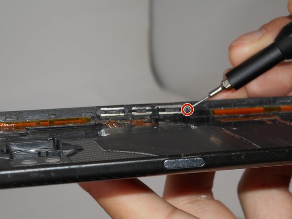

  4. Blackberry PRIV Volume Buttons Replacement, Volume Buttons: crwdns2935265:04crwdnd2935265:01crwdnd2935265:03crwdne2935265:0 Blackberry PRIV Volume Buttons Replacement, Volume Buttons: crwdns2935265:04crwdnd2935265:02crwdnd2935265:03crwdne2935265:0 Blackberry PRIV Volume Buttons Replacement, Volume Buttons: crwdns2935265:04crwdnd2935265:03crwdnd2935265:03crwdne2935265:0
    • Locate the volume buttons which are on the right side of inside the rear casing.
    • Using your SIM eject tool push the volume button out of plastic prong.

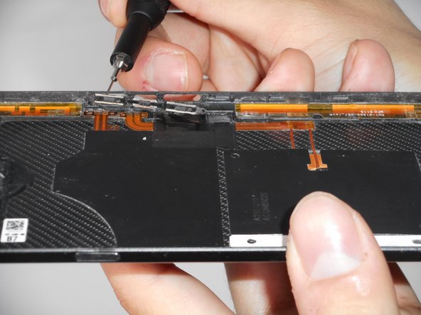

    • Push the other side of the volume button.
