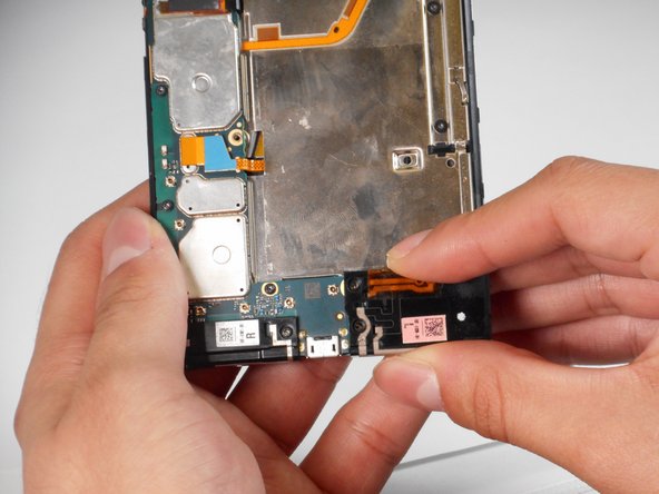

  7. Blackberry PRIV Rear-Facing Camera Replacement, Rear-Facing Camera: crwdns2935265:07crwdnd2935265:01crwdnd2935265:01crwdne2935265:0
    • Remove the seven 3.3 mm T4 Torx screws that secure the motherboard.

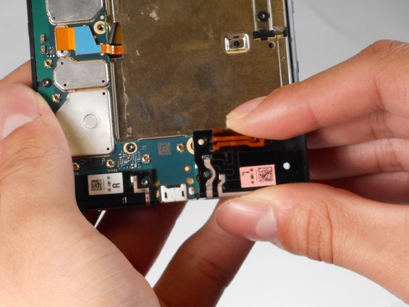

  8. Blackberry PRIV Rear-Facing Camera Replacement: crwdns2935265:08crwdnd2935265:01crwdnd2935265:03crwdne2935265:0 Blackberry PRIV Rear-Facing Camera Replacement: crwdns2935265:08crwdnd2935265:02crwdnd2935265:03crwdne2935265:0 Blackberry PRIV Rear-Facing Camera Replacement: crwdns2935265:08crwdnd2935265:03crwdnd2935265:03crwdne2935265:0
    • Remove the two 3.3 mm T4 Torx screws that secure the speaker casing.
    • Lift and remove the speaker casing.

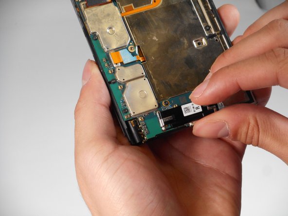

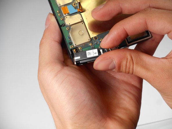

  9. Blackberry PRIV Rear-Facing Camera Replacement: crwdns2935265:09crwdnd2935265:01crwdnd2935265:03crwdne2935265:0 Blackberry PRIV Rear-Facing Camera Replacement: crwdns2935265:09crwdnd2935265:02crwdnd2935265:03crwdne2935265:0 Blackberry PRIV Rear-Facing Camera Replacement: crwdns2935265:09crwdnd2935265:03crwdnd2935265:03crwdne2935265:0
    • Remove the one 3.3 mm T4 Torx screw that secures the headphone jack.
    • Lift and remove the headphone jack.
  10. Blackberry PRIV Rear-Facing Camera Replacement: crwdns2935265:010crwdnd2935265:01crwdnd2935265:03crwdne2935265:0 Blackberry PRIV Rear-Facing Camera Replacement: crwdns2935265:010crwdnd2935265:02crwdnd2935265:03crwdne2935265:0 Blackberry PRIV Rear-Facing Camera Replacement: crwdns2935265:010crwdnd2935265:03crwdnd2935265:03crwdne2935265:0

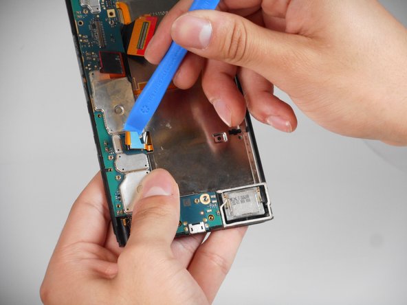

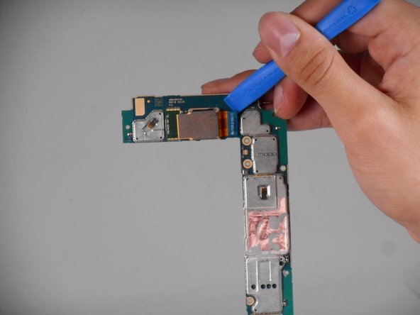

    • Use an opening tool to lift and disconnect the three press connectors.

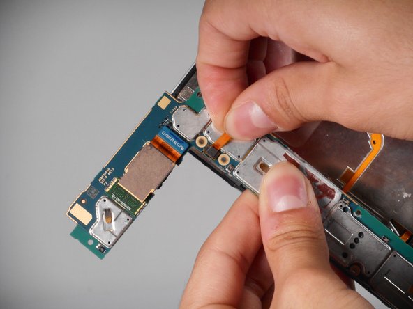

  11. Blackberry PRIV Rear-Facing Camera Replacement: crwdns2935265:011crwdnd2935265:01crwdnd2935265:03crwdne2935265:0 Blackberry PRIV Rear-Facing Camera Replacement: crwdns2935265:011crwdnd2935265:02crwdnd2935265:03crwdne2935265:0 Blackberry PRIV Rear-Facing Camera Replacement: crwdns2935265:011crwdnd2935265:03crwdnd2935265:03crwdne2935265:0

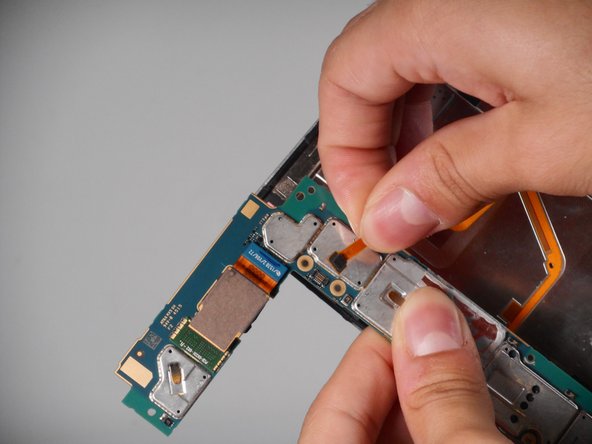

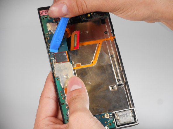

    • Lift the motherboard from the device.
    • Do not pull the circuit board with too much force as there is a strip connected under.
    • Using two fingers, pinch the on the strip as close to the connector as possible.
    • Lift and disconnect the connector from the motherboard.

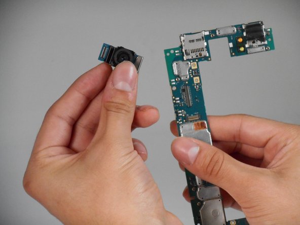

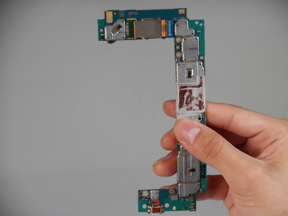

  12. Blackberry PRIV Rear-Facing Camera Replacement: crwdns2935265:012crwdnd2935265:01crwdnd2935265:03crwdne2935265:0 Blackberry PRIV Rear-Facing Camera Replacement: crwdns2935265:012crwdnd2935265:02crwdnd2935265:03crwdne2935265:0 Blackberry PRIV Rear-Facing Camera Replacement: crwdns2935265:012crwdnd2935265:03crwdnd2935265:03crwdne2935265:0
    • Turn the motherboard around.
    • Use an opening tool to lift and disconnect the camera connector.
  13. Blackberry PRIV Rear-Facing Camera Replacement: crwdns2935265:013crwdnd2935265:01crwdnd2935265:02crwdne2935265:0 Blackberry PRIV Rear-Facing Camera Replacement: crwdns2935265:013crwdnd2935265:02crwdnd2935265:02crwdne2935265:0
    • Lift and remove the camera from the circuit board.
