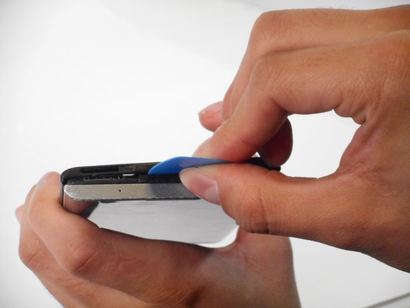

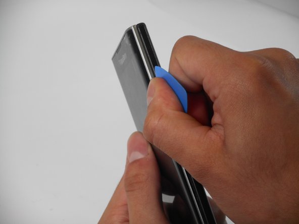

      • Insert an opening pick in the seam between the rear casing and chassis. Apply downward pressure to pry the casing upward.
      • Follow this procedure for only the right, left, and top side of the casing.
