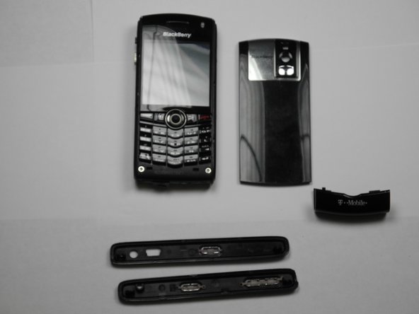

  1. BlackBerry Pearl 8100 Disassembly, Rear Cover: crwdns2935265:01crwdnd2935265:01crwdnd2935265:01crwdne2935265:0
    • Push the button indicated by the yellow marker to remove the rear cover.
    • Remove the battery (not pictured).
  2. BlackBerry Pearl 8100 Disassembly, Screws underneath the rear cover: crwdns2935265:02crwdnd2935265:01crwdnd2935265:01crwdne2935265:0
    • Use a T6 Torx screwdriver to remove the two screws indicated by the yellow markers.
  3. BlackBerry Pearl 8100 Disassembly, Bottom Cover: crwdns2935265:03crwdnd2935265:01crwdnd2935265:02crwdne2935265:0 BlackBerry Pearl 8100 Disassembly, Bottom Cover: crwdns2935265:03crwdnd2935265:02crwdnd2935265:02crwdne2935265:0
    • Use the plastic opening tool to loosen the bottom cover, and then remove the bottom cover from the cellphone.
  4. BlackBerry Pearl 8100 Disassembly, Side Cover: crwdns2935265:04crwdnd2935265:01crwdnd2935265:02crwdne2935265:0 BlackBerry Pearl 8100 Disassembly, Side Cover: crwdns2935265:04crwdnd2935265:02crwdnd2935265:02crwdne2935265:0
    • Use the plastic opening tool to remove the side covers.
    • The side covers are attached to the cell phone with small plastic snaps. These snaps can be bent or broken easily.
  5. BlackBerry Pearl 8100 Disassembly, More screws: crwdns2935265:05crwdnd2935265:01crwdnd2935265:01crwdne2935265:0
    • With the bottom and side covers removed, the two screws indicated by yellow markers will be visible.
    • Use the T6 Torx screwdriver to remove the screws.
  6. BlackBerry Pearl 8100 Disassembly, Frame: crwdns2935265:06crwdnd2935265:01crwdnd2935265:02crwdne2935265:0 BlackBerry Pearl 8100 Disassembly, Frame: crwdns2935265:06crwdnd2935265:02crwdnd2935265:02crwdne2935265:0
    • With the screws removed, the frame can be detached.
  7. BlackBerry Pearl 8100 Disassembly, Logic Board: crwdns2935265:07crwdnd2935265:01crwdnd2935265:02crwdne2935265:0 BlackBerry Pearl 8100 Disassembly, Logic Board: crwdns2935265:07crwdnd2935265:02crwdnd2935265:02crwdne2935265:0
    • Use the plastic opening tool to separate the motherboard from the front cover.
    • While removing the motherboard, the button that opens the rear cover may come loose along with a small spring. Do not lose these.
  8. BlackBerry Pearl 8100 Disassembly, Keypad and Trackball: crwdns2935265:08crwdnd2935265:01crwdnd2935265:02crwdne2935265:0 BlackBerry Pearl 8100 Disassembly, Keypad and Trackball: crwdns2935265:08crwdnd2935265:02crwdnd2935265:02crwdne2935265:0
    • Separate the keypad (first picture) and trackball (second picture) from the front cover.
    • Lift the piece of plastic that overlays the trackball (second picture). The trackball should then come loose.
    • Keep the trackball intact. The trackball has extremely small magnetic bolts underneath that are difficult to reassemble.
  9. BlackBerry Pearl 8100 Disassembly, Complete: crwdns2935265:09crwdnd2935265:01crwdnd2935265:01crwdne2935265:0
    • These are all the parts of the BlackBerry Pearl 8100 completely disassembled. From left to right, the parts are as follows: rear cover, front cover, motherboard, side covers, trackball, keypad, bottom cover, and frame.
