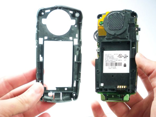

  9. BlackBerry 7130e Keypad Replacement: crwdns2935265:09crwdnd2935265:01crwdnd2935265:02crwdne2935265:0 BlackBerry 7130e Keypad Replacement: crwdns2935265:09crwdnd2935265:02crwdnd2935265:02crwdne2935265:0
    • You should now be able to easily separate the phone into two pieces.
    • The battery prong may fall out when the separation occurs, just don't loose it!
