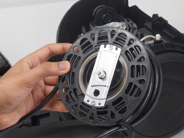

  6. Bissell Zing 2156A Cord Retraction Mechanism Replacement, Cord Retraction Mechanism: crwdns2935265:06crwdnd2935265:01crwdnd2935265:02crwdne2935265:0 Bissell Zing 2156A Cord Retraction Mechanism Replacement, Cord Retraction Mechanism: crwdns2935265:06crwdnd2935265:02crwdnd2935265:02crwdne2935265:0
    • The spring only needs replacing if the arm is loose!
    • Remove the 20mm spring and replace it with a working spring.
    • Press down the spring, angle it away from the lever arm, and then pull out the spring.

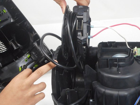

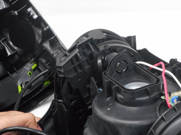

  7. Bissell Zing 2156A Cord Retraction Mechanism Replacement: crwdns2935265:07crwdnd2935265:01crwdnd2935265:02crwdne2935265:0 Bissell Zing 2156A Cord Retraction Mechanism Replacement: crwdns2935265:07crwdnd2935265:02crwdnd2935265:02crwdne2935265:0
    • Pull on the body to let the mechanism's pin move.
    • Pull the mechanism out.
    • Be careful of the red and black wires, as they can get snagged on the casing!
  8. Bissell Zing 2156A Cord Retraction Mechanism Replacement: crwdns2935265:08crwdnd2935265:01crwdnd2935265:02crwdne2935265:0 Bissell Zing 2156A Cord Retraction Mechanism Replacement: crwdns2935265:08crwdnd2935265:02crwdnd2935265:02crwdne2935265:0
    • Tension the part by holding the stationary mechanism and rotating the wheel counterclockwise.
    • When the retraction mechanism is tensioned, it should be wound up, not flat.
    • Fully retract the cord before reinserting it, so you keep every bit of tension available.

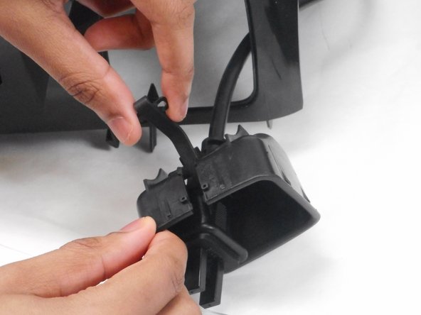

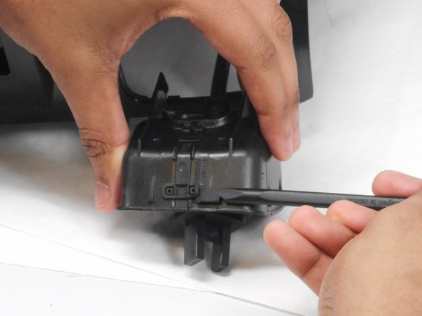

  9. Bissell Zing 2156A Cord Retraction Mechanism Replacement: crwdns2935265:09crwdnd2935265:01crwdnd2935265:03crwdne2935265:0 Bissell Zing 2156A Cord Retraction Mechanism Replacement: crwdns2935265:09crwdnd2935265:02crwdnd2935265:03crwdne2935265:0 Bissell Zing 2156A Cord Retraction Mechanism Replacement: crwdns2935265:09crwdnd2935265:03crwdnd2935265:03crwdne2935265:0
    • This step is only needed if fully removing the cord retraction mechanism. If the cord doesn't need to come out, this cowling can stay untouched.
    • Use a spudger to pop the clips out of the cowling's outside face. Pull it out.
    • Remove the holders on the inside of the cowling so the bracket can be pivoted out.
    • Separate the cowling and bracket and remove the cord.
    • Keep track of the small bracket; if it's lost the part won't go in right.
