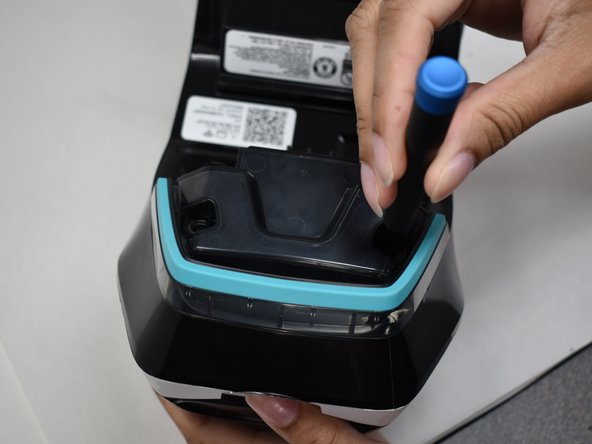

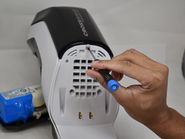

    • Remove the four 16 mm Phillips #2 screws at the back of the vacuum and below the clean water tank.

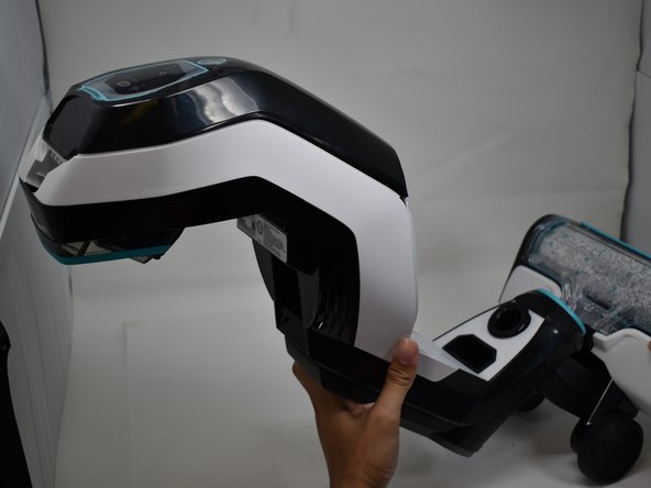

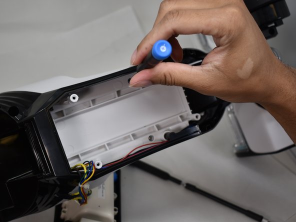

    • Pull the battery assembly away from the main body.
    • There are still wires connecting the battery assembly to the main body. Do not use force to completely separate the two objects.

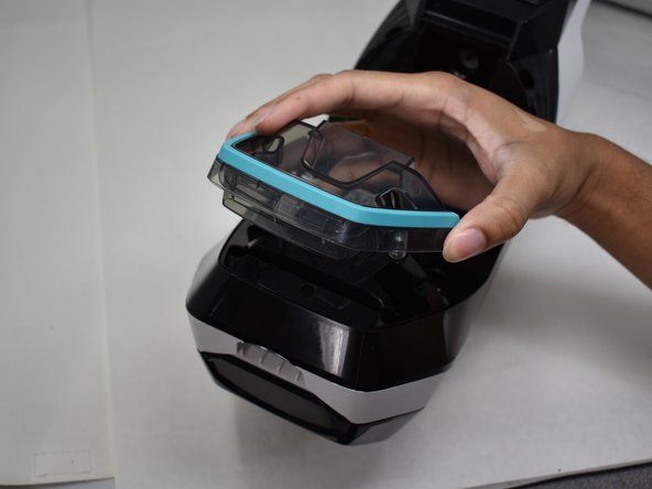

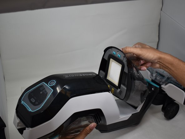

    • Remove the clean and dirty water tanks.
    • Removing the tanks gives access to all of the screw holes required to disassemble the vacuum housing.

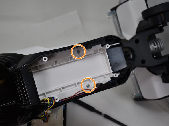

    • Remove the two 14 mm silver screws located underneath the battery using a Phillips #1 screwdriver.

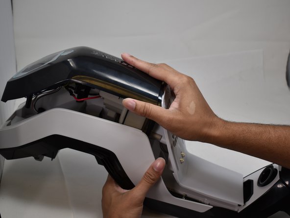

    • Remove the two front pieces of plastic from the main body of the vacuum.
    • There are many wires still connected from the main body to these front panels. Use caution when separating the plastic as to not break the wiring.
  9. Bissell CrossWave Cordless Max 2554A Motor Replacement: crwdns2935265:09crwdnd2935265:01crwdnd2935265:02crwdne2935265:0 Bissell CrossWave Cordless Max 2554A Motor Replacement: crwdns2935265:09crwdnd2935265:02crwdnd2935265:02crwdne2935265:0

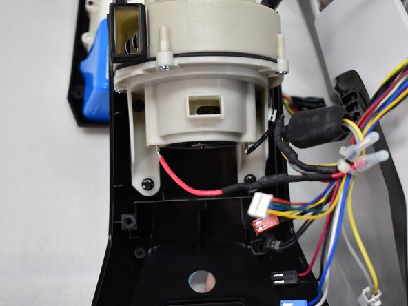

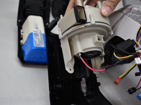

    • The panel can be flipped over to reveal the motor when separated from the main body.
  10. Bissell CrossWave Cordless Max 2554A Motor Replacement: crwdns2935265:010crwdnd2935265:01crwdnd2935265:02crwdne2935265:0 Bissell CrossWave Cordless Max 2554A Motor Replacement: crwdns2935265:010crwdnd2935265:02crwdnd2935265:02crwdne2935265:0
    • Remove the four 14 mm Phillips #1 screws that hold the motor to the front panel of the vacuum.
  11. Bissell CrossWave Cordless Max 2554A Motor Replacement: crwdns2935265:011crwdnd2935265:01crwdnd2935265:03crwdne2935265:0 Bissell CrossWave Cordless Max 2554A Motor Replacement: crwdns2935265:011crwdnd2935265:02crwdnd2935265:03crwdne2935265:0 Bissell CrossWave Cordless Max 2554A Motor Replacement: crwdns2935265:011crwdnd2935265:03crwdnd2935265:03crwdne2935265:0

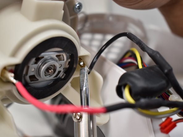

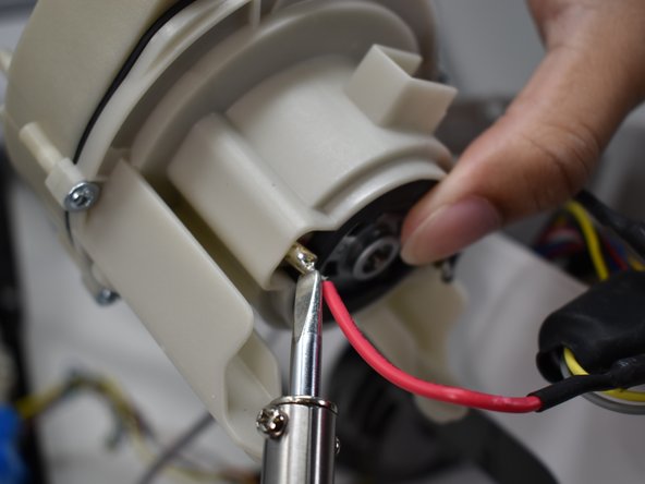

    • The two wire connections can be desoldered to completely free the motor from the rest of the vacuum.
    • Be extremely careful while soldering or desoldering these connections, as the soldering iron can get very hot.
