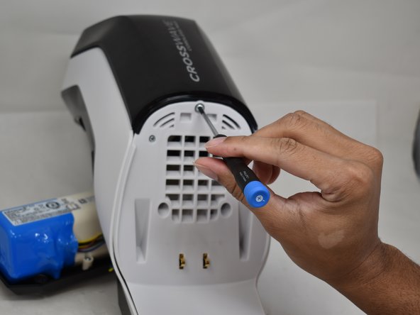

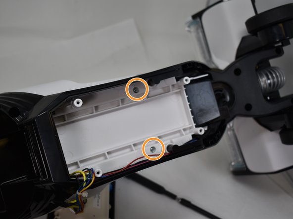

    • Remove the four 16 mm Phillips #2 screws at the back of the vacuum and below the clean water tank.
  2. Bissell CrossWave Cordless Max 2554A Motherboard and Display Replacement: crwdns2935265:02crwdnd2935265:01crwdnd2935265:02crwdne2935265:0 Bissell CrossWave Cordless Max 2554A Motherboard and Display Replacement: crwdns2935265:02crwdnd2935265:02crwdnd2935265:02crwdne2935265:0
    • Pull the battery assembly away from the main body.
    • There are still wires connecting the battery assembly to the main body. Do not use force to completely separate the two objects.

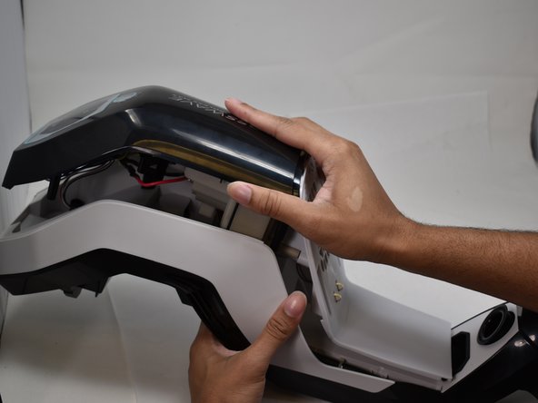

  3. Bissell CrossWave Cordless Max 2554A Motherboard and Display Replacement: crwdns2935265:03crwdnd2935265:01crwdnd2935265:02crwdne2935265:0 Bissell CrossWave Cordless Max 2554A Motherboard and Display Replacement: crwdns2935265:03crwdnd2935265:02crwdnd2935265:02crwdne2935265:0
    • Detach the wires holding the battery assembly to the main body by pressing down on the clip holding the connector together.

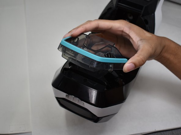

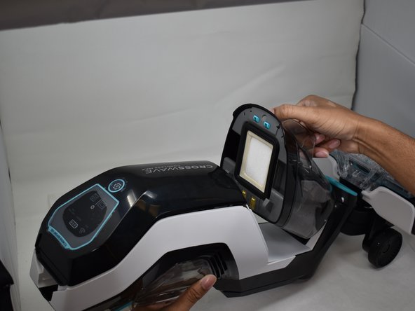

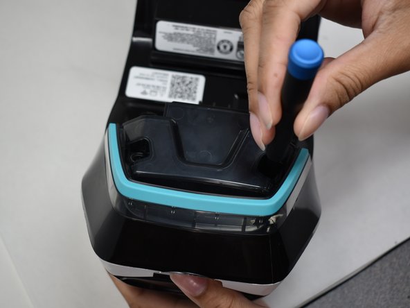

    • Remove the clean and dirty water tanks.
    • Removing the tanks gives access to all of the screw holes required to disassemble the vacuum housing.

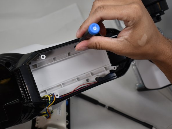

    • Remove the six 14 mm Phillips #1 screws that are located where the clean water tank once was.
    • Remove the two 14 mm silver screws located underneath the battery using a Phillips #1 screwdriver.

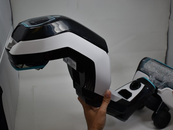

  8. Bissell CrossWave Cordless Max 2554A Motherboard and Display Replacement: crwdns2935265:08crwdnd2935265:01crwdnd2935265:02crwdne2935265:0 Bissell CrossWave Cordless Max 2554A Motherboard and Display Replacement: crwdns2935265:08crwdnd2935265:02crwdnd2935265:02crwdne2935265:0
    • Remove the two front pieces of plastic from the main body of the vacuum.
    • There are many wires still connected from the main body to these front panels. Use caution when separating the plastic as to not break the wiring.

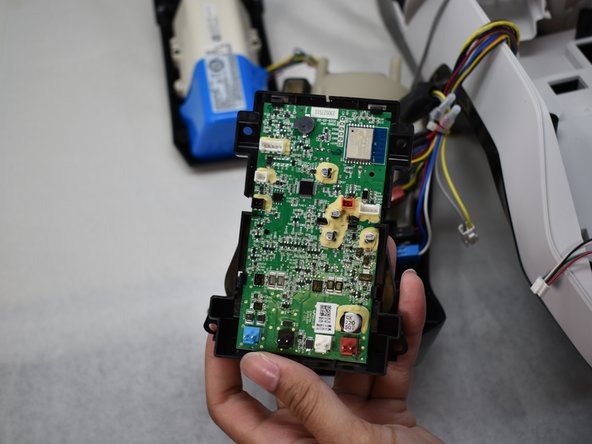

  9. Bissell CrossWave Cordless Max 2554A Motherboard and Display Replacement: crwdns2935265:09crwdnd2935265:01crwdnd2935265:02crwdne2935265:0 Bissell CrossWave Cordless Max 2554A Motherboard and Display Replacement: crwdns2935265:09crwdnd2935265:02crwdnd2935265:02crwdne2935265:0

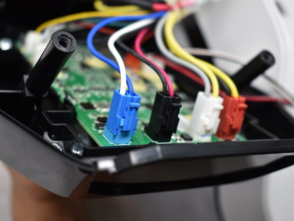

    • The panel can be flipped over to reveal the motherboard and display.
    • Unplug the nine wire connectors attached to the motherboard of the vacuum.

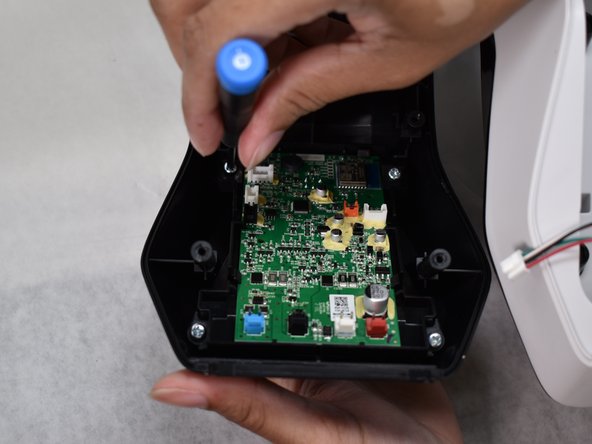

  10. Bissell CrossWave Cordless Max 2554A Motherboard and Display Replacement: crwdns2935265:010crwdnd2935265:01crwdnd2935265:03crwdne2935265:0 Bissell CrossWave Cordless Max 2554A Motherboard and Display Replacement: crwdns2935265:010crwdnd2935265:02crwdnd2935265:03crwdne2935265:0 Bissell CrossWave Cordless Max 2554A Motherboard and Display Replacement: crwdns2935265:010crwdnd2935265:03crwdnd2935265:03crwdne2935265:0
    • Remove the four 12.3 mm Phillips #1 screws attaching the motherboard to the front plastic.
    • The motherboard can be separated from the front plastic and exchanged for a new one.
