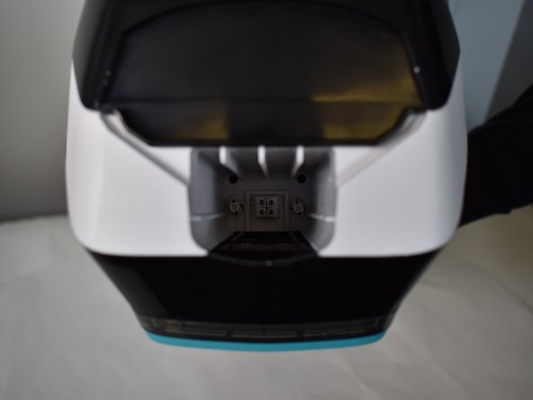

    • Start by facing the vacuum away from you so that you are looking at the back side of the clean water tank.
  2. Bissell CrossWave Cordless Max 2554A Handle Replacement: crwdns2935265:02crwdnd2935265:01crwdnd2935265:03crwdne2935265:0 Bissell CrossWave Cordless Max 2554A Handle Replacement: crwdns2935265:02crwdnd2935265:02crwdnd2935265:03crwdne2935265:0 Bissell CrossWave Cordless Max 2554A Handle Replacement: crwdns2935265:02crwdnd2935265:03crwdnd2935265:03crwdne2935265:0
    • The handle release mechanism is a small hole directly above the clean water tank and below the handle.
    • Using the pointed end of a spudger, press the mechanism to release the handle.
    • You might need to shimmy it a bit, as pressing too hard may prevent the handle from releasing.
  3. Bissell CrossWave Cordless Max 2554A Handle Replacement: crwdns2935265:03crwdnd2935265:01crwdnd2935265:02crwdne2935265:0 Bissell CrossWave Cordless Max 2554A Handle Replacement: crwdns2935265:03crwdnd2935265:02crwdnd2935265:02crwdne2935265:0
    • Remove the handle from the vacuum.
To reassemble your device, reinsert the handle back into the main body of the vacuum, listening for an audible click.
