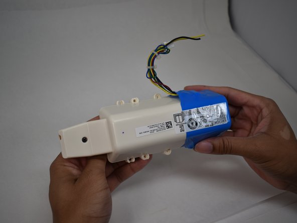

    • Remove the four 16 mm Phillips #2 screws at the back of the vacuum and below the clean water tank.

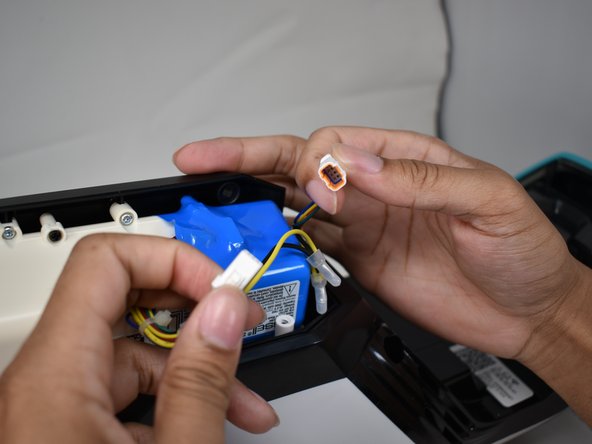

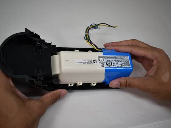

    • Pull the battery assembly away from the main body.
    • There are still wires connecting the battery assembly to the main body. Do not use force to completely separate the two objects.
  3. Bissell CrossWave Cordless Max 2554A Battery Replacement: crwdns2935265:03crwdnd2935265:01crwdnd2935265:02crwdne2935265:0 Bissell CrossWave Cordless Max 2554A Battery Replacement: crwdns2935265:03crwdnd2935265:02crwdnd2935265:02crwdne2935265:0
    • Detach the wires holding the battery assembly to the main body by pressing down on the clip holding the connector together.

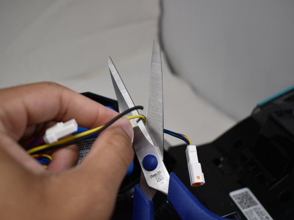

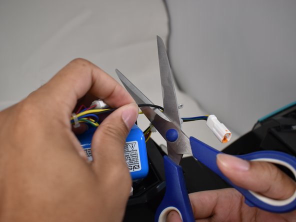

  4. Bissell CrossWave Cordless Max 2554A Battery Replacement, Battery: crwdns2935265:04crwdnd2935265:01crwdnd2935265:03crwdne2935265:0 Bissell CrossWave Cordless Max 2554A Battery Replacement, Battery: crwdns2935265:04crwdnd2935265:02crwdnd2935265:03crwdne2935265:0 Bissell CrossWave Cordless Max 2554A Battery Replacement, Battery: crwdns2935265:04crwdnd2935265:03crwdnd2935265:03crwdne2935265:0
    • This step involves cutting live battery wires. If possible, use insulated cutting equipment and do not touch the exposed wires. Use wire cutters instead of the scissors shown in the images.
    • Cut the remaining yellow and black wires to detach the battery from the main body.
    • These wires do have a device connecting them to the wires on the main body, but these devices are unable to be removed without specialized equipment.

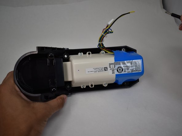

  6. Bissell CrossWave Cordless Max 2554A Battery Replacement: crwdns2935265:06crwdnd2935265:01crwdnd2935265:02crwdne2935265:0 Bissell CrossWave Cordless Max 2554A Battery Replacement: crwdns2935265:06crwdnd2935265:02crwdnd2935265:02crwdne2935265:0
    • Remove the four silver 13.5 mm Phillips #2 screws.
    • Do not remove the two visible black screws. They hold the two halves of the battery case together and should not come apart.
