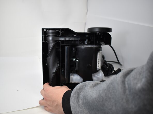

    • With the vacuum in an upright position, press the latch on the rear of the spine to remove the handle from the vacuum.
  2. Bissell CleanView Compact 3508 Brush Roll Replacement: crwdns2935265:02crwdnd2935265:01crwdnd2935265:02crwdne2935265:0 Bissell CleanView Compact 3508 Brush Roll Replacement: crwdns2935265:02crwdnd2935265:02crwdnd2935265:02crwdne2935265:0
    • Use a Phillips #2 screwdriver to remove the five 20.7 mm screws on the underside of the brush roll cover.
  3. Bissell CleanView Compact 3508 Brush Roll Replacement: crwdns2935265:03crwdnd2935265:01crwdnd2935265:03crwdne2935265:0 Bissell CleanView Compact 3508 Brush Roll Replacement: crwdns2935265:03crwdnd2935265:02crwdnd2935265:03crwdne2935265:0 Bissell CleanView Compact 3508 Brush Roll Replacement: crwdns2935265:03crwdnd2935265:03crwdnd2935265:03crwdne2935265:0
    • Use a pry tool or flathead screwdriver to disengage the two retaining clips securing the brush roll cover.
    • Remove the brush roll cover.

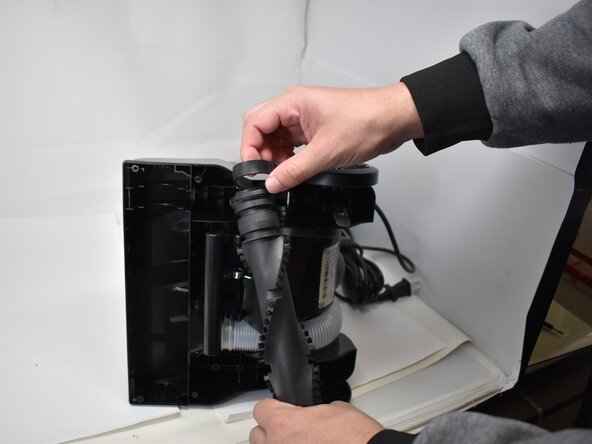

  4. Bissell CleanView Compact 3508 Brush Roll Replacement, Brush Roll: crwdns2935265:04crwdnd2935265:01crwdnd2935265:03crwdne2935265:0 Bissell CleanView Compact 3508 Brush Roll Replacement, Brush Roll: crwdns2935265:04crwdnd2935265:02crwdnd2935265:03crwdne2935265:0 Bissell CleanView Compact 3508 Brush Roll Replacement, Brush Roll: crwdns2935265:04crwdnd2935265:03crwdnd2935265:03crwdne2935265:0
    • Pull the roller brush out of the cavity.
    • Remove the belt from around the brush roller.
