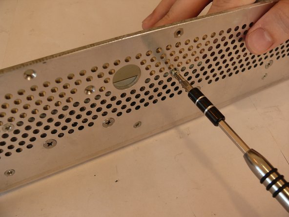

  3. Behringer Eurolive B212D Audio Amplification PCB Replacement, Electronics Box: crwdns2935265:03crwdnd2935265:01crwdnd2935265:03crwdne2935265:0 Behringer Eurolive B212D Audio Amplification PCB Replacement, Electronics Box: crwdns2935265:03crwdnd2935265:02crwdnd2935265:03crwdne2935265:0 Behringer Eurolive B212D Audio Amplification PCB Replacement, Electronics Box: crwdns2935265:03crwdnd2935265:03crwdnd2935265:03crwdne2935265:0
    • There are two silver, 6 mm-long machine screws with two 1/8" inner-diameter washers on the exterior of the metal electronics box; remove these first using a #2 philips screwdriver.
    • There are five of the same type of machine screw (silver, 6 mm-long) remaining around the metal electronics box's exterior; remove these as well.
    • You should have removed a total of 7 machine screws and 2 washers.
    • The reason for removing the two screws with the two washers first (or replacing them last when reassembling) is that their holes are actually slots. They are designed as slots to accommodate slop in the assembly, and if unscrewed out of order, you may have difficulty while removing - or possibly even damage - the other five screws.

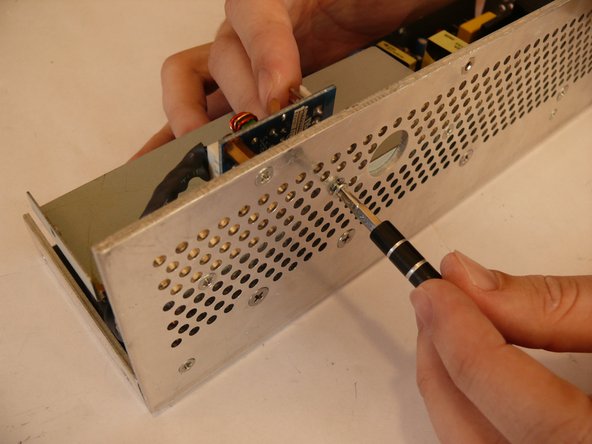

  4. Behringer Eurolive B212D Audio Amplification PCB Replacement: crwdns2935265:04crwdnd2935265:01crwdnd2935265:01crwdne2935265:0
    • Remove the portion of the metal housing that you freed with the 7 screws in the previous step.

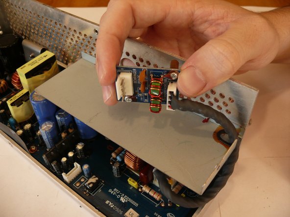

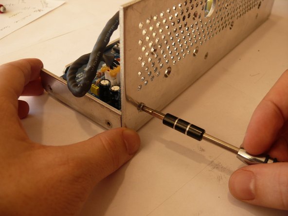

  6. Behringer Eurolive B212D Audio Amplification PCB Replacement, Power & Control Panel: crwdns2935265:06crwdnd2935265:01crwdnd2935265:02crwdne2935265:0 Behringer Eurolive B212D Audio Amplification PCB Replacement, Power & Control Panel: crwdns2935265:06crwdnd2935265:02crwdnd2935265:02crwdne2935265:0
    • Remove the 4, 7/32" long machine screws with a #2 phillips head screwdriver.
  7. Behringer Eurolive B212D Audio Amplification PCB Replacement: crwdns2935265:07crwdnd2935265:01crwdnd2935265:02crwdne2935265:0 Behringer Eurolive B212D Audio Amplification PCB Replacement: crwdns2935265:07crwdnd2935265:02crwdnd2935265:02crwdne2935265:0
    • Caution: The circuit board contains many capacitors that could cause serious injury if touched. If possible, use a capacitor discharge probe to safely rid the capacitors of dangerous charges.
    • Rotate the back panel so you can view the interior; note the three wires attached.
    • Remove the wires to you can fully remove the back panel.
  8. Behringer Eurolive B212D Audio Amplification PCB Replacement, Audio Amplification PCB: crwdns2935265:08crwdnd2935265:01crwdnd2935265:03crwdne2935265:0 Behringer Eurolive B212D Audio Amplification PCB Replacement, Audio Amplification PCB: crwdns2935265:08crwdnd2935265:02crwdnd2935265:03crwdne2935265:0 Behringer Eurolive B212D Audio Amplification PCB Replacement, Audio Amplification PCB: crwdns2935265:08crwdnd2935265:03crwdnd2935265:03crwdne2935265:0
    • Remove the 2 indicated flat head machine screws indicated using a #2 phillips head screwdriver.
    • The small PCB could be removed for replacement at this point, but you can also just leave it attached to the audio amplification PCB as you remove other parts.

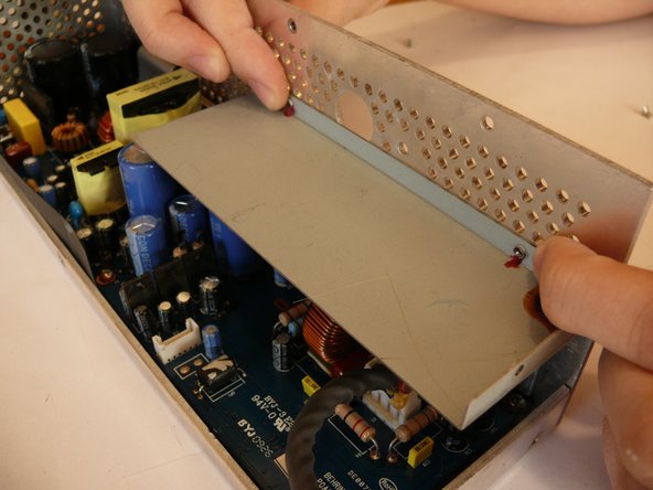

  9. Behringer Eurolive B212D Audio Amplification PCB Replacement: crwdns2935265:09crwdnd2935265:01crwdnd2935265:03crwdne2935265:0 Behringer Eurolive B212D Audio Amplification PCB Replacement: crwdns2935265:09crwdnd2935265:02crwdnd2935265:03crwdne2935265:0 Behringer Eurolive B212D Audio Amplification PCB Replacement: crwdns2935265:09crwdnd2935265:03crwdnd2935265:03crwdne2935265:0
    • Remove the 2 indicated flat head machine screws using a #2 phillips head screwdriver.
    • Remove and set aside the metal panel that was separating the small PCB from the audio amplification PCB.

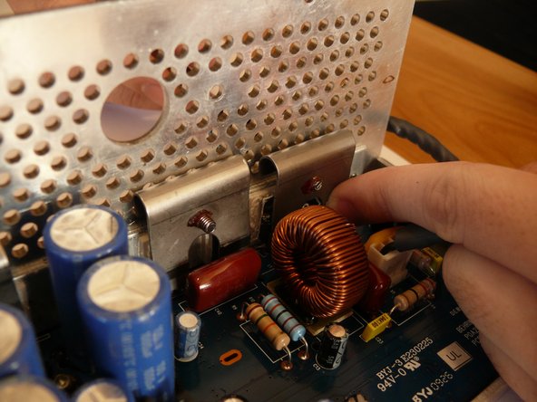

    • Note the 4 large flat head machine screws which hold the clamps on the opposite side; remove them with a #2 phillips head screwdriver.
    • The clamps are meant to hold the audio amplification PCB's IC's to the common heat sink; they ensure proper contact between the heat sink and the IC's through the ceramic thermal paste.

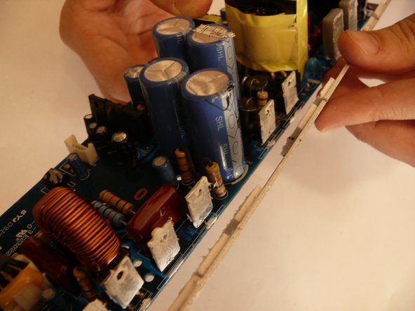

  13. Behringer Eurolive B212D Audio Amplification PCB Replacement: crwdns2935265:013crwdnd2935265:01crwdnd2935265:02crwdne2935265:0 Behringer Eurolive B212D Audio Amplification PCB Replacement: crwdns2935265:013crwdnd2935265:02crwdnd2935265:02crwdne2935265:0
    • Remove the audio amplification PCB from the metal electronics box.
    • If you haven't already, remove the heat sink from the IC's, being careful not to get any of the ceramic thermal paste on your skin, as it is difficult to remove, even with soap.
