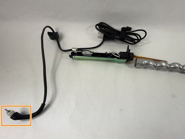

    • Remove all four of the 4 mm Phillips screws on either side of the casing.
  2. Bed Head Curlipops Power Cord Replacement: crwdns2935265:02crwdnd2935265:01crwdnd2935265:01crwdne2935265:0
    • Using a opening tool, insert it along the seam of where both halves of the casing meet, and slowly pry the left side of the casing from the right.
    • Gently pull back the right side of the casing from the center molding.
  3. Bed Head Curlipops Power Cord Replacement, Power Cord: crwdns2935265:03crwdnd2935265:01crwdnd2935265:02crwdne2935265:0 Bed Head Curlipops Power Cord Replacement, Power Cord: crwdns2935265:03crwdnd2935265:02crwdnd2935265:02crwdne2935265:0
    • Apply gentle pressure on connector shown at end of handle.
    • Using the locking tab on the electrical connector, press and hold while gently separating both pieces.
    • Gently pull back on black end cap of plug shown until the cord releases from the casing.
