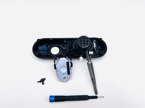

  8. Beats Pill 2024 Tweeter Replacement, Tweeter: crwdns2935265:08crwdnd2935265:01crwdnd2935265:02crwdne2935265:0 Beats Pill 2024 Tweeter Replacement, Tweeter: crwdns2935265:08crwdnd2935265:02crwdnd2935265:02crwdne2935265:0
    • Use a Phillips #1 screwdriver to remove the four 12.4 mm Phillips screws that secure the tweeter.
    • Use a spudger to pry the tweeter away from the driver assembly.
    • This might require some force as there is adhesive securing the tweeter to the driver assembly.
    • Apply adhesive to the replacement tweeter before installation.
