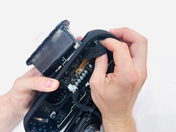

    • Remove the twelve 8.6 mm T5 Torx screws that secure the battery cover.
  11. Beats Pill 2024 Motherboard Replacement: crwdns2935265:011crwdnd2935265:01crwdnd2935265:03crwdne2935265:0 Beats Pill 2024 Motherboard Replacement: crwdns2935265:011crwdnd2935265:02crwdnd2935265:03crwdne2935265:0 Beats Pill 2024 Motherboard Replacement: crwdns2935265:011crwdnd2935265:03crwdnd2935265:03crwdne2935265:0
    • To remove the battery, pull on the tape material wrapped around the middle of it.
  12. Beats Pill 2024 Motherboard Replacement, Motherboard: crwdns2935265:012crwdnd2935265:01crwdnd2935265:01crwdne2935265:0
    • Remove the two T5 Torx screws that secure the battery compartment.
  13. Beats Pill 2024 Motherboard Replacement: crwdns2935265:013crwdnd2935265:01crwdnd2935265:03crwdne2935265:0 Beats Pill 2024 Motherboard Replacement: crwdns2935265:013crwdnd2935265:02crwdnd2935265:03crwdne2935265:0 Beats Pill 2024 Motherboard Replacement: crwdns2935265:013crwdnd2935265:03crwdnd2935265:03crwdne2935265:0
    • Use a spudger to dislodge the battery compartment from its housing.
    • Before complete removal, disconnect the battery compartment motherboard connector.
  14. Beats Pill 2024 Motherboard Replacement: crwdns2935265:014crwdnd2935265:01crwdnd2935265:01crwdne2935265:0
    • Lift the black ZIF locking tab in the top-right corner of the motherboard.
    • Disconnect the ribbon cable.
  15. Beats Pill 2024 Motherboard Replacement: crwdns2935265:015crwdnd2935265:01crwdnd2935265:01crwdne2935265:0
    • Remove the seven 12.4 mm Phillips screws securing the motherboard.
  16. Beats Pill 2024 Motherboard Replacement: crwdns2935265:016crwdnd2935265:01crwdnd2935265:01crwdne2935265:0
    • Gently lift the motherboard perpendicular to the housing, with care not to strain the connected cable.
    • Disengage the ZIF locking flap and disconnect the ribbon cable.
  17. Beats Pill 2024 Motherboard Replacement: crwdns2935265:017crwdnd2935265:01crwdnd2935265:01crwdne2935265:0
    • Remove the motherboard.
