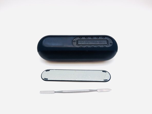

  3. Beats Pill 2024 Battery Daughterboard Replacement: crwdns2935265:03crwdnd2935265:01crwdnd2935265:02crwdne2935265:0 Beats Pill 2024 Battery Daughterboard Replacement: crwdns2935265:03crwdnd2935265:02crwdnd2935265:02crwdne2935265:0
    • Use a spudger to remove the six stickers on the face of the driver assembly.
    • Place the stickers on a clean surface so as not to ruin the adhesive.

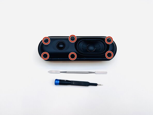

  4. Beats Pill 2024 Battery Daughterboard Replacement: crwdns2935265:04crwdnd2935265:01crwdnd2935265:01crwdne2935265:0
    • Use a Phillips #1 screwdriver to remove the six 14.3 mm screws that secure the driver assembly and speaker body together.

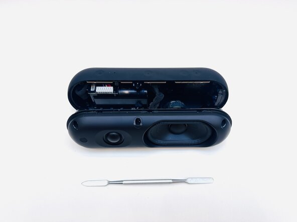

  5. Beats Pill 2024 Battery Daughterboard Replacement: crwdns2935265:05crwdnd2935265:01crwdnd2935265:02crwdne2935265:0 Beats Pill 2024 Battery Daughterboard Replacement: crwdns2935265:05crwdnd2935265:02crwdnd2935265:02crwdne2935265:0
    • Insert a spudger into the seam between the driver assembly and speaker body.
    • Gently slide the spudger around the perimeter while prying to separate the driver assembly from the speaker body.
    • This should not require much force.
  6. Beats Pill 2024 Battery Daughterboard Replacement: crwdns2935265:06crwdnd2935265:01crwdnd2935265:01crwdne2935265:0
    • Disconnect the two subwoofer connections from their motherboard sockets.
    • Depress the clip on each connector prior to removal.
    • Use tape or a marker to mark where each connector goes.
    • If you're completing a tweeter replacement, skip to Step 8.

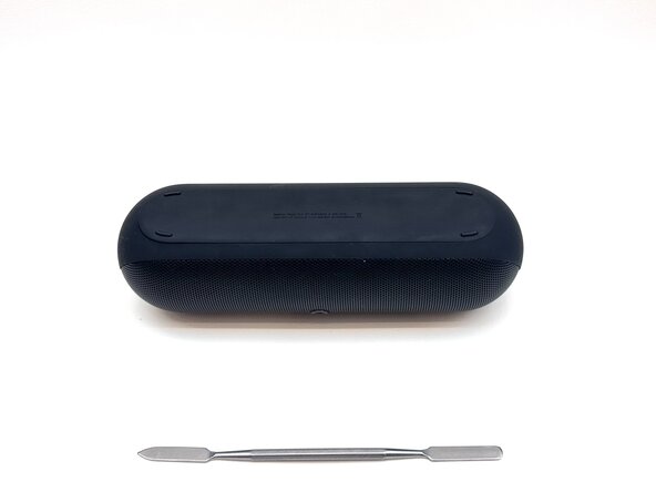

  9. Beats Pill 2024 Battery Daughterboard Replacement: crwdns2935265:09crwdnd2935265:01crwdnd2935265:02crwdne2935265:0 Beats Pill 2024 Battery Daughterboard Replacement: crwdns2935265:09crwdnd2935265:02crwdnd2935265:02crwdne2935265:0
    • Use a hairdryer to lightly heat the bottom foot of the speaker.
    • Insert a spudger into the seam between the bottom foot and speaker body.
    • Pry around the perimeter of the foot until it fully releases.
    • Reapply adhesive to the foot before reinstalling it.

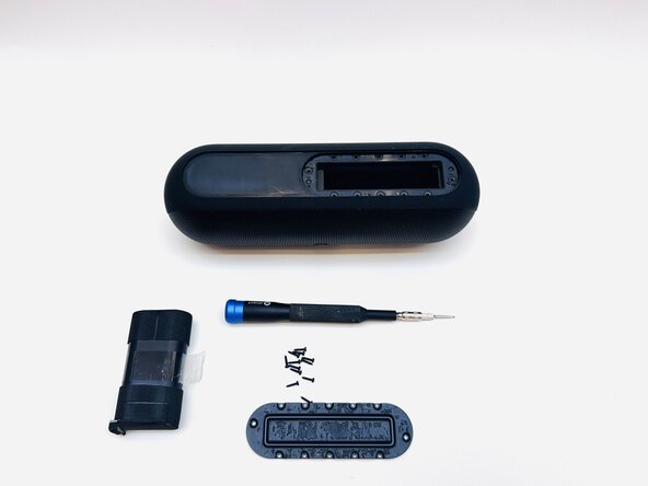

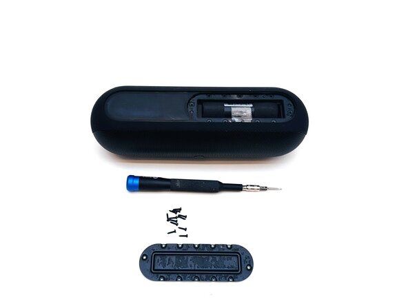

  10. Beats Pill 2024 Battery Daughterboard Replacement: crwdns2935265:010crwdnd2935265:01crwdnd2935265:02crwdne2935265:0 Beats Pill 2024 Battery Daughterboard Replacement: crwdns2935265:010crwdnd2935265:02crwdnd2935265:02crwdne2935265:0
    • Remove the twelve 8.6 mm T5 Torx screws that secure the battery cover.

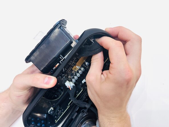

  11. Beats Pill 2024 Battery Daughterboard Replacement: crwdns2935265:011crwdnd2935265:01crwdnd2935265:03crwdne2935265:0 Beats Pill 2024 Battery Daughterboard Replacement: crwdns2935265:011crwdnd2935265:02crwdnd2935265:03crwdne2935265:0 Beats Pill 2024 Battery Daughterboard Replacement: crwdns2935265:011crwdnd2935265:03crwdnd2935265:03crwdne2935265:0
    • To remove the battery, pull on the tape material wrapped around the middle of it.

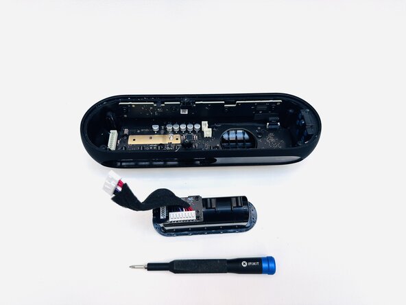

  12. Beats Pill 2024 Battery Daughterboard Replacement, Daughterboard Replacement: crwdns2935265:012crwdnd2935265:01crwdnd2935265:01crwdne2935265:0
    • Using a T5 Torx screwdriver to remove the two 8.6 mm screws securing the battery compartment.

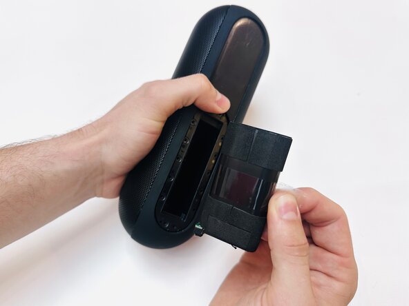

  13. Beats Pill 2024 Battery Daughterboard Replacement: crwdns2935265:013crwdnd2935265:01crwdnd2935265:03crwdne2935265:0 Beats Pill 2024 Battery Daughterboard Replacement: crwdns2935265:013crwdnd2935265:02crwdnd2935265:03crwdne2935265:0 Beats Pill 2024 Battery Daughterboard Replacement: crwdns2935265:013crwdnd2935265:03crwdnd2935265:03crwdne2935265:0
    • Disconnect the battery compartment connector from its motherboard socket.
    • Remove the battery compartment.
  14. Beats Pill 2024 Battery Daughterboard Replacement: crwdns2935265:014crwdnd2935265:01crwdnd2935265:01crwdne2935265:0
    • On the underside of the battery compartment, remove the three 12.4 mm Phillips screws that secure the daughterboard to the battery compartment.
