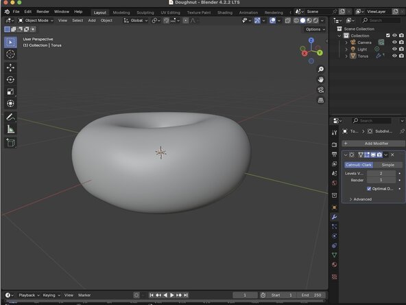

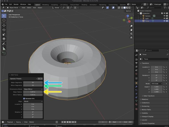

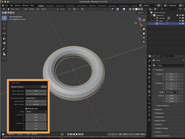

    1. Basic Modeling, Setting up Our Scene: crwdns2935265:01crwdnd2935265:01crwdnd2935265:03crwdne2935265:0 Basic Modeling, Setting up Our Scene: crwdns2935265:01crwdnd2935265:02crwdnd2935265:03crwdne2935265:0 Basic Modeling, Setting up Our Scene: crwdns2935265:01crwdnd2935265:03crwdnd2935265:03crwdne2935265:0
      • Open a New General Project in Blender and Delete the Default Cube.
      • Add a Torus to the scene by clicking Add > Mesh > Torus. This will add a standard Torus to the Scene.
      • Typically when modeling an object you are going to want to start with a primitive object that most resembles what you are attempting to monitor. I.e, if you are attempting to model a house then you will want to start with a square, or if you're building a vase then you will start with a cylinder.
    2. Basic Modeling, Modifying  Torus Segments: crwdns2935265:02crwdnd2935265:01crwdnd2935265:03crwdne2935265:0 Basic Modeling, Modifying  Torus Segments: crwdns2935265:02crwdnd2935265:02crwdnd2935265:03crwdne2935265:0 Basic Modeling, Modifying  Torus Segments: crwdns2935265:02crwdnd2935265:03crwdnd2935265:03crwdne2935265:0
      • We'll need to modify our Torus' Last Operator. To open the Lat Operator panel you can click on the Add Torus button at the bottom of the 3D Viewport.
      • Once you have the Add Torus pannel open you will modify the values of the Major Segments to 32, and set the Major Radious to .39 m
      • Major Segments: This parameter specifies the number of segments in the main ring of the torus. It determines how many times the cross-sectional circle is duplicated around the central axis. Increasing the number of segments results in a smoother, more circular appearance.
      • Minor Segments: This setting controls the number of segments in the cross-sectional circle of the torus. Higher values lead to a more refined and smoother cross-section, enhancing the overall smoothness of the torus.
      • Major Radius: This determines the distance from the center of the torus to the center of its cross-sectional tube. Adjusting the Major Radius changes the overall size of the torus's main ring.
      • Increasing the Major and Minor Segments can smooth a ring, but maxing them can impact performance and make editing cumbersome. Instead, use Shade Smoothing and Subdividing your Surface.

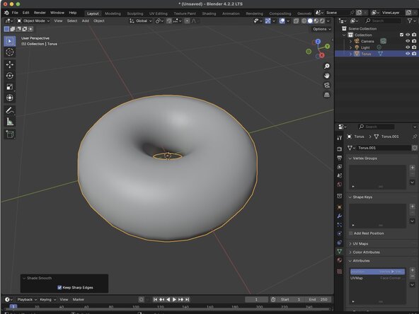

    3. Basic Modeling, Using Shade Smoothing: crwdns2935265:03crwdnd2935265:01crwdnd2935265:02crwdne2935265:0 Basic Modeling, Using Shade Smoothing: crwdns2935265:03crwdnd2935265:02crwdnd2935265:02crwdne2935265:0
      • Rather than increasing the geometry of our torus, we are going to use a function called Shade Smooth
      • Shade Smoothing is a function that modifies how light interacts with an object’s surfaces. By interpolating vertex normals across faces we creat the illusion of smoothness without complicating the geometry of a shape. This technique is particularly beneficial for rounded or organic models.
      • Simply right-click the object and choose Shade Smooth from the context menu.

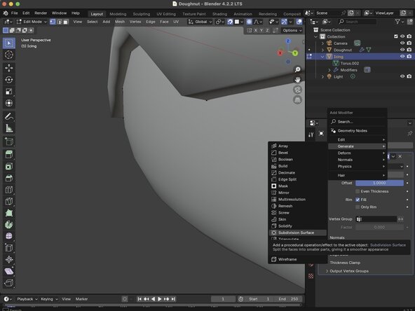

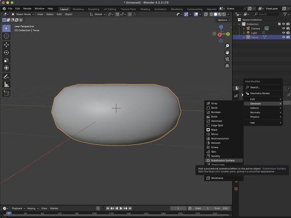

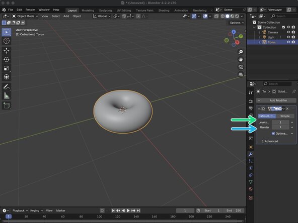

    4. Basic Modeling, Subdividing your Surface: crwdns2935265:04crwdnd2935265:01crwdnd2935265:03crwdne2935265:0 Basic Modeling, Subdividing your Surface: crwdns2935265:04crwdnd2935265:02crwdnd2935265:03crwdne2935265:0 Basic Modeling, Subdividing your Surface: crwdns2935265:04crwdnd2935265:03crwdnd2935265:03crwdne2935265:0
      • While our Shade Smoothing method does give our object a visually smooth look, we still have some visual artifacts along our edges. We can solve this problem by Subdividing our object's surface.
      • With our object selected, we are going to click our Modifiers button from the properties pannel.
      • Click Add Modifiers and choose Generate then Subdivision Surface. With the Subdivision Surface modifyer added, we are going to keep the Levels Viewport value at 1, and change our Render at a value to 1.
      • Levels Viewport: This setting determines how many times each face of a mesh is subdivided when displayed in the 3D Viewport. By increasing this value, you can achieve a smoother appearance for your model during editing.
      • Render: The Render setting, which specifies the subdivision level used during the final render. To ensure the rendered output matches what you see in the viewport, set both Levels Viewport and Render to the same value.

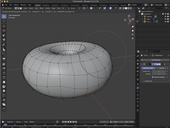

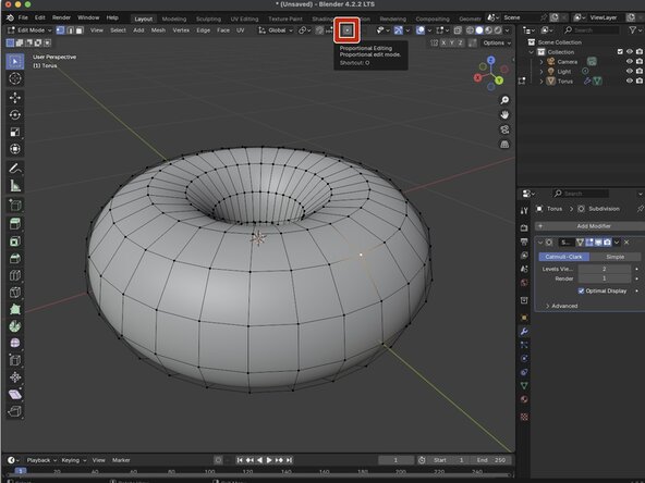

    5. Basic Modeling, Using Edit Mode: crwdns2935265:05crwdnd2935265:01crwdnd2935265:03crwdne2935265:0 Basic Modeling, Using Edit Mode: crwdns2935265:05crwdnd2935265:02crwdnd2935265:03crwdne2935265:0 Basic Modeling, Using Edit Mode: crwdns2935265:05crwdnd2935265:03crwdnd2935265:03crwdne2935265:0
      • Now we have our smooth object, but we want to deliberatly add imprefections for our specific use case. For this, we will enter edit mode. At the top of your 3D Viewport, you will click on Object Mode, and click Edit Object.
      • You can also use the Tab button to quick switch between modes.
      • Once in Edit Object mode, we can see the mesh that makes up our object.
      • Each individual point in your object's mesh is your object's vertex. The line that joins two vertices is called an edge, and four edges and vertices make up an individual face.
      • Each individual vertex can be moved the same way we move an object, but this can make our object apper unnatural, and can cause artifacting. Which is why we will use Proportianal Editing. Toggle on the Proportional Editing button at the top of the 3D Viewport.
      • Proportional Editing: This lets you transform selected mesh components (vertices, edges, faces) while affecting surrounding geometry within a radius. It’s useful for creating smooth, organic deformations and natural transitions in your model.
      • With Proportianal Editing on, select the vertex you want to edit and press the 'g' key to grab that vertex. Move your mouse to the desired point and use the scroll wheel to adjust how much of the area around the point you want to move with that point.

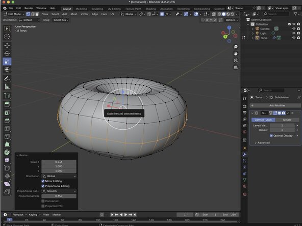

    6. Basic Modeling, Using Edit Mode (Continued): crwdns2935265:06crwdnd2935265:01crwdnd2935265:03crwdne2935265:0 Basic Modeling, Using Edit Mode (Continued): crwdns2935265:06crwdnd2935265:02crwdnd2935265:03crwdne2935265:0 Basic Modeling, Using Edit Mode (Continued): crwdns2935265:06crwdnd2935265:03crwdnd2935265:03crwdne2935265:0
      • We can also use the scailing in this mode. In this case we will be shrinking the circumfrence of our object. While holding down Shift we can drag along the visible edges that make up our circumfrence. You will need to orbit around your object using the Orbit Gizmo to select the complete circumfrence.
      • Once the whole circumfrence is selected, select the Scale Tool from the tool menu on the left-hand side of the 3D Viewport.

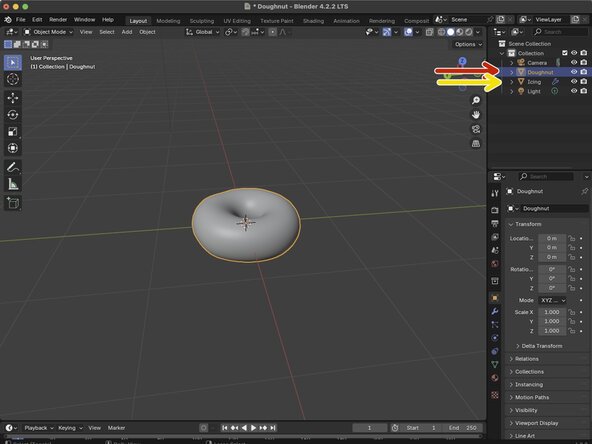

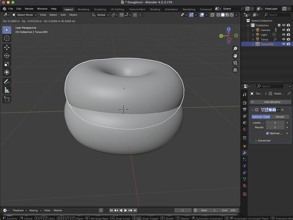

    7. Basic Modeling, Duplicating an Object: crwdns2935265:07crwdnd2935265:01crwdnd2935265:03crwdne2935265:0 Basic Modeling, Duplicating an Object: crwdns2935265:07crwdnd2935265:02crwdnd2935265:03crwdne2935265:0 Basic Modeling, Duplicating an Object: crwdns2935265:07crwdnd2935265:03crwdnd2935265:03crwdne2935265:0
      • For this step we are going to duplicate our modified Torus. This object will act as the icing on our model of a doughnut.
      • With our Torus selected, were going to click on Object then click Duplicate Objects, then press your esc key. This will place your duplicated object in the exact position as the original. The new object will also appear in the Outliner.
      • You can also rename your objects by double-clicking the object you want to rename in the Outliner
      • We renamed our origonal object to Doughnut.
      • We renamed our duplicate object to Icing.

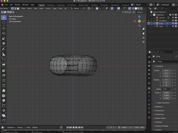

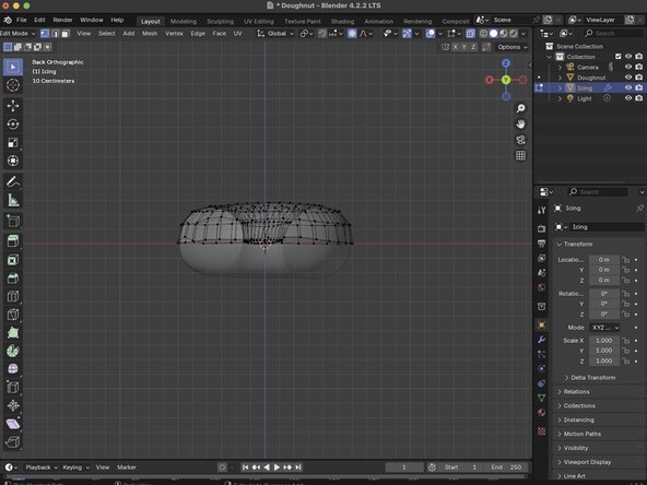

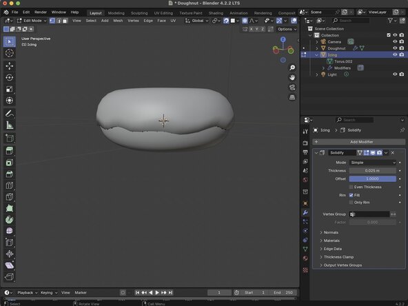

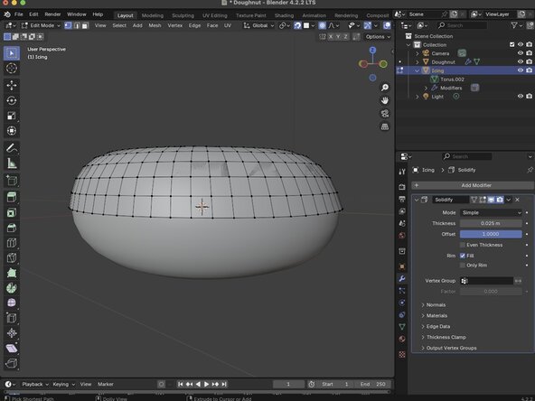

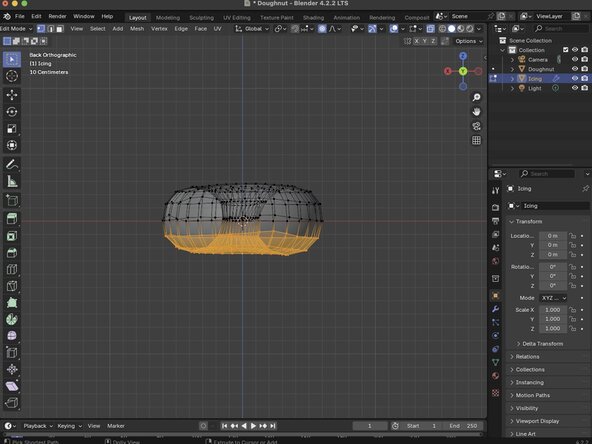

    8. Basic Modeling, Using X-Ray Mode: crwdns2935265:08crwdnd2935265:01crwdnd2935265:03crwdne2935265:0 Basic Modeling, Using X-Ray Mode: crwdns2935265:08crwdnd2935265:02crwdnd2935265:03crwdne2935265:0 Basic Modeling, Using X-Ray Mode: crwdns2935265:08crwdnd2935265:03crwdnd2935265:03crwdne2935265:0

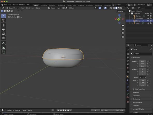

      • The next thing we're going to do is delete a section of our icing using Edit Mode.
      • Now we can delete each vertice by selecting one section at a time, but we can actually speed this process up by using X-Ray Mode to select geometry through the object.
    9. Basic Modeling, Deleting Vertices: crwdns2935265:09crwdnd2935265:01crwdnd2935265:03crwdne2935265:0 Basic Modeling, Deleting Vertices: crwdns2935265:09crwdnd2935265:02crwdnd2935265:03crwdne2935265:0 Basic Modeling, Deleting Vertices: crwdns2935265:09crwdnd2935265:03crwdnd2935265:03crwdne2935265:0
      • With all the vertices we want to delete selected we press the Delete key, and choose Verticies from the Context menu.
      • Switching back to our Object mode, we can see that our Doughnut model is now visible underneath the Icing model.

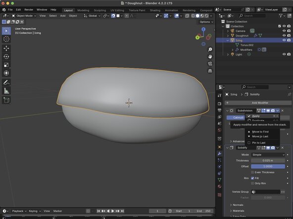

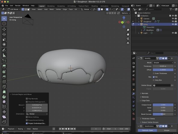

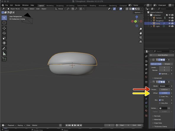

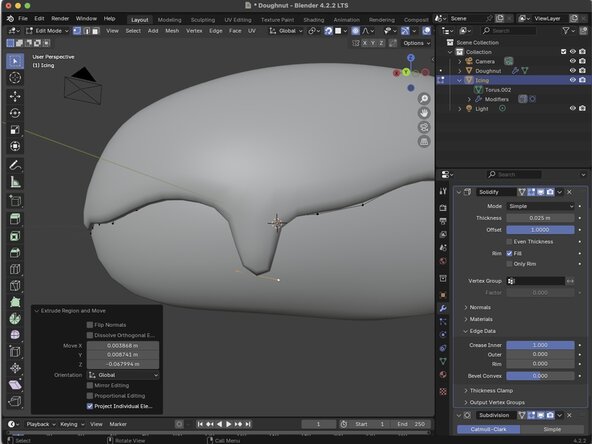

    10. Basic Modeling, Adding a Solidifier Modifier: crwdns2935265:010crwdnd2935265:01crwdnd2935265:03crwdne2935265:0 Basic Modeling, Adding a Solidifier Modifier: crwdns2935265:010crwdnd2935265:02crwdnd2935265:03crwdne2935265:0 Basic Modeling, Adding a Solidifier Modifier: crwdns2935265:010crwdnd2935265:03crwdnd2935265:03crwdne2935265:0
      • The next thing we're going to do is add some additional depth to our Icing. To do this we will add a Solidifier Modifier to our Icing.
      • With our Icing selected, we are going to click on Modifiers from our Properties menu and click the Add Modifier button. From there we choose Generate from the context menu, and click Solidify to add the Solidify Modifier to our Modifier properties.
      • We're going to change our thickness 0.025 m. This specifies the depth to our Icing's mesh.
      • We're also going to offset our model by a value of 1. This parameter determines the direction and positioning of the solidified thickness relative to the original mesh surface.

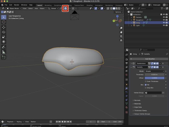

    11. Basic Modeling, Hiding a Modifier in Edit Mode: crwdns2935265:011crwdnd2935265:01crwdnd2935265:02crwdne2935265:0 Basic Modeling, Hiding a Modifier in Edit Mode: crwdns2935265:011crwdnd2935265:02crwdnd2935265:02crwdne2935265:0
      • Their are two buttons in our Modifiers panel with an icon resembling a triangle with dots at its corners.
      • Clicking these buttons will toggle the modifier's on and off for editing, and shows the base geometry. This helps to simplify editing later on by making it easier to select and manipulate the components of the Icing without adding any complexity.
    12. Basic Modeling, Adding a Subsurface Modifier: crwdns2935265:012crwdnd2935265:01crwdnd2935265:03crwdne2935265:0 Basic Modeling, Adding a Subsurface Modifier: crwdns2935265:012crwdnd2935265:02crwdnd2935265:03crwdne2935265:0 Basic Modeling, Adding a Subsurface Modifier: crwdns2935265:012crwdnd2935265:03crwdnd2935265:03crwdne2935265:0
      • Now if we attempt to add our dribbles to our Icing now, you might notice that our mesh begins to clip into our doughnut. What's happening is that our Icing's mesh doesn't have enough geomitry to account for our doughnut. So we're going to refine the Icing's mesh using the added Subdivision Surface Modifier.
      • With our Icing selected, we are going to go to our Modifiers pannel and find our Subdivision Surface Modifier. Click the down arrow in that modifier, and click Apply from the dropdown menu.
      • This will remove that modifier from our stack and will add more geomitry to our Icing.

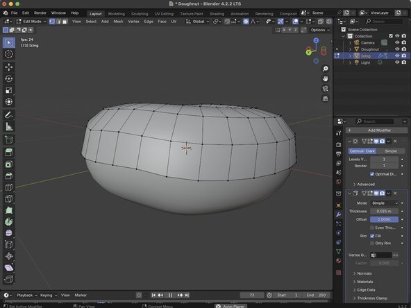

    13. Basic Modeling, Snapping an Object to a Surface: crwdns2935265:013crwdnd2935265:01crwdnd2935265:03crwdne2935265:0 Basic Modeling, Snapping an Object to a Surface: crwdns2935265:013crwdnd2935265:02crwdnd2935265:03crwdne2935265:0 Basic Modeling, Snapping an Object to a Surface: crwdns2935265:013crwdnd2935265:03crwdnd2935265:03crwdne2935265:0
      • Now from here we could use Proportional Editing to add our dribbles to our Icing, but you might notice that we get a bit of overhang when we attempt to do so. Which is why we need to have our Icing snap to our Doughtnut's surface.
      • Click on the Snapping Button at the top of the 3D Viewport, and under the section Snap Target for Individual Elements choose Face Project.
      • Once Face Project is selected, click the Snap Button next to Snapping, and the use Praportiaonal Editing to add dribbles to our icing.
      • We can see now that when we go to use Praportional Editing to begin adding dribbles to our icing, that our Icing snaps to the surface of our doughnut.

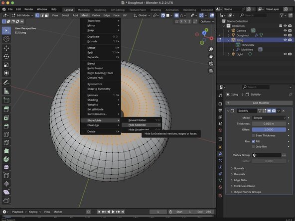

    14. Basic Modeling, Hiding Sections of Mesh: crwdns2935265:014crwdnd2935265:01crwdnd2935265:03crwdne2935265:0 Basic Modeling, Hiding Sections of Mesh: crwdns2935265:014crwdnd2935265:02crwdnd2935265:03crwdne2935265:0 Basic Modeling, Hiding Sections of Mesh: crwdns2935265:014crwdnd2935265:03crwdnd2935265:03crwdne2935265:0
      • We're also going to need to hid a section of our mesh to prefvent it from being effected by our editing later on. Double-click a vertex in our inner circumference of our Icing to select the whole circumfrence. Press Control and '+' to add to the selection.
      • From the top of our 3D Viewport, choose Mesh, Show/Hide, then choose Hide Selected to hide our selected region.
      • You can show it later on by choosing Mesh, Show/Hide, then click Reveal Hiddin to show our selected region.
    15. Basic Modeling, Adding Waves to the Model: crwdns2935265:015crwdnd2935265:01crwdnd2935265:02crwdne2935265:0 Basic Modeling, Adding Waves to the Model: crwdns2935265:015crwdnd2935265:02crwdnd2935265:02crwdne2935265:0
      • With the section of our Icing's mesh hidden, we can now begin editing our Icing to make it appear more realistic.
      • Using the Proportional Editing tool we simply need to select a vertex along the outer edge of our Icing, pressing 'g' to grab that vertex, and dragging it to our desired position.

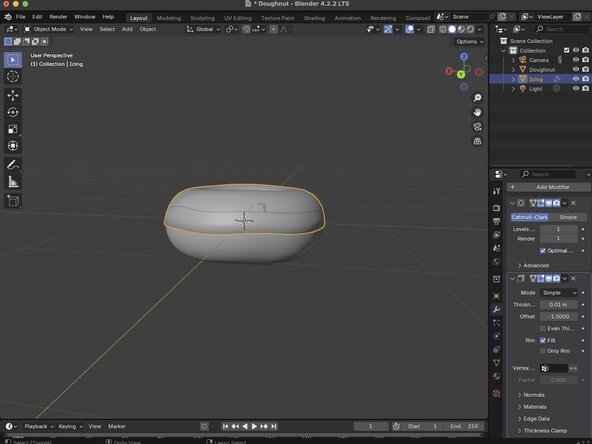

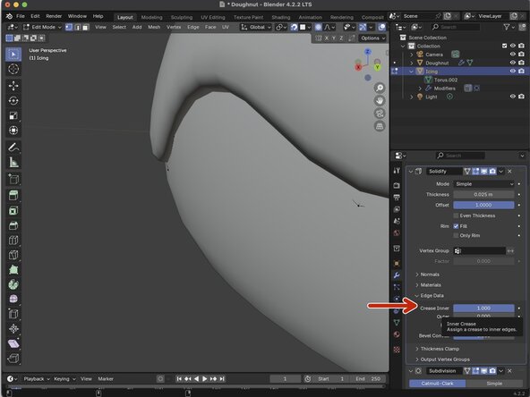

    16. Basic Modeling, Rounding the Edges: crwdns2935265:016crwdnd2935265:01crwdnd2935265:03crwdne2935265:0 Basic Modeling, Rounding the Edges: crwdns2935265:016crwdnd2935265:02crwdnd2935265:03crwdne2935265:0 Basic Modeling, Rounding the Edges: crwdns2935265:016crwdnd2935265:03crwdnd2935265:03crwdne2935265:0

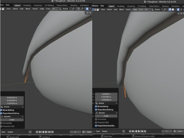

      • Now as your adding your waves to your Icing, you'll probably notice that the edges of our Icing has an angle to it. We can fix this by adding another Subdivision Surface Modifier to our Icing to add a few more points to our mesh.
      • Click Add Modifier and in the context menu select Generate then Subdivision Surface.
      • Underneath our Solidify Modifier we are also going to need to change our Crease Inner value to 1 to give our Icing's edge a curve.
    17. Basic Modeling, Using Extrusion: crwdns2935265:017crwdnd2935265:01crwdnd2935265:03crwdne2935265:0 Basic Modeling, Using Extrusion: crwdns2935265:017crwdnd2935265:02crwdnd2935265:03crwdne2935265:0 Basic Modeling, Using Extrusion: crwdns2935265:017crwdnd2935265:03crwdnd2935265:03crwdne2935265:0
      • We can also add additional dribble to our Icing by using the Extrude feature.
      • Extruding: This is when you extend a selected face or profile along a specified path to add depth, effectively transforming it into a three-dimensional shape. This technique is fundamental in constructing complex geometries
      • Simple select two verticies along the bottom of our Icing's waves and press the 'e' key. Then drag down to create a nice long dribble. You can click to release once you've reached your desired length.
