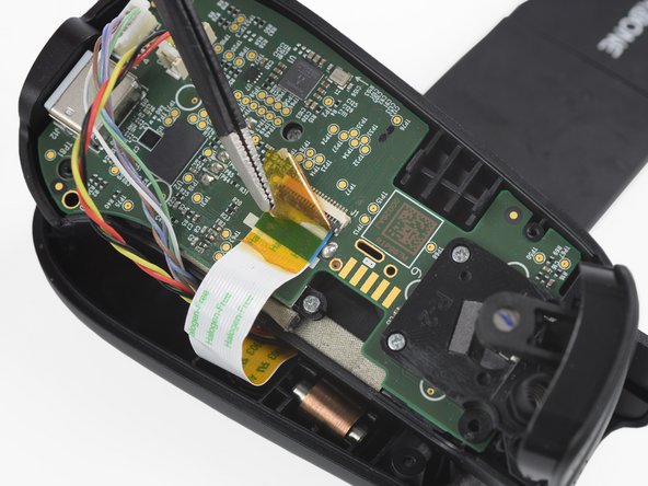

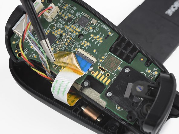

    1. Backbone One Right Mainboard Replacement, Remove the protective tape: crwdns2935265:03crwdnd2935265:01crwdnd2935265:03crwdne2935265:0 Backbone One Right Mainboard Replacement, Remove the protective tape: crwdns2935265:03crwdnd2935265:02crwdnd2935265:03crwdne2935265:0 Backbone One Right Mainboard Replacement, Remove the protective tape: crwdns2935265:03crwdnd2935265:03crwdnd2935265:03crwdne2935265:0

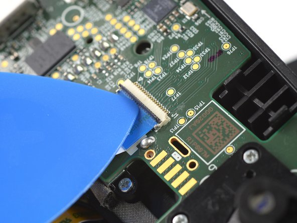

      • Use a pair of tweezers to remove the yellow protective tape which is placed over the interconnect cable and the connector.

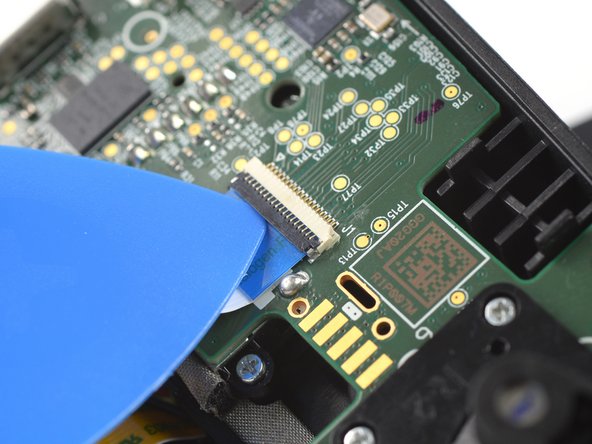

    2. Backbone One Right Mainboard Replacement, Open the interconnect cable ZIF connector: crwdns2935265:04crwdnd2935265:01crwdnd2935265:03crwdne2935265:0 Backbone One Right Mainboard Replacement, Open the interconnect cable ZIF connector: crwdns2935265:04crwdnd2935265:02crwdnd2935265:03crwdne2935265:0 Backbone One Right Mainboard Replacement, Open the interconnect cable ZIF connector: crwdns2935265:04crwdnd2935265:03crwdnd2935265:03crwdne2935265:0
      • Use the tip of an opening pick to open the gray flap of the interconnect cable ZIF connector by pushing it upwards.

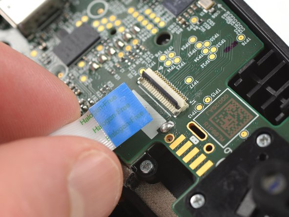

    3. Backbone One Right Mainboard Replacement, Disconnect the interconnect cable: crwdns2935265:05crwdnd2935265:01crwdnd2935265:02crwdne2935265:0 Backbone One Right Mainboard Replacement, Disconnect the interconnect cable: crwdns2935265:05crwdnd2935265:02crwdnd2935265:02crwdne2935265:0
      • Disconnect the cable by pulling it straight out the ZIF connector.

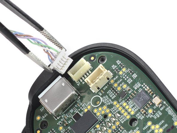

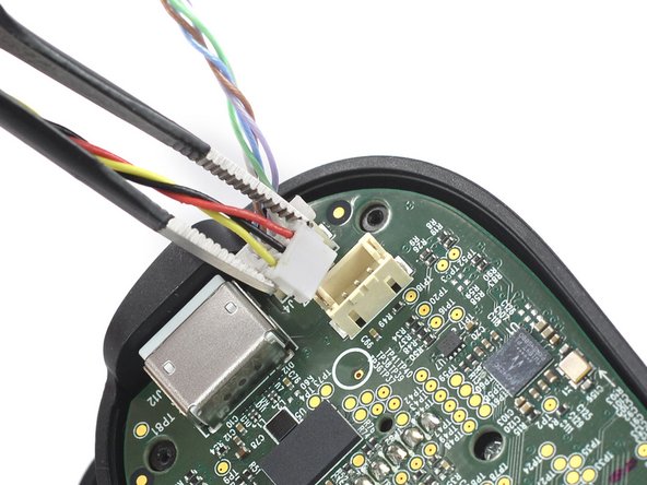

    4. Backbone One Right Mainboard Replacement, Disconnect the phone connector cables: crwdns2935265:06crwdnd2935265:01crwdnd2935265:03crwdne2935265:0 Backbone One Right Mainboard Replacement, Disconnect the phone connector cables: crwdns2935265:06crwdnd2935265:02crwdnd2935265:03crwdne2935265:0 Backbone One Right Mainboard Replacement, Disconnect the phone connector cables: crwdns2935265:06crwdnd2935265:03crwdnd2935265:03crwdne2935265:0
      • Use a pair of tweezers to disconnect the phone connector cables out from their sockets.

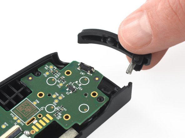

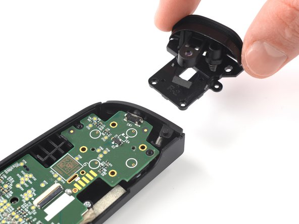

    7. Backbone One Right Mainboard Replacement, Remove the trigger: crwdns2935265:09crwdnd2935265:01crwdnd2935265:02crwdne2935265:0 Backbone One Right Mainboard Replacement, Remove the trigger: crwdns2935265:09crwdnd2935265:02crwdnd2935265:02crwdne2935265:0
      • Remove the trigger.
    1. Backbone One Right Mainboard Replacement, Remove the bumper: crwdns2935265:010crwdnd2935265:01crwdnd2935265:02crwdne2935265:0 Backbone One Right Mainboard Replacement, Remove the bumper: crwdns2935265:010crwdnd2935265:02crwdnd2935265:02crwdne2935265:0
      • Remove the bumper.

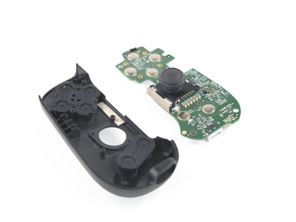

    2. Backbone One Right Mainboard Replacement, Remove the mainboard: crwdns2935265:012crwdnd2935265:01crwdnd2935265:03crwdne2935265:0 Backbone One Right Mainboard Replacement, Remove the mainboard: crwdns2935265:012crwdnd2935265:02crwdnd2935265:03crwdne2935265:0 Backbone One Right Mainboard Replacement, Remove the mainboard: crwdns2935265:012crwdnd2935265:03crwdnd2935265:03crwdne2935265:0
      • Remove the mainboard.
