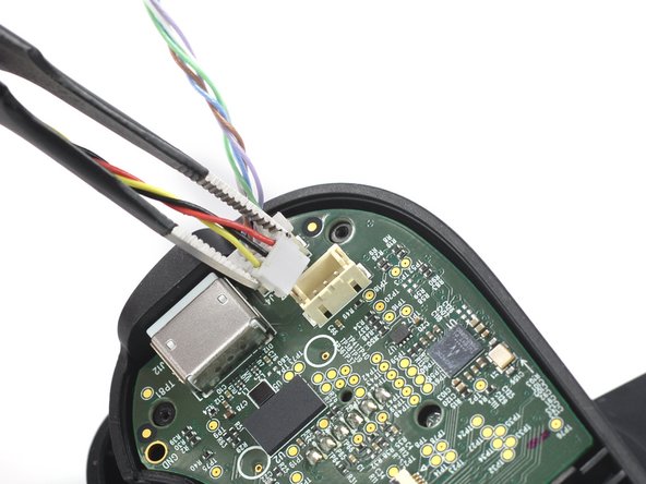

  5. Backbone One Phone Connector Replacement, Disconnect the phone connector cable: crwdns2935265:05crwdnd2935265:01crwdnd2935265:02crwdne2935265:0 Backbone One Phone Connector Replacement, Disconnect the phone connector cable: crwdns2935265:05crwdnd2935265:02crwdnd2935265:02crwdne2935265:0
    • Use a pair of tweezers to disconnect the first phone connector cable from the mainboard.

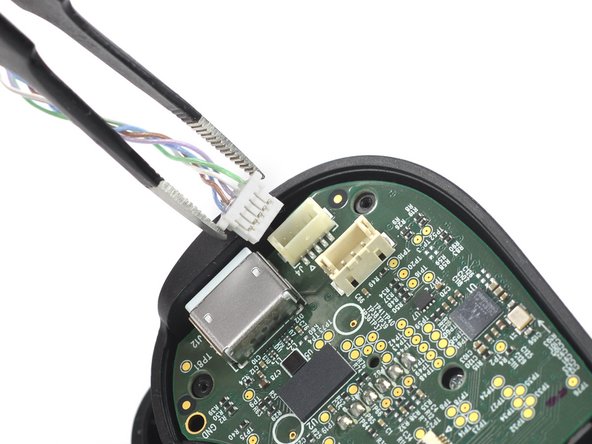

  6. Backbone One Phone Connector Replacement, Disconnect the phone connector cable: crwdns2935265:06crwdnd2935265:01crwdnd2935265:02crwdne2935265:0 Backbone One Phone Connector Replacement, Disconnect the phone connector cable: crwdns2935265:06crwdnd2935265:02crwdnd2935265:02crwdne2935265:0
    • Use a pair of tweezers to disconnect the second phone connector cable from the mainboard.
