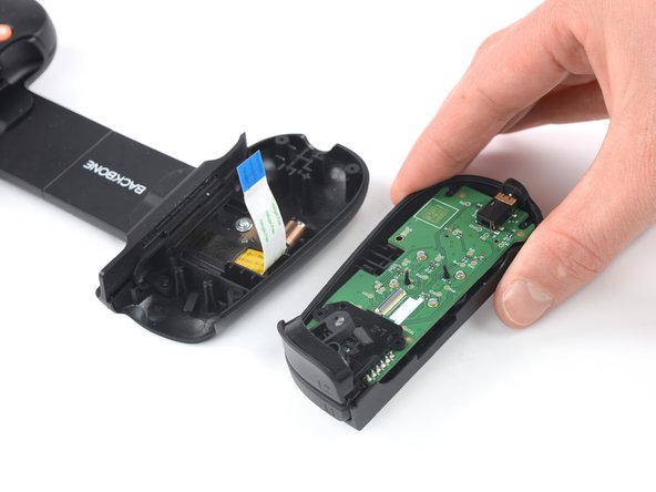

    2. Backbone One Left Mainboard Replacement, Rotate the upper cover: crwdns2935265:02crwdnd2935265:01crwdnd2935265:03crwdne2935265:0 Backbone One Left Mainboard Replacement, Rotate the upper cover: crwdns2935265:02crwdnd2935265:02crwdnd2935265:03crwdne2935265:0 Backbone One Left Mainboard Replacement, Rotate the upper cover: crwdns2935265:02crwdnd2935265:03crwdnd2935265:03crwdne2935265:0
      • Lift up the upper part of the controller.
      • Swing over the upper cover and place it on the controller case.
      • Take care that the interconnecting cable has no tension.

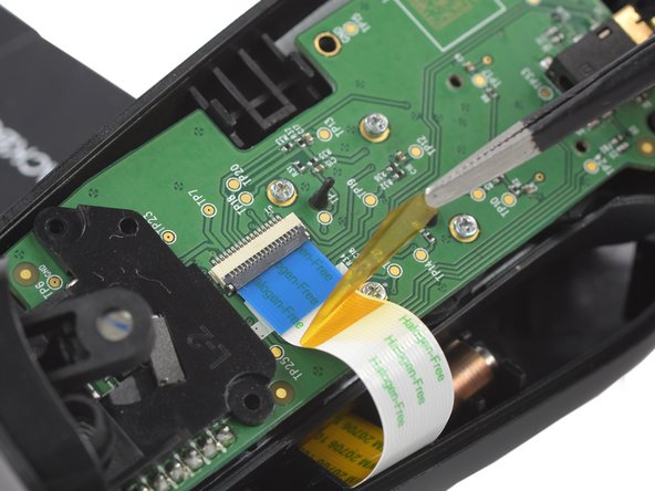

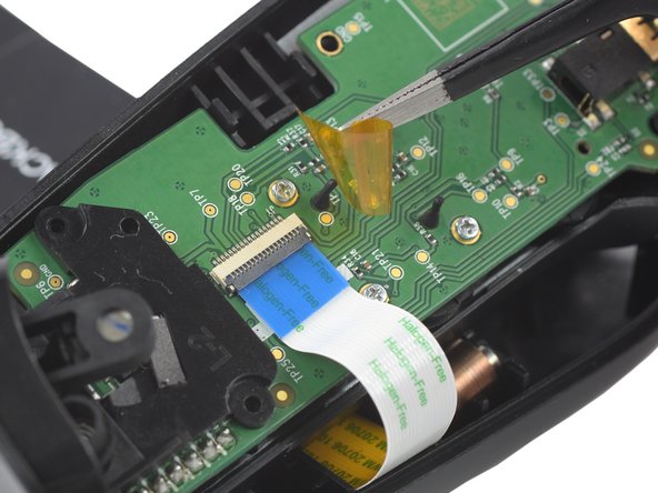

    3. Backbone One Left Mainboard Replacement, Remove the protective tape: crwdns2935265:03crwdnd2935265:01crwdnd2935265:03crwdne2935265:0 Backbone One Left Mainboard Replacement, Remove the protective tape: crwdns2935265:03crwdnd2935265:02crwdnd2935265:03crwdne2935265:0 Backbone One Left Mainboard Replacement, Remove the protective tape: crwdns2935265:03crwdnd2935265:03crwdnd2935265:03crwdne2935265:0

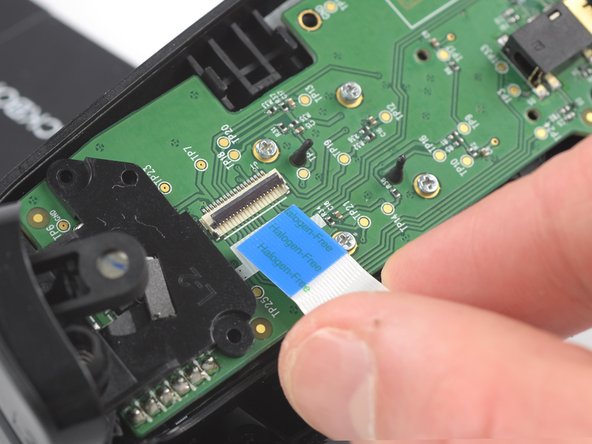

      • Use a pair of tweezers to remove the yellow protective tape which is placed over the interconnect cable connector.
    4. Backbone One Left Mainboard Replacement, Open the ZIF connector: crwdns2935265:04crwdnd2935265:01crwdnd2935265:02crwdne2935265:0 Backbone One Left Mainboard Replacement, Open the ZIF connector: crwdns2935265:04crwdnd2935265:02crwdnd2935265:02crwdne2935265:0
      • Use the tip of an opening pick to open the gray flap of the ZIF connector by pushing it upwards.
    5. Backbone One Left Mainboard Replacement, Disconnect the interconnect cable: crwdns2935265:05crwdnd2935265:01crwdnd2935265:02crwdne2935265:0 Backbone One Left Mainboard Replacement, Disconnect the interconnect cable: crwdns2935265:05crwdnd2935265:02crwdnd2935265:02crwdne2935265:0
      • Use your fingers to disconnect the interconnect cable from its connector.

      • Remove the upper half of the left controller assembly.

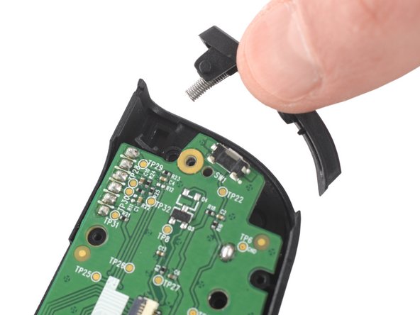

    1. Backbone One Left Mainboard Replacement, Remove the bumper: crwdns2935265:09crwdnd2935265:01crwdnd2935265:02crwdne2935265:0 Backbone One Left Mainboard Replacement, Remove the bumper: crwdns2935265:09crwdnd2935265:02crwdnd2935265:02crwdne2935265:0
      • Use your fingers to remove the left bumper.

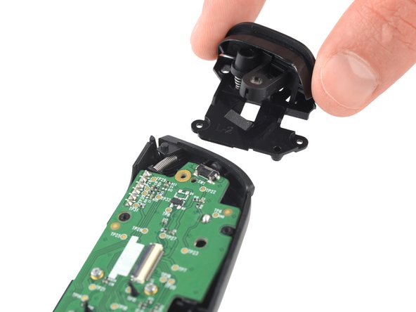

    1. Backbone One Left Mainboard Replacement, Remove the screws: crwdns2935265:010crwdnd2935265:01crwdnd2935265:01crwdne2935265:0
      • Use a Phillips screwdriver to remove the four 3.9 mm-long screws.
    2. Backbone One Left Mainboard Replacement, Remove the mainboard: crwdns2935265:011crwdnd2935265:01crwdnd2935265:02crwdne2935265:0 Backbone One Left Mainboard Replacement, Remove the mainboard: crwdns2935265:011crwdnd2935265:02crwdnd2935265:02crwdne2935265:0
      • Remove the mainboard.

In my unit, there were two more screws at step (10), in the upper part of the controller, near the trigger. They may have changed the number of screws used in manufacturing at some point.
