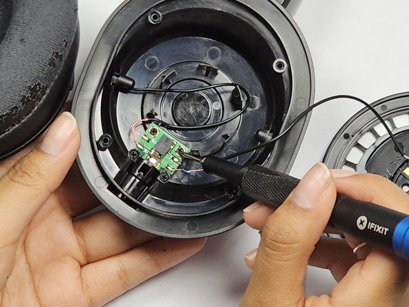

      • Grip the ear cup, gently twist it, and pull it off.
      • Use a Phillips #0 screwdriver to remove the four 3 mm screws securing the driver.
    2. Audio-Technica ATH-M40x Left Driver Replacement: crwdns2935265:02crwdnd2935265:01crwdnd2935265:03crwdne2935265:0 Audio-Technica ATH-M40x Left Driver Replacement: crwdns2935265:02crwdnd2935265:02crwdnd2935265:03crwdne2935265:0 Audio-Technica ATH-M40x Left Driver Replacement: crwdns2935265:02crwdnd2935265:03crwdnd2935265:03crwdne2935265:0
      • Use a spudger to pry the driver from the headphones but don't pull it or yank it off as it is connected by wire cables and could rip those out.

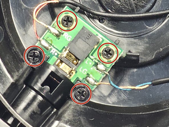

      • Use a Phillips #0 screwdriver to remove the four 2 mm screws from the small circuit board in the housing.
      • You will be able to desolder the driver wires more easily once the board is removed.

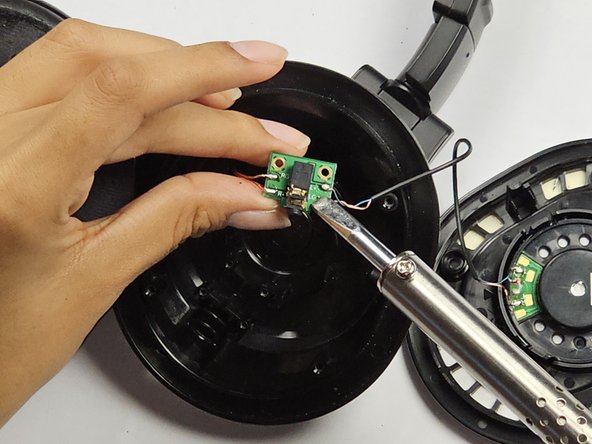

    3. Audio-Technica ATH-M40x Left Driver Replacement: crwdns2935265:03crwdnd2935265:01crwdnd2935265:02crwdne2935265:0 Audio-Technica ATH-M40x Left Driver Replacement: crwdns2935265:03crwdnd2935265:02crwdnd2935265:02crwdne2935265:0
      • Desolder the two connections labeled L+ and LG to disconnect the left driver from the headphones.
      • Be careful when using the soldering iron as it is extremely hot and can burn you. Use safety gloves if possible and helping hands to hold the circuit board. Alternatively, tape the board to a solder-safe surface to make the process easier.
      • Although this guide demonstrates how to replace the left driver, the right speaker wires are soldered onto this board also. When replacing the right driver, desolder the connectors labeled RG and R+.
