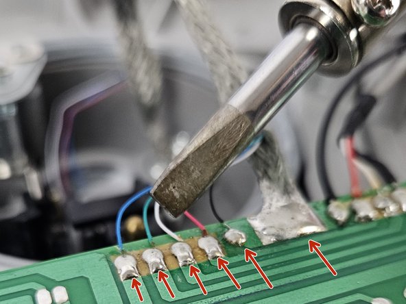

  5. Audio-Technica AT-LP120-USB Anti-Skate Knob Spring Replacement, Anti-Skate Knob Spring: crwdns2935265:05crwdnd2935265:01crwdnd2935265:03crwdne2935265:0 Audio-Technica AT-LP120-USB Anti-Skate Knob Spring Replacement, Anti-Skate Knob Spring: crwdns2935265:05crwdnd2935265:02crwdnd2935265:03crwdne2935265:0 Audio-Technica AT-LP120-USB Anti-Skate Knob Spring Replacement, Anti-Skate Knob Spring: crwdns2935265:05crwdnd2935265:03crwdnd2935265:03crwdne2935265:0
    • The Anti-Skate Knob is in the top left corner of the record player; this is what holds together the Tonearm.
    • To remove this, you must desolder the five small connections and the large one next to it.

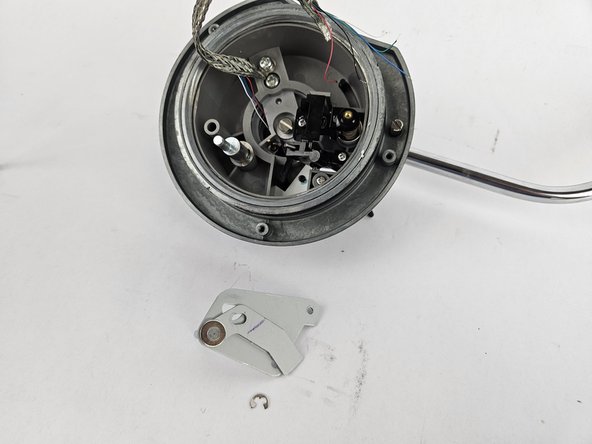

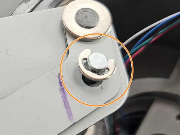

  6. Audio-Technica AT-LP120-USB Anti-Skate Knob Spring Replacement: crwdns2935265:06crwdnd2935265:01crwdnd2935265:02crwdne2935265:0 Audio-Technica AT-LP120-USB Anti-Skate Knob Spring Replacement: crwdns2935265:06crwdnd2935265:02crwdnd2935265:02crwdne2935265:0
    • Use a Phillips #2 screwdriver to remove the two screws.
    • Using Snap Ring Pliers, pull up at the Snap Ring to remove it.
  7. Audio-Technica AT-LP120-USB Anti-Skate Knob Spring Replacement: crwdns2935265:07crwdnd2935265:01crwdnd2935265:02crwdne2935265:0 Audio-Technica AT-LP120-USB Anti-Skate Knob Spring Replacement: crwdns2935265:07crwdnd2935265:02crwdnd2935265:02crwdne2935265:0

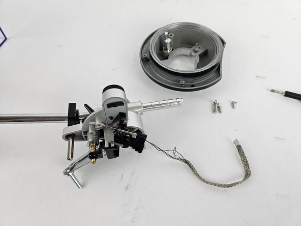

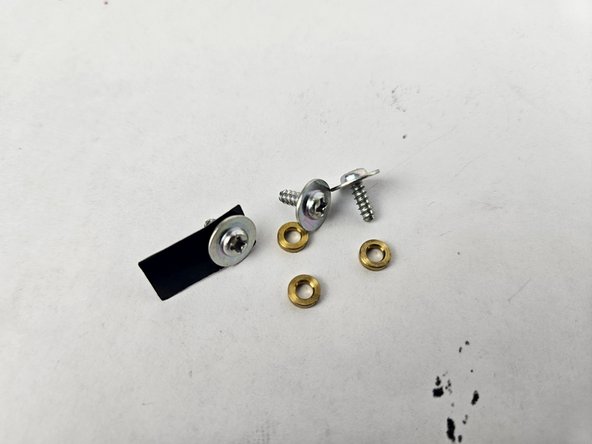

    • Remove the 2.5 mm screws using a Phillips #2 that connects the tonearm to the record player frame.

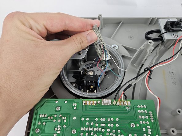

  8. Audio-Technica AT-LP120-USB Anti-Skate Knob Spring Replacement: crwdns2935265:08crwdnd2935265:01crwdnd2935265:03crwdne2935265:0 Audio-Technica AT-LP120-USB Anti-Skate Knob Spring Replacement: crwdns2935265:08crwdnd2935265:02crwdnd2935265:03crwdne2935265:0 Audio-Technica AT-LP120-USB Anti-Skate Knob Spring Replacement: crwdns2935265:08crwdnd2935265:03crwdnd2935265:03crwdne2935265:0
    • Unscrew the cable with the Phillips #2 screwdriver.

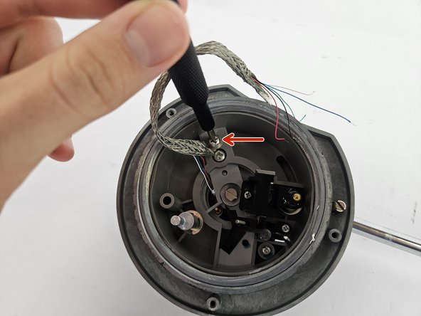

  9. Audio-Technica AT-LP120-USB Anti-Skate Knob Spring Replacement: crwdns2935265:09crwdnd2935265:01crwdnd2935265:03crwdne2935265:0 Audio-Technica AT-LP120-USB Anti-Skate Knob Spring Replacement: crwdns2935265:09crwdnd2935265:02crwdnd2935265:03crwdne2935265:0 Audio-Technica AT-LP120-USB Anti-Skate Knob Spring Replacement: crwdns2935265:09crwdnd2935265:03crwdnd2935265:03crwdne2935265:0

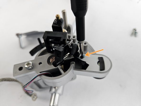

    • Use a Philips #2 screwdriver to remove the two 2.5 mm screws, and remove the Snap Ring by pulling up at it with Snap Ring Pliers which are being highlighted.
    • DO NOT unscrew the yellow X in the picture.
    • Remove the small 0.1 mm black screw with the Phillips #000 screwdriver.

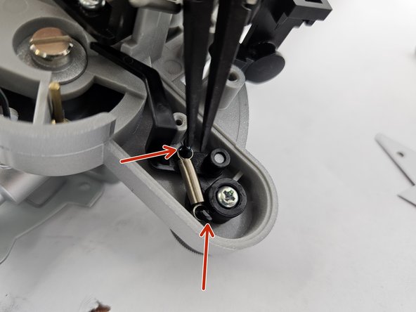

  10. Audio-Technica AT-LP120-USB Anti-Skate Knob Spring Replacement: crwdns2935265:010crwdnd2935265:01crwdnd2935265:03crwdne2935265:0 Audio-Technica AT-LP120-USB Anti-Skate Knob Spring Replacement: crwdns2935265:010crwdnd2935265:02crwdnd2935265:03crwdne2935265:0 Audio-Technica AT-LP120-USB Anti-Skate Knob Spring Replacement: crwdns2935265:010crwdnd2935265:03crwdnd2935265:03crwdne2935265:0

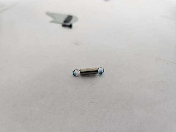

    • Pull off the cover to reveal the spring.
    • Using Tweezers, pull the spring out by pulling it off of the hooks on each end.
  11. Audio-Technica AT-LP120-USB Anti-Skate Knob Spring Replacement: crwdns2935265:011crwdnd2935265:01crwdnd2935265:01crwdne2935265:0
    • Now replace the old spring with your new one!
