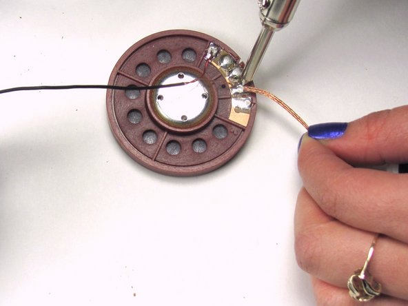

  6. Audio Technica ATH-AD500 Driver Replacement: crwdns2935265:06crwdnd2935265:01crwdnd2935265:02crwdne2935265:0 Audio Technica ATH-AD500 Driver Replacement: crwdns2935265:06crwdnd2935265:02crwdnd2935265:02crwdne2935265:0
    • Remove the two wires, red and yellow, by de-soldering them from the driver using a soldering iron and desoldering wick. Reference How To Solder and Desolder Connections.
    • The areas where you solder will be hot so wait until the solder joints are cool before handling the wires again.

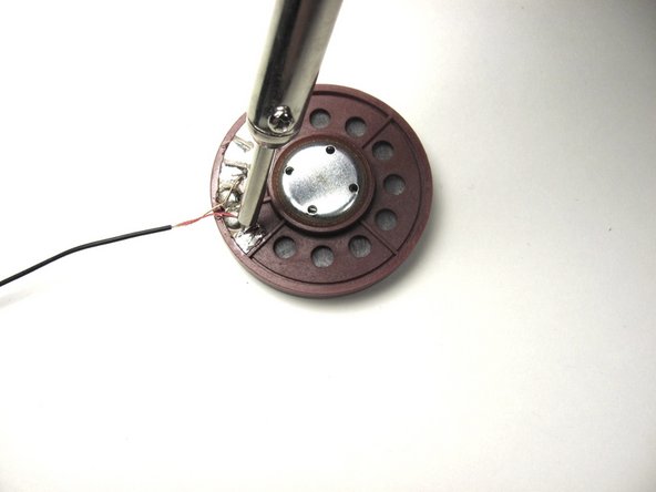

  7. Audio Technica ATH-AD500 Driver Replacement: crwdns2935265:07crwdnd2935265:01crwdnd2935265:02crwdne2935265:0 Audio Technica ATH-AD500 Driver Replacement: crwdns2935265:07crwdnd2935265:02crwdnd2935265:02crwdne2935265:0
    • Connect the existing wires to the new driver by re-soldering the wires using the soldering iron.
    • Using the copper as a reference, re-solder the yellow wire to the top left solder joint and the red to the bottom left solder joint.
