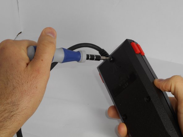

    • Turn the controller over, exposing the three screws on the back. Use a 6mm screwdriver to remove these screws.
    • Carefully slide and pull the two parts of the controller shell apart, exposing the innards.

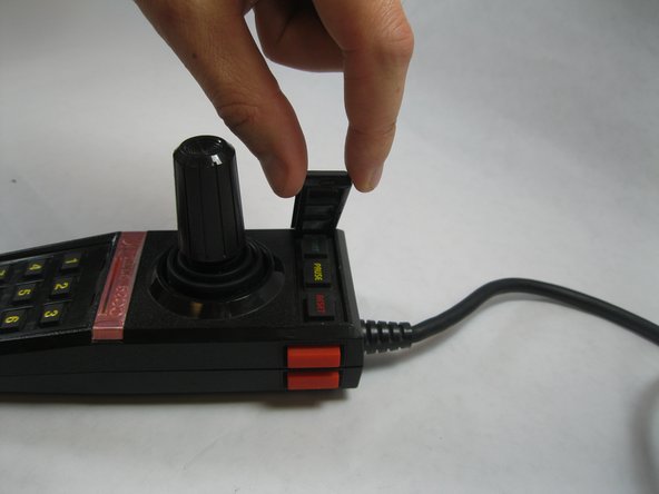

    • Now that the top of the controller is exposed, the orange, side buttons can easily slide out.
    • Realign the buttons over the sensors/clean the sensor contacts.
    • Be careful when reassembling your buttons. Make sure the black buttons are aligned properly over the silver sensors on the flex board
    • Also, be careful to properly align the bottom of the joystick with the pots (white levers)

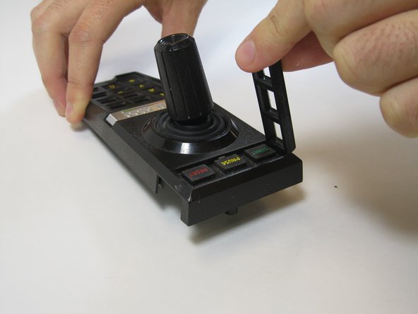

    • Use a spudger to remove the top frame.
    • Take off the plate.
    • Remove the rubber buttons.

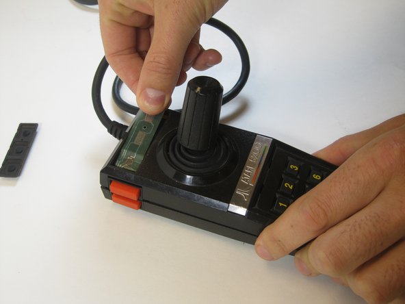

    • Pull the circuit strip through the new space.
    • Realign the top and bottom of the controller.
