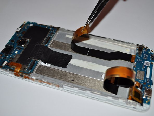

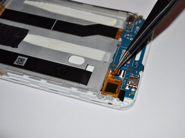

    • At the top of the phone, disconnect the black screen flex cable (the one that is rectangular) using a black nylon spudger. Peel it all the way back.
    • Using a black nylon spudger, disconnect the charging port flex cable (the other black cable) and microphone button. Peel it all the way back.
    • The metal spudger should not be used on internal components.

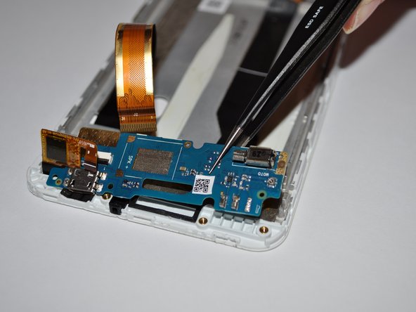

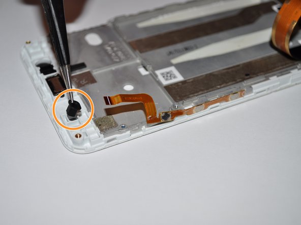

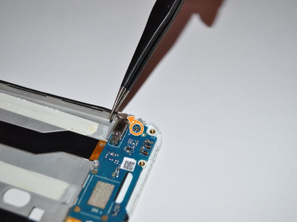

    • Remove the four 2.5mm Phillips #0 screws that hold the motherboard and remove the motherboard. Follow our motherboard replacement guide.
    • Remove the (blue) daughterboard. The charging port flex cable will come with it.
    • Be careful when removing the daughterboard. It is thin and adhered very solidly to the screen.
    • Move the rubber piece (denoted with orange circle) from the old port to your new LCD assembly.
