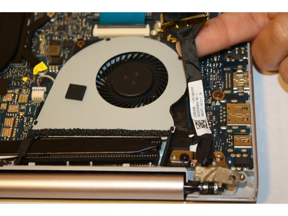

  3. Asus Zenbook UX303L Keyboard Replacement: crwdns2935265:03crwdnd2935265:01crwdnd2935265:02crwdne2935265:0 Asus Zenbook UX303L Keyboard Replacement: crwdns2935265:03crwdnd2935265:02crwdnd2935265:02crwdne2935265:0
    • Remove the LVDS cable next to the cooling fan.

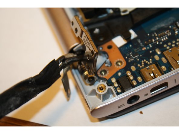

    • Remove the three screws from the hinges using a PH-1 screwdriver.
    • Open the device at a 90 degree angle to free the hinges.

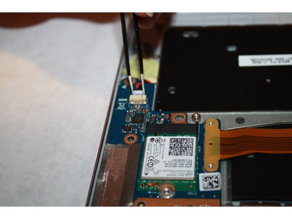

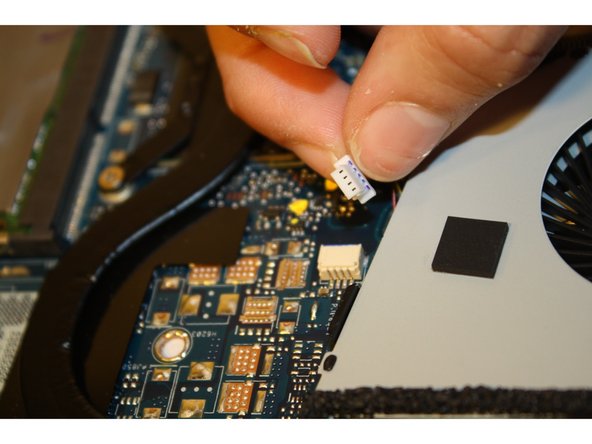

  5. Asus Zenbook UX303L Keyboard Replacement: crwdns2935265:05crwdnd2935265:01crwdnd2935265:03crwdne2935265:0 Asus Zenbook UX303L Keyboard Replacement: crwdns2935265:05crwdnd2935265:02crwdnd2935265:03crwdne2935265:0 Asus Zenbook UX303L Keyboard Replacement: crwdns2935265:05crwdnd2935265:03crwdnd2935265:03crwdne2935265:0
    • Remove the screw attaching the cooling fan to the motherboard by using a PH-1 screwdriver.
    • Disconnect the wire attaching the cooling fan to the motherboard.
    • Gently lift and pull out the cooling fan.

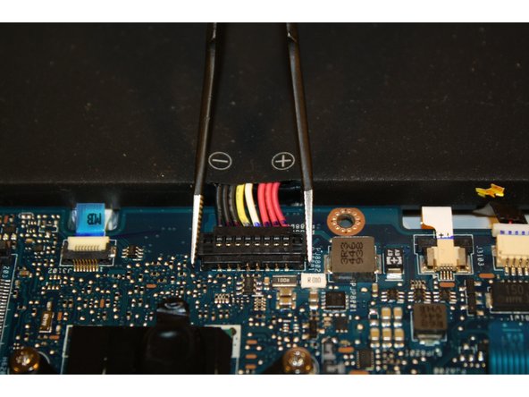

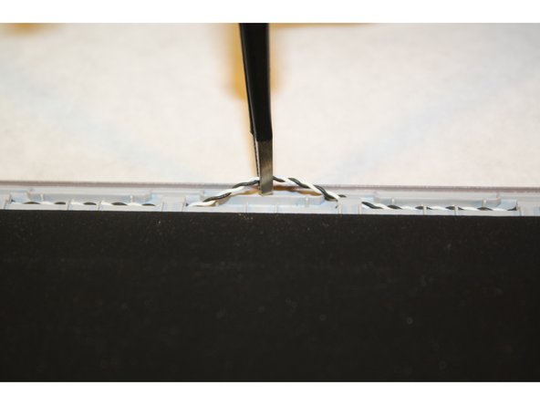

  8. Asus Zenbook UX303L Keyboard Replacement: crwdns2935265:08crwdnd2935265:01crwdnd2935265:03crwdne2935265:0 Asus Zenbook UX303L Keyboard Replacement: crwdns2935265:08crwdnd2935265:02crwdnd2935265:03crwdne2935265:0 Asus Zenbook UX303L Keyboard Replacement: crwdns2935265:08crwdnd2935265:03crwdnd2935265:03crwdne2935265:0
    • Unhook the black, red, and white switch using the tweezers.
    • Detach the positive and negative red, white, yellow, and black switch.
    • Unhook the black and white coiled wire.
    • Lift and remove the battery pack.

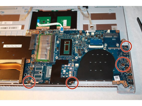

  10. Asus Zenbook UX303L Keyboard Replacement: crwdns2935265:010crwdnd2935265:01crwdnd2935265:02crwdne2935265:0 Asus Zenbook UX303L Keyboard Replacement: crwdns2935265:010crwdnd2935265:02crwdnd2935265:02crwdne2935265:0
    • Remove the silver tape to free the fourth screw attaching the motherboard.
    • Remove the four screws attaching the motherboard using a PH-1 screwdriver.
  11. Asus Zenbook UX303L Keyboard Replacement: crwdns2935265:011crwdnd2935265:01crwdnd2935265:02crwdne2935265:0 Asus Zenbook UX303L Keyboard Replacement: crwdns2935265:011crwdnd2935265:02crwdnd2935265:02crwdne2935265:0
    • Detach the four wires connected to the motherboard using tweezers.
    • Gently lift up and pull out the motherboard.

Battery pack should be removed first (at least before step 3) in order to avoid possible power surge
Andrey Arkhipov - crwdns2934203:0crwdne2934203:0
