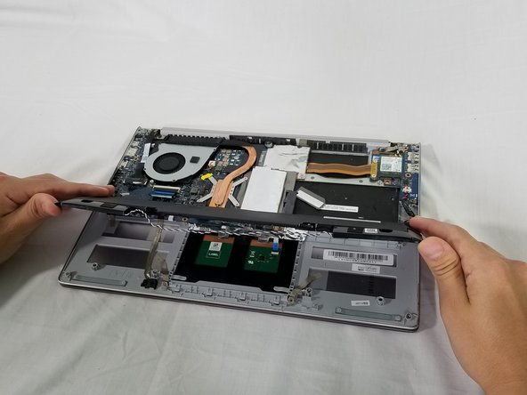

    • Lift and remove the back cover.
    • If your case does not easily come free, you may need to remove screws under the plastic feet on the bottom case.
