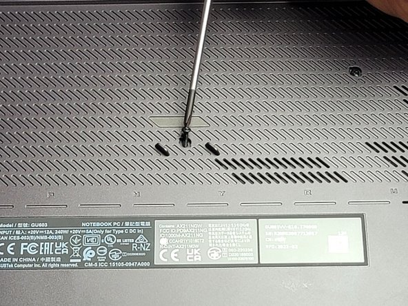

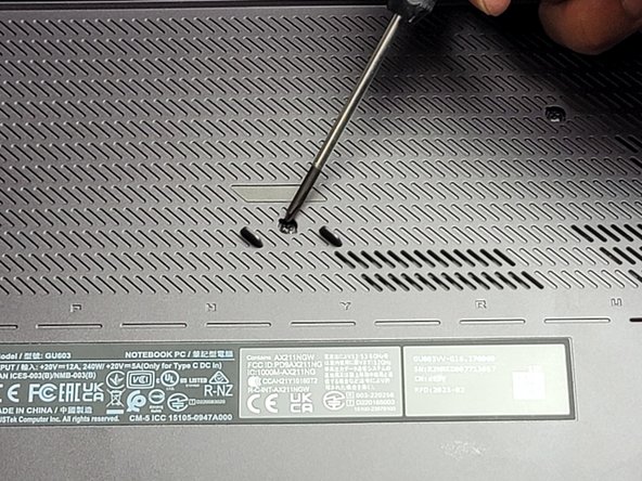

    • Remove the three rubber covers for the middle screws.
    • These rubber covers have a tendency to fly off when being removed.

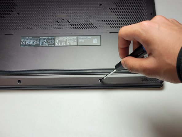

    • Remove the three 8 mm Phillips screws.

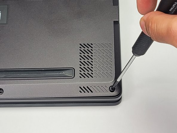

    • Remove the four 11 mm Phillips screws.
    • Remove the center two 11.5 mm Phillips screws.

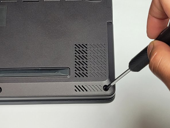

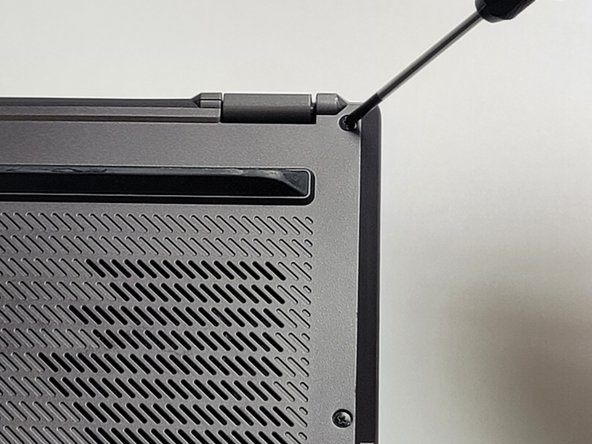

  6. Asus ROG Zephyrus G16 GU603VV SSD Replacement: crwdns2935265:06crwdnd2935265:01crwdnd2935265:03crwdne2935265:0 Asus ROG Zephyrus G16 GU603VV SSD Replacement: crwdns2935265:06crwdnd2935265:02crwdnd2935265:03crwdne2935265:0 Asus ROG Zephyrus G16 GU603VV SSD Replacement: crwdns2935265:06crwdnd2935265:03crwdnd2935265:03crwdne2935265:0

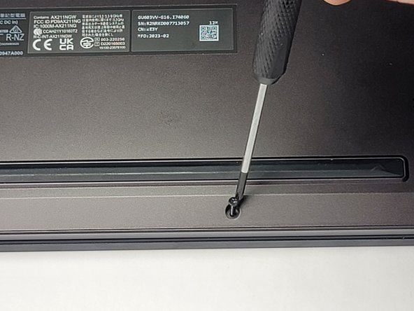

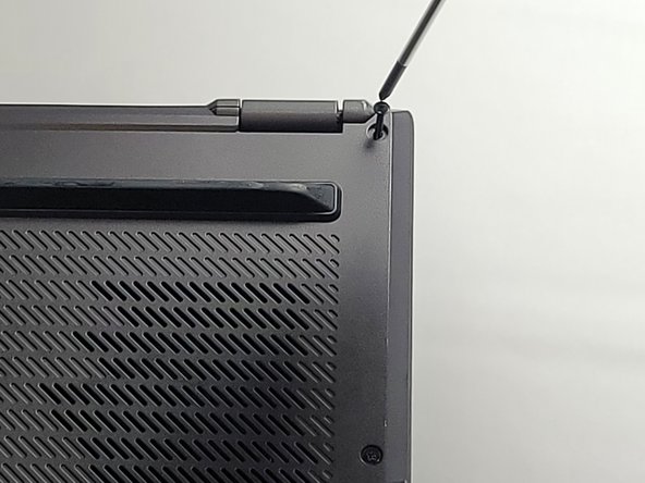

    • Loosen the 8 mm Phillips captive screw in the bottom right corner.
    • The screw will not be removed entirely; it is a captive screw.

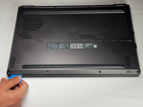

  7. Asus ROG Zephyrus G16 GU603VV SSD Replacement: crwdns2935265:07crwdnd2935265:01crwdnd2935265:03crwdne2935265:0 Asus ROG Zephyrus G16 GU603VV SSD Replacement: crwdns2935265:07crwdnd2935265:02crwdnd2935265:03crwdne2935265:0 Asus ROG Zephyrus G16 GU603VV SSD Replacement: crwdns2935265:07crwdnd2935265:03crwdnd2935265:03crwdne2935265:0

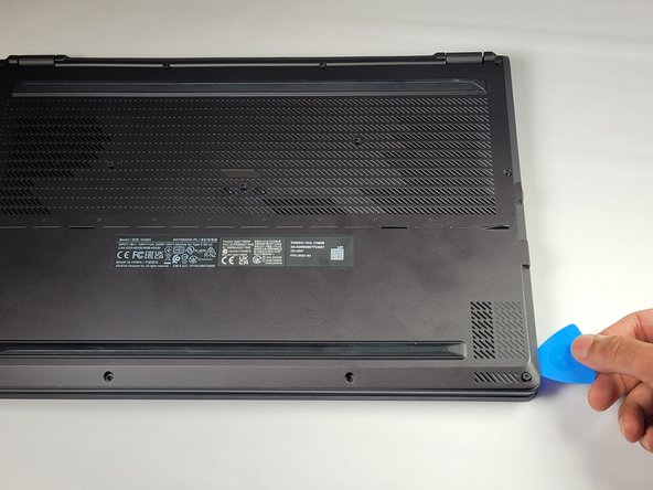

    • Shimmy your pick into the seam opened up by loosening the retaining screw.
    • Gently move your pick clockwise around the edge of the device in the seam between the cover and the laptop to loosen the cover plate.

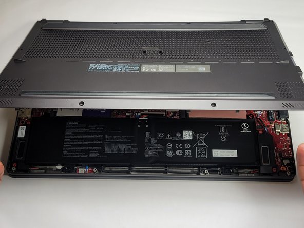

  8. Asus ROG Zephyrus G16 GU603VV SSD Replacement: crwdns2935265:08crwdnd2935265:01crwdnd2935265:03crwdne2935265:0 Asus ROG Zephyrus G16 GU603VV SSD Replacement: crwdns2935265:08crwdnd2935265:02crwdnd2935265:03crwdne2935265:0 Asus ROG Zephyrus G16 GU603VV SSD Replacement: crwdns2935265:08crwdnd2935265:03crwdnd2935265:03crwdne2935265:0
    • Gently remove the lower case.

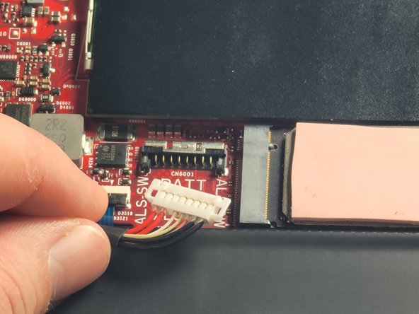

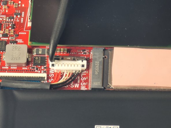

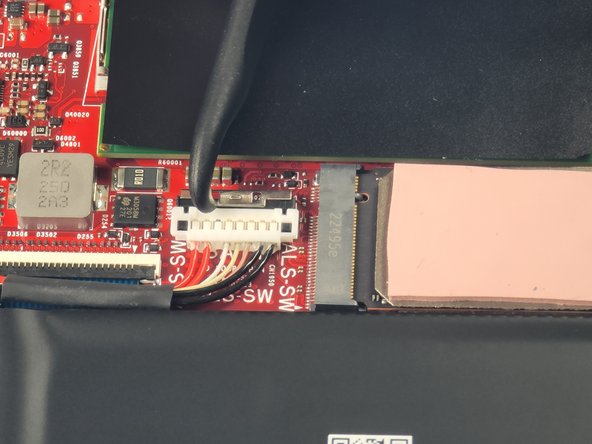

    • Slide the battery connector latch upwards to free the battery cable for removal.
  10. Asus ROG Zephyrus G16 GU603VV SSD Replacement: crwdns2935265:010crwdnd2935265:01crwdnd2935265:02crwdne2935265:0 Asus ROG Zephyrus G16 GU603VV SSD Replacement: crwdns2935265:010crwdnd2935265:02crwdnd2935265:02crwdne2935265:0
    • Remove the battery connector by lifting it up and away from the board.

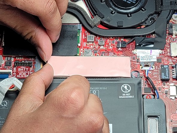

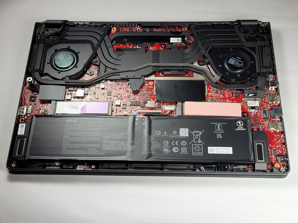

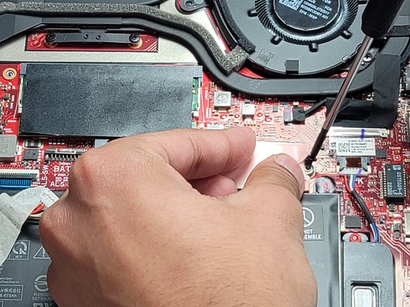

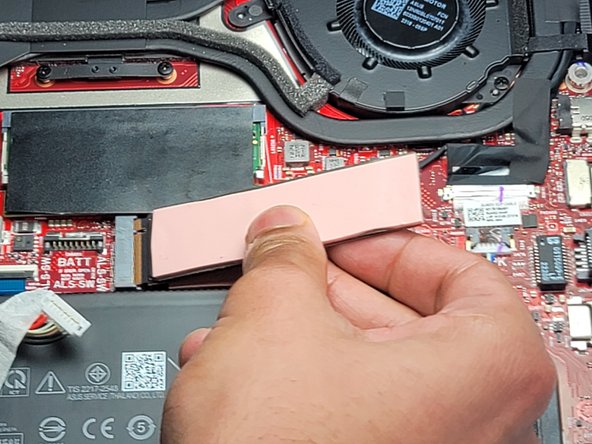

    • Lift the right edge of the protective thermal pad on top of the old SSD and remove the screw underneath.
    • Disconnect the SSD by gently pushing it to the right.
    • Remove the SSD.
  12. Asus ROG Zephyrus G16 GU603VV SSD Replacement: crwdns2935265:012crwdnd2935265:01crwdnd2935265:02crwdne2935265:0 Asus ROG Zephyrus G16 GU603VV SSD Replacement: crwdns2935265:012crwdnd2935265:02crwdnd2935265:02crwdne2935265:0
    • Insert the replacement SSD and screw it into place.
