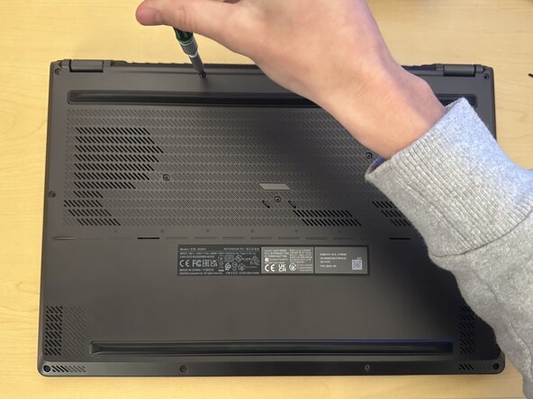

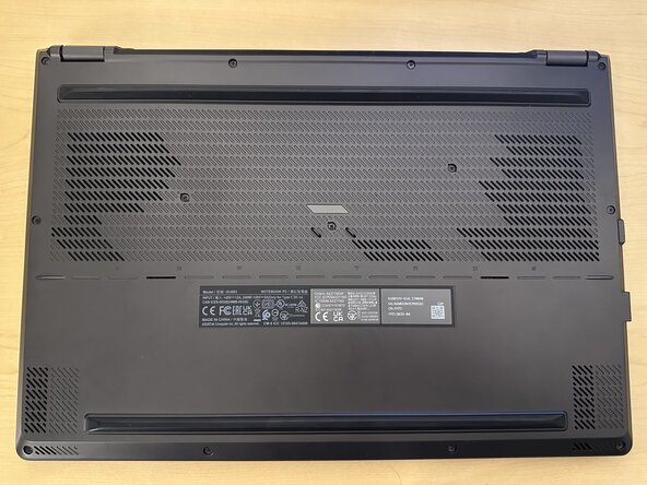

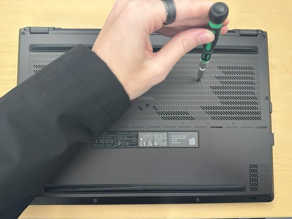

    • Flip the laptop so the front faces you.
  2. Asus ROG Zephryrus G16 GU603 Battery Replacement: crwdns2935265:02crwdnd2935265:01crwdnd2935265:03crwdne2935265:0 Asus ROG Zephryrus G16 GU603 Battery Replacement: crwdns2935265:02crwdnd2935265:02crwdnd2935265:03crwdne2935265:0 Asus ROG Zephryrus G16 GU603 Battery Replacement: crwdns2935265:02crwdnd2935265:03crwdnd2935265:03crwdne2935265:0

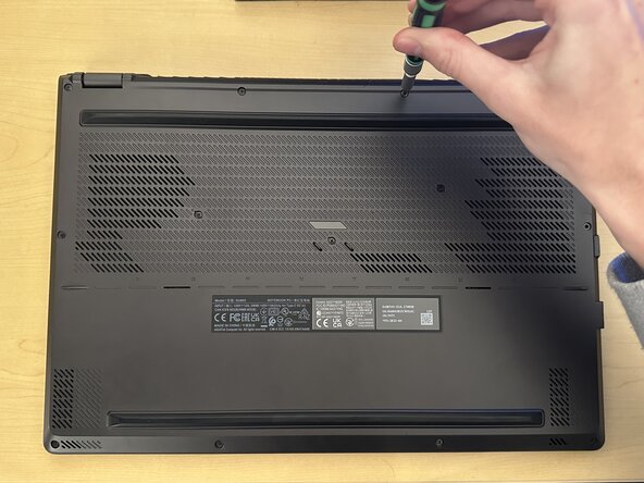

    • Remove the Phillips #0 screws from the bottom casing.
    • Six 8.0 mm-long screws
    • Three 6.0 mm-long screws
    • The screw in the bottom right corner is captive and should not be removed. Unscrew it as much as possible without forcing it out.

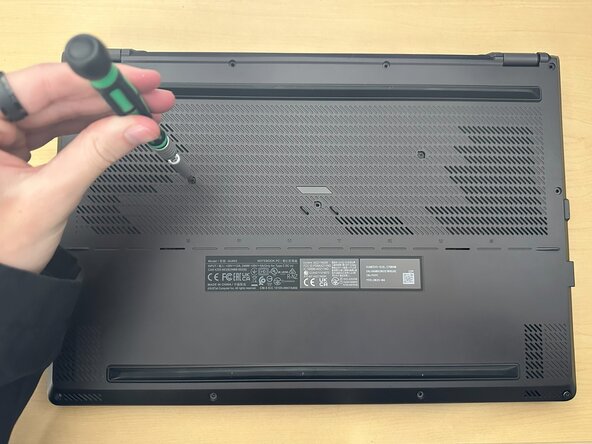

  3. Asus ROG Zephryrus G16 GU603 Battery Replacement: crwdns2935265:03crwdnd2935265:01crwdnd2935265:03crwdne2935265:0 Asus ROG Zephryrus G16 GU603 Battery Replacement: crwdns2935265:03crwdnd2935265:02crwdnd2935265:03crwdne2935265:0 Asus ROG Zephryrus G16 GU603 Battery Replacement: crwdns2935265:03crwdnd2935265:03crwdnd2935265:03crwdne2935265:0
    • Use a Phillips #0 screwdriver to remove the three 6.0 mm screws located in the center bottom of the laptop.

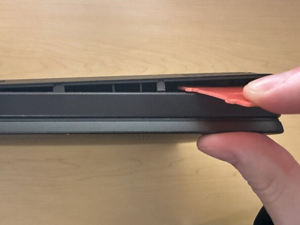

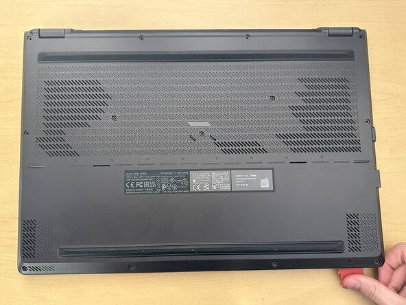

  4. Asus ROG Zephryrus G16 GU603 Battery Replacement: crwdns2935265:04crwdnd2935265:01crwdnd2935265:03crwdne2935265:0 Asus ROG Zephryrus G16 GU603 Battery Replacement: crwdns2935265:04crwdnd2935265:02crwdnd2935265:03crwdne2935265:0 Asus ROG Zephryrus G16 GU603 Battery Replacement: crwdns2935265:04crwdnd2935265:03crwdnd2935265:03crwdne2935265:0
    • Insert an opening pick or tool into the bottom right corner of the laptop and gently pry open the bottom casing.
    • Avoid using metal tools, as they can damage the casing or internal components.
  5. Asus ROG Zephryrus G16 GU603 Battery Replacement: crwdns2935265:05crwdnd2935265:01crwdnd2935265:03crwdne2935265:0 Asus ROG Zephryrus G16 GU603 Battery Replacement: crwdns2935265:05crwdnd2935265:02crwdnd2935265:03crwdne2935265:0 Asus ROG Zephryrus G16 GU603 Battery Replacement: crwdns2935265:05crwdnd2935265:03crwdnd2935265:03crwdne2935265:0

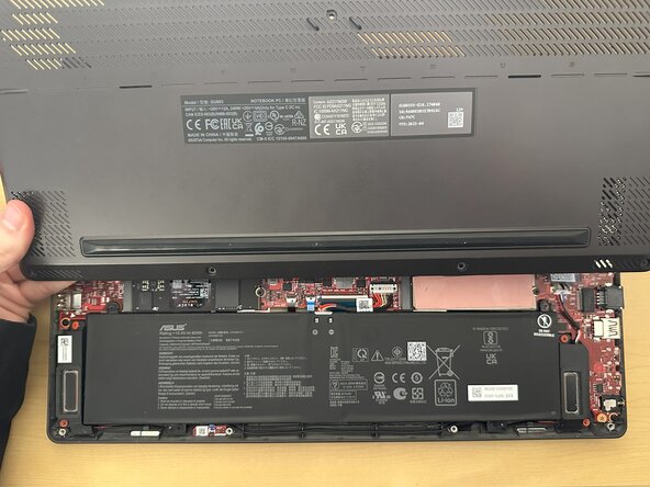

    • Lift the bottom casing from the device to remove it.

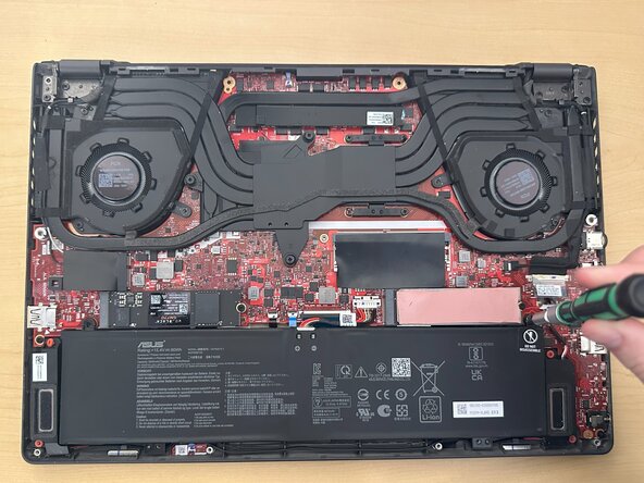

  6. Asus ROG Zephryrus G16 GU603 Battery Replacement: crwdns2935265:06crwdnd2935265:01crwdnd2935265:03crwdne2935265:0 Asus ROG Zephryrus G16 GU603 Battery Replacement: crwdns2935265:06crwdnd2935265:02crwdnd2935265:03crwdne2935265:0 Asus ROG Zephryrus G16 GU603 Battery Replacement: crwdns2935265:06crwdnd2935265:03crwdnd2935265:03crwdne2935265:0

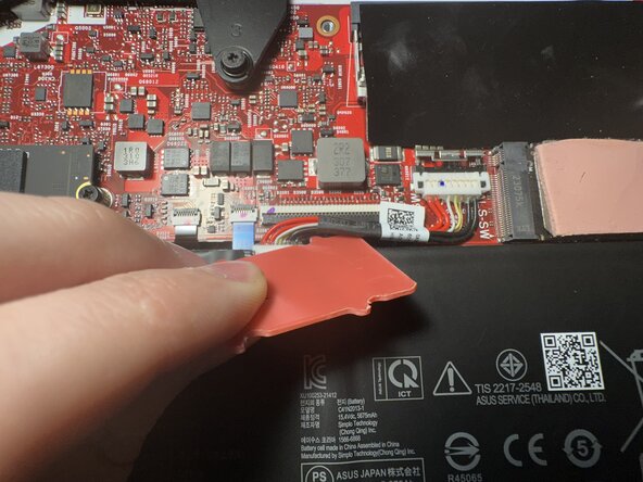

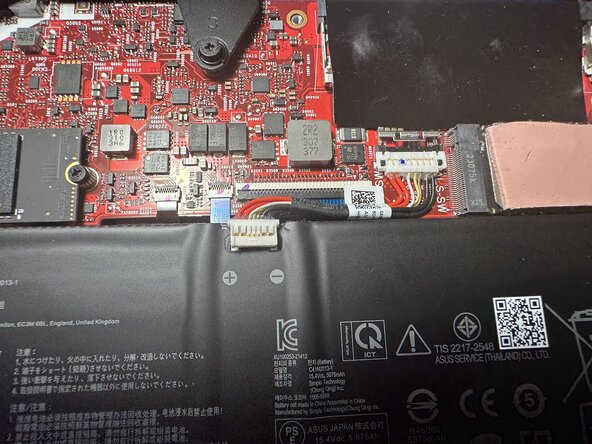

    • Use a plastic opening pick to pry the battery cable upward and disconnect it from the battery.
    • Be gentle when prying to avoid damaging the cable or connector.

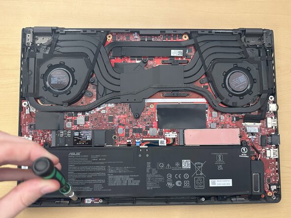

  7. Asus ROG Zephryrus G16 GU603 Battery Replacement: crwdns2935265:07crwdnd2935265:01crwdnd2935265:03crwdne2935265:0 Asus ROG Zephryrus G16 GU603 Battery Replacement: crwdns2935265:07crwdnd2935265:02crwdnd2935265:03crwdne2935265:0 Asus ROG Zephryrus G16 GU603 Battery Replacement: crwdns2935265:07crwdnd2935265:03crwdnd2935265:03crwdne2935265:0
    • Remove the four Phillips #0 screws securing the battery.
    • Two 6.0 mm-long screws
    • Two 3.0 mm-long screws

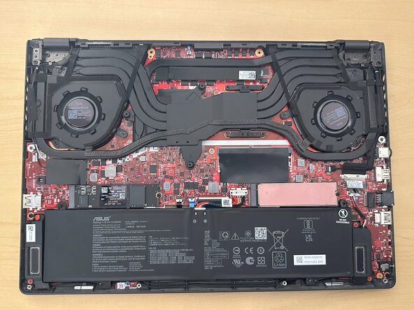

  8. Asus ROG Zephryrus G16 GU603 Battery Replacement: crwdns2935265:08crwdnd2935265:01crwdnd2935265:01crwdne2935265:0
    • Remove the old battery and set it aside.
