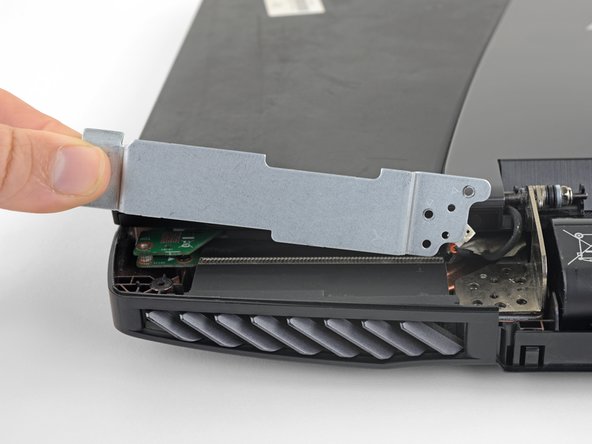

  24. Asus ROG G751JL-BB17T29 Battery Replacement: crwdns2935265:024crwdnd2935265:01crwdnd2935265:02crwdne2935265:0 Asus ROG G751JL-BB17T29 Battery Replacement: crwdns2935265:024crwdnd2935265:02crwdnd2935265:02crwdne2935265:0
    • Lift up and remove the two metal display brackets.

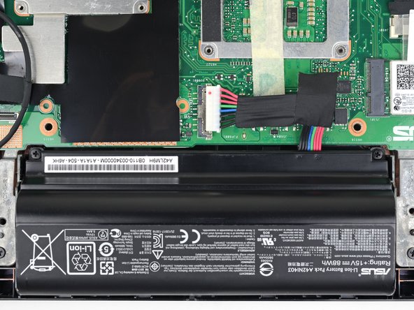

  26. Asus ROG G751JL-BB17T29 Battery Replacement, Remove the battery: crwdns2935265:026crwdnd2935265:01crwdnd2935265:02crwdne2935265:0 Asus ROG G751JL-BB17T29 Battery Replacement, Remove the battery: crwdns2935265:026crwdnd2935265:02crwdnd2935265:02crwdne2935265:0
    • Remove the two 5.7 mm Phillips #00 screws securing the battery.
  27. Asus ROG G751JL-BB17T29 Battery Replacement: crwdns2935265:027crwdnd2935265:01crwdnd2935265:01crwdne2935265:0
    • Lift the battery out of its compartment and remove it.
    • You may need to move the battery away from the motherboard to free the battery tabs.
