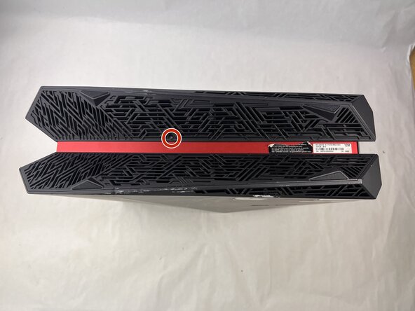

      • Remove each of the two 4.6 mm Phillips screws on the top and bottom of the tower.
