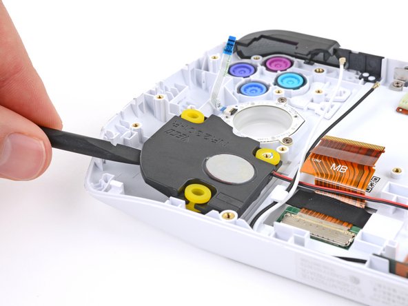

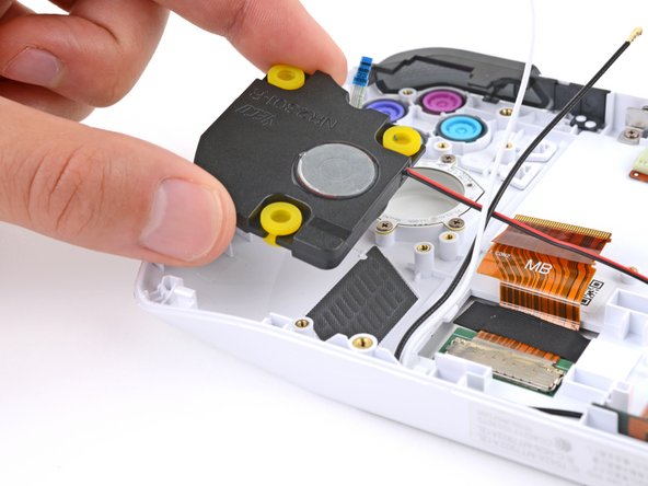

  42. Asus ROG Ally Speakers Replacement, Pry up the speakers: crwdns2935265:042crwdnd2935265:01crwdnd2935265:03crwdne2935265:0 Asus ROG Ally Speakers Replacement, Pry up the speakers: crwdns2935265:042crwdnd2935265:02crwdnd2935265:03crwdne2935265:0 Asus ROG Ally Speakers Replacement, Pry up the speakers: crwdns2935265:042crwdnd2935265:03crwdnd2935265:03crwdne2935265:0
    • Yellow rubber grommets secure the speakers in place over their screw posts.
    • Insert the flat end of a spudger between the outer edge of one of the speakers and the chassis.
    • Pry the speaker up and remove it.
