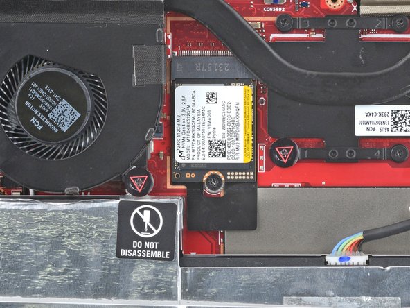

    1. Asus ROG Ally SSD Replacement, Unfasten the SSD: crwdns2935265:09crwdnd2935265:01crwdnd2935265:02crwdne2935265:0 Asus ROG Ally SSD Replacement, Unfasten the SSD: crwdns2935265:09crwdnd2935265:02crwdnd2935265:02crwdne2935265:0
      • Use a Phillips #0 screwdriver to remove the 3.4 mm‑long screw securing the SSD.

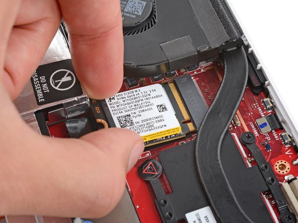

    2. Asus ROG Ally SSD Replacement, Remove the SSD: crwdns2935265:010crwdnd2935265:01crwdnd2935265:02crwdne2935265:0 Asus ROG Ally SSD Replacement, Remove the SSD: crwdns2935265:010crwdnd2935265:02crwdnd2935265:02crwdne2935265:0
      • If you have trouble removing the SSD, you can remove the battery for easier access.
      • Grip the bottom corners of the SSD and slightly lift until it clears the screw post.
      • Do not lift more than this or you may damage the SSD and its socket.
      • Pull the SSD straight out of its socket and remove it.
