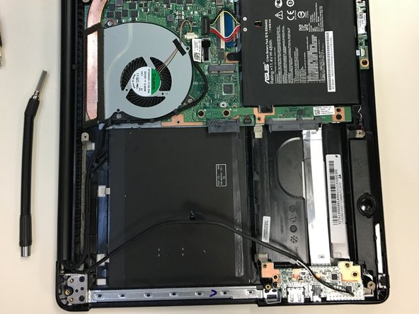

    • Start by removing the 10 screws on the back of the laptop with a Phillips head 1 screw driver.
    • Remove back cover.
  2. Asus Q552UB-BHI7T12 Disk Drive Replacement: crwdns2935265:02crwdnd2935265:01crwdnd2935265:01crwdne2935265:0
    • the battery must be removed so there is no power running to the disk drive. Follow the battery replacement guide here.
  3. Asus Q552UB-BHI7T12 Disk Drive Replacement: crwdns2935265:03crwdnd2935265:01crwdnd2935265:01crwdne2935265:0
    • Unscrew the one screw on the disk drive with a Philips head screw driver 1.
  4. Asus Q552UB-BHI7T12 Disk Drive Replacement: crwdns2935265:04crwdnd2935265:01crwdnd2935265:02crwdne2935265:0 Asus Q552UB-BHI7T12 Disk Drive Replacement: crwdns2935265:04crwdnd2935265:02crwdnd2935265:02crwdne2935265:0
    • Slowly slide out the disk drive.
