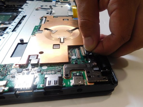

  5. Asus L410MA-MH09-CA Keyboard Replacement, Keyboard: crwdns2935265:05crwdnd2935265:01crwdnd2935265:01crwdne2935265:0
    • Use a Phillips #1 screwdriver to remove the screws that secure the hinges.
    • Lift the hinges up and out.
  6. Asus L410MA-MH09-CA Keyboard Replacement: crwdns2935265:06crwdnd2935265:01crwdnd2935265:02crwdne2935265:0 Asus L410MA-MH09-CA Keyboard Replacement: crwdns2935265:06crwdnd2935265:02crwdnd2935265:02crwdne2935265:0
    • Disconnect the battery and display connectors.

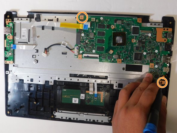

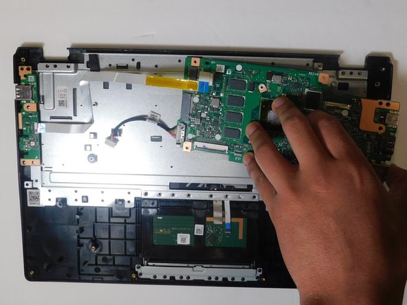

  7. Asus L410MA-MH09-CA Keyboard Replacement: crwdns2935265:07crwdnd2935265:01crwdnd2935265:03crwdne2935265:0 Asus L410MA-MH09-CA Keyboard Replacement: crwdns2935265:07crwdnd2935265:02crwdnd2935265:03crwdne2935265:0 Asus L410MA-MH09-CA Keyboard Replacement: crwdns2935265:07crwdnd2935265:03crwdnd2935265:03crwdne2935265:0
    • Remove the four 4 mm Phillips #1 screws that secure the heatsink.
    • Remove the heatsink.
    • Remove the remaining two 4 mm Phillips #1 screws that secure the motherboard.
    • Remove the motherboard.

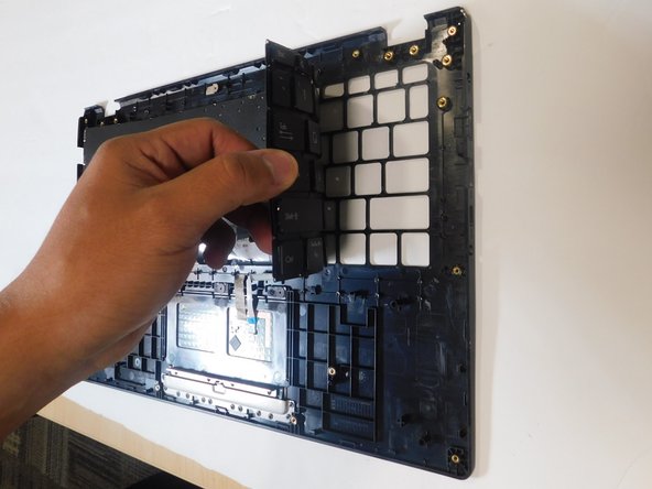

  9. Asus L410MA-MH09-CA Keyboard Replacement: crwdns2935265:09crwdnd2935265:01crwdnd2935265:02crwdne2935265:0 Asus L410MA-MH09-CA Keyboard Replacement: crwdns2935265:09crwdnd2935265:02crwdnd2935265:02crwdne2935265:0
    • Carefully disconnect the wide blue ribbon cable.
    • Remove the keyboard.
