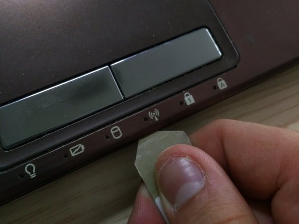

    • remove battery by sliding the two release buttons to the right position.
    • slide the battery away from the laptop

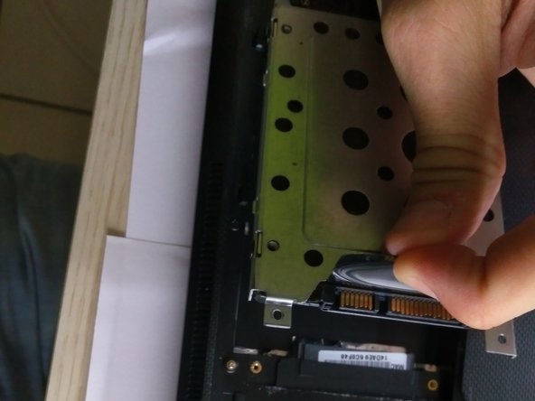

  5. Asus K53S -X156V Thermal Paste Replacement, removing hard disk: crwdns2935265:05crwdnd2935265:01crwdnd2935265:03crwdne2935265:0 Asus K53S -X156V Thermal Paste Replacement, removing hard disk: crwdns2935265:05crwdnd2935265:02crwdnd2935265:03crwdne2935265:0 Asus K53S -X156V Thermal Paste Replacement, removing hard disk: crwdns2935265:05crwdnd2935265:03crwdnd2935265:03crwdne2935265:0
    • remove the 4 screws holding the metal frame , holding the hdd to it's place.
    • slide the frame and hard disk away from the case.

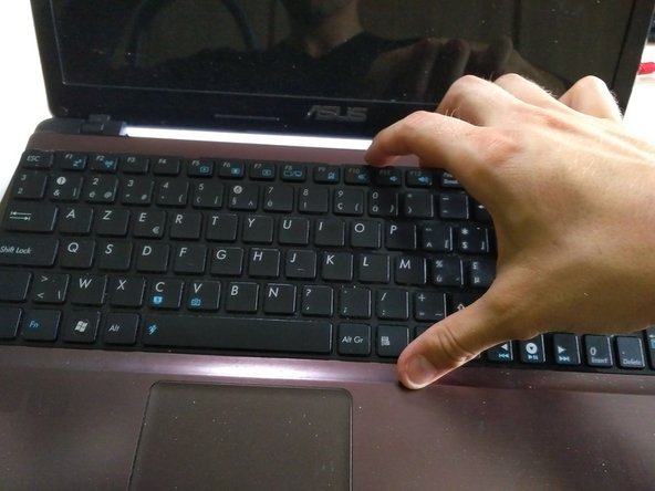

  6. Asus K53S -X156V Thermal Paste Replacement, removing keyboard: crwdns2935265:06crwdnd2935265:01crwdnd2935265:02crwdne2935265:0 Asus K53S -X156V Thermal Paste Replacement, removing keyboard: crwdns2935265:06crwdnd2935265:02crwdnd2935265:02crwdne2935265:0
    • click the keyboard loose . There are 5 clips to remove

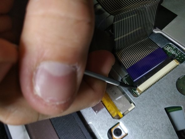

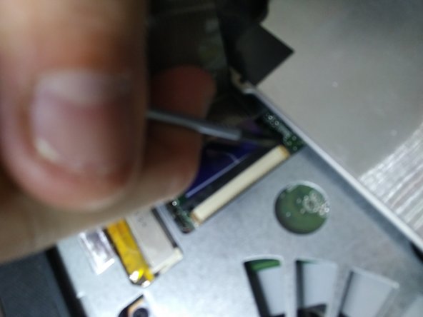

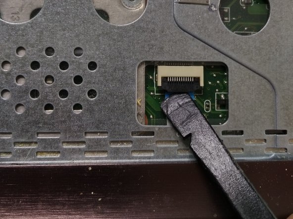

  7. Asus K53S -X156V Thermal Paste Replacement, keyboard second part: crwdns2935265:07crwdnd2935265:01crwdnd2935265:03crwdne2935265:0 Asus K53S -X156V Thermal Paste Replacement, keyboard second part: crwdns2935265:07crwdnd2935265:02crwdnd2935265:03crwdne2935265:0 Asus K53S -X156V Thermal Paste Replacement, keyboard second part: crwdns2935265:07crwdnd2935265:03crwdnd2935265:03crwdne2935265:0
    • be carefull with the flat cable from the keyboard.
    • use a spudger to click the connector lid loose.
    • i used the tip of a screwdriver.. but i know what i am doing.. if you are use to work on laptops you can use a screwdriver, if not use a plastic spudger.

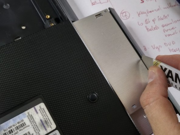

  8. Asus K53S -X156V Thermal Paste Replacement, remove DVD bay: crwdns2935265:08crwdnd2935265:01crwdnd2935265:03crwdne2935265:0 Asus K53S -X156V Thermal Paste Replacement, remove DVD bay: crwdns2935265:08crwdnd2935265:02crwdnd2935265:03crwdne2935265:0 Asus K53S -X156V Thermal Paste Replacement, remove DVD bay: crwdns2935265:08crwdnd2935265:03crwdnd2935265:03crwdne2935265:0
    • remove the screw hidden under the keyboard.
    • slide the dvd bay out.

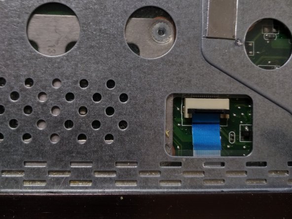

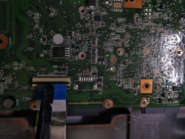

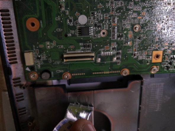

  9. Asus K53S -X156V Thermal Paste Replacement, removing flat cables: crwdns2935265:09crwdnd2935265:01crwdnd2935265:03crwdne2935265:0 Asus K53S -X156V Thermal Paste Replacement, removing flat cables: crwdns2935265:09crwdnd2935265:02crwdnd2935265:03crwdne2935265:0 Asus K53S -X156V Thermal Paste Replacement, removing flat cables: crwdns2935265:09crwdnd2935265:03crwdnd2935265:03crwdne2935265:0
    • remove the flat thin cables from there sockets.
    • use a spudger , click the lid upwards and slide the flat cable out.

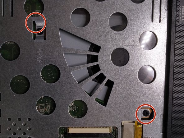

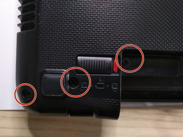

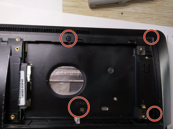

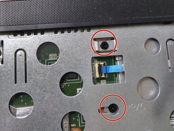

    • remove the 6 screws ( m2x6) holding the metal plate to the case.
  11. Asus K53S -X156V Thermal Paste Replacement, remove screws on the bottom plate: crwdns2935265:011crwdnd2935265:01crwdnd2935265:03crwdne2935265:0 Asus K53S -X156V Thermal Paste Replacement, remove screws on the bottom plate: crwdns2935265:011crwdnd2935265:02crwdnd2935265:03crwdne2935265:0 Asus K53S -X156V Thermal Paste Replacement, remove screws on the bottom plate: crwdns2935265:011crwdnd2935265:03crwdnd2935265:03crwdne2935265:0
    • remove screws as shown in pictures.

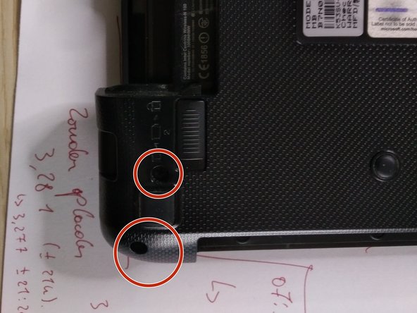

  12. Asus K53S -X156V Thermal Paste Replacement, remove screws bottom plate: crwdns2935265:012crwdnd2935265:01crwdnd2935265:03crwdne2935265:0 Asus K53S -X156V Thermal Paste Replacement, remove screws bottom plate: crwdns2935265:012crwdnd2935265:02crwdnd2935265:03crwdne2935265:0 Asus K53S -X156V Thermal Paste Replacement, remove screws bottom plate: crwdns2935265:012crwdnd2935265:03crwdnd2935265:03crwdne2935265:0

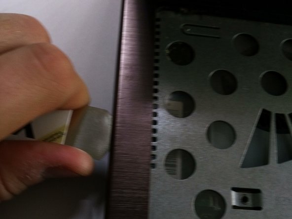

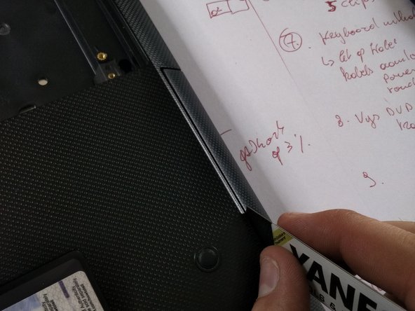

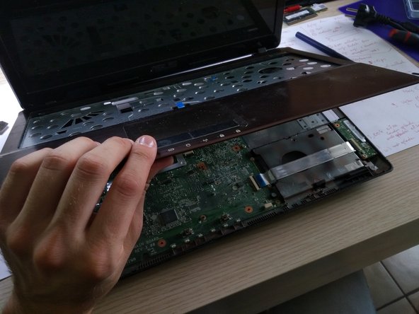

  13. Asus K53S -X156V Thermal Paste Replacement, removing case: crwdns2935265:013crwdnd2935265:01crwdnd2935265:03crwdne2935265:0 Asus K53S -X156V Thermal Paste Replacement, removing case: crwdns2935265:013crwdnd2935265:02crwdnd2935265:03crwdne2935265:0 Asus K53S -X156V Thermal Paste Replacement, removing case: crwdns2935265:013crwdnd2935265:03crwdnd2935265:03crwdne2935265:0
    • slide an isesamo opening tool between the two plates. you will here clicks

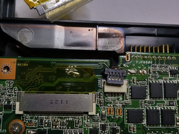

  14. Asus K53S -X156V Thermal Paste Replacement, reveal MAIN PCB: crwdns2935265:014crwdnd2935265:01crwdnd2935265:03crwdne2935265:0 Asus K53S -X156V Thermal Paste Replacement, reveal MAIN PCB: crwdns2935265:014crwdnd2935265:02crwdnd2935265:03crwdne2935265:0 Asus K53S -X156V Thermal Paste Replacement, reveal MAIN PCB: crwdns2935265:014crwdnd2935265:03crwdnd2935265:03crwdne2935265:0
    • remove upper plate , revealing the main PCB.
  15. Asus K53S -X156V Thermal Paste Replacement, removing cable to usb module: crwdns2935265:015crwdnd2935265:01crwdnd2935265:03crwdne2935265:0 Asus K53S -X156V Thermal Paste Replacement, removing cable to usb module: crwdns2935265:015crwdnd2935265:02crwdnd2935265:03crwdne2935265:0 Asus K53S -X156V Thermal Paste Replacement, removing cable to usb module: crwdns2935265:015crwdnd2935265:03crwdnd2935265:03crwdne2935265:0
    • remove the flat cable of the USB module , use a spudger to lift up the lid of the connector.
    • gently slide out the flat cable
    • when removing the cable, be carefull they used a lot of adhessive to paste the cable to the plastic case.

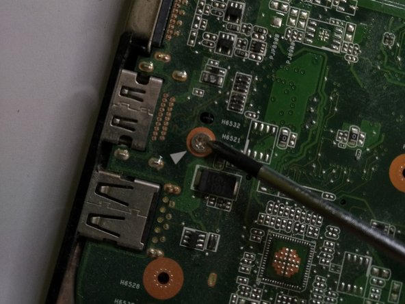

  18. Asus K53S -X156V Thermal Paste Replacement, remove screws main board: crwdns2935265:018crwdnd2935265:01crwdnd2935265:03crwdne2935265:0 Asus K53S -X156V Thermal Paste Replacement, remove screws main board: crwdns2935265:018crwdnd2935265:02crwdnd2935265:03crwdne2935265:0 Asus K53S -X156V Thermal Paste Replacement, remove screws main board: crwdns2935265:018crwdnd2935265:03crwdnd2935265:03crwdne2935265:0
    • remove the 4 screws holding the main pcb ..

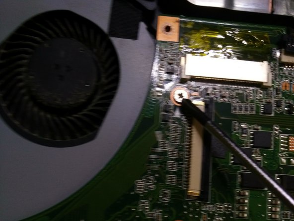

  19. Asus K53S -X156V Thermal Paste Replacement, removing last screw.: crwdns2935265:019crwdnd2935265:01crwdnd2935265:01crwdne2935265:0
    • remove screw holding the fan tot the laptop.

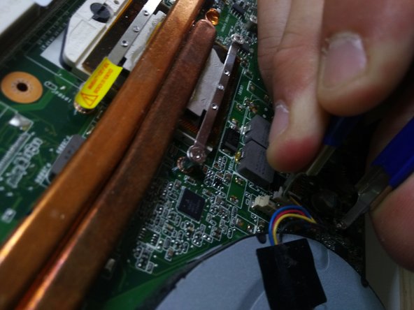

  21. Asus K53S -X156V Thermal Paste Replacement, FAN: crwdns2935265:021crwdnd2935265:01crwdnd2935265:02crwdne2935265:0 Asus K53S -X156V Thermal Paste Replacement, FAN: crwdns2935265:021crwdnd2935265:02crwdnd2935265:02crwdne2935265:0
    • release the fan from the main board by removing the connector with an IC extractor pliers.

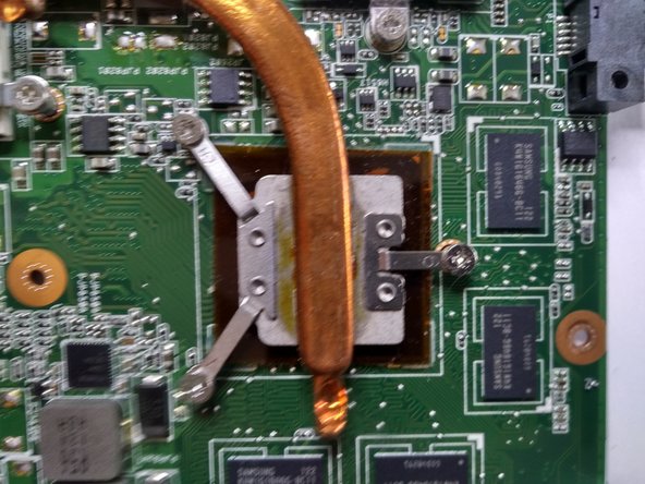

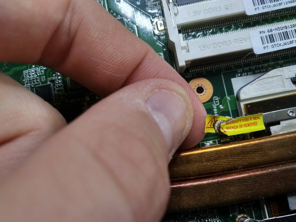

  22. Asus K53S -X156V Thermal Paste Replacement: crwdns2935265:022crwdnd2935265:01crwdnd2935265:03crwdne2935265:0 Asus K53S -X156V Thermal Paste Replacement: crwdns2935265:022crwdnd2935265:02crwdnd2935265:03crwdne2935265:0 Asus K53S -X156V Thermal Paste Replacement: crwdns2935265:022crwdnd2935265:03crwdnd2935265:03crwdne2935265:0
    • loosen up the screws from the cooling pads on the CPU and GPU.
    • You will have to tear the warranty sticker. it is a sticker in 3 parts.
  23. Asus K53S -X156V Thermal Paste Replacement, removing fan and cooling pads: crwdns2935265:023crwdnd2935265:01crwdnd2935265:03crwdne2935265:0 Asus K53S -X156V Thermal Paste Replacement, removing fan and cooling pads: crwdns2935265:023crwdnd2935265:02crwdnd2935265:03crwdne2935265:0 Asus K53S -X156V Thermal Paste Replacement, removing fan and cooling pads: crwdns2935265:023crwdnd2935265:03crwdnd2935265:03crwdne2935265:0
    • remove the fan and cooling pads.
    • you will see the old thermal paste.

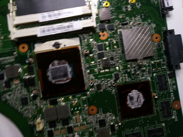

  24. Asus K53S -X156V Thermal Paste Replacement, removing thermal paste from pads.: crwdns2935265:024crwdnd2935265:01crwdnd2935265:02crwdne2935265:0 Asus K53S -X156V Thermal Paste Replacement, removing thermal paste from pads.: crwdns2935265:024crwdnd2935265:02crwdnd2935265:02crwdne2935265:0
    • clean the cooling pads with an very sharp knife. or spudger..
    • wear gloves, cause the thermal paste is very toxic.
    • also this is a good time to blow out the fan with compressed air.

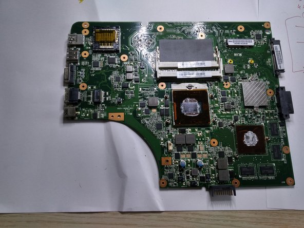

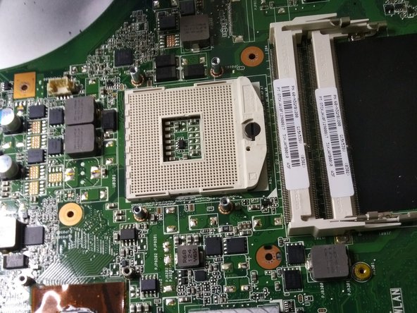

  25. Asus K53S -X156V Thermal Paste Replacement, removing CPU and cleaning: crwdns2935265:025crwdnd2935265:01crwdnd2935265:03crwdne2935265:0 Asus K53S -X156V Thermal Paste Replacement, removing CPU and cleaning: crwdns2935265:025crwdnd2935265:02crwdnd2935265:03crwdne2935265:0 Asus K53S -X156V Thermal Paste Replacement, removing CPU and cleaning: crwdns2935265:025crwdnd2935265:03crwdnd2935265:03crwdne2935265:0
    • remove the old thermal paste from the processors , be very carefull. and use some artic silver liquid to clean them. and easely remove the thermal paste.
    • you can remove the CPU by using a flathead screwdriver , the socket will move and you can pull the CPU out , maybe a good time to upgrade the CPU.
  26. Asus K53S -X156V Thermal Paste Replacement: crwdns2935265:026crwdnd2935265:01crwdnd2935265:01crwdne2935265:0
    • unfortunately i don't have a picture when i added some new thermal paste. But if you do: one drop on each processor is enough.
    • Check out the thermal paste guide for more information on how to apply thermal paste.
