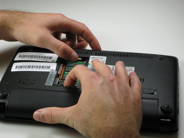

    • Remove the panel covering the RAM.
    • Pull the two RAM retaining arms away from the center of the RAM chip.
    • Gently pull the RAM chip out of its socket.

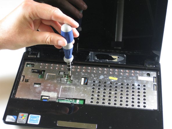

    • Flip the laptop back over and open the display.
    • Remove the six 5.5 mm screws from the metal plate beneath the keyboard.

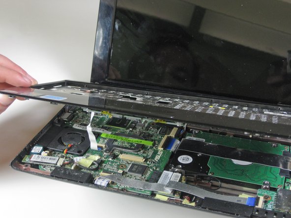

    • Using a plastic opening tool, detach the five plastic clips securing the upper case.
    • There are two small LEDs in the top edge of the lower casing, near the bottom right of the laptop. Be careful not to damage them as you pry open the plastic clips.
    • Carefully lift the upper case and flip it towards the front of the laptop.

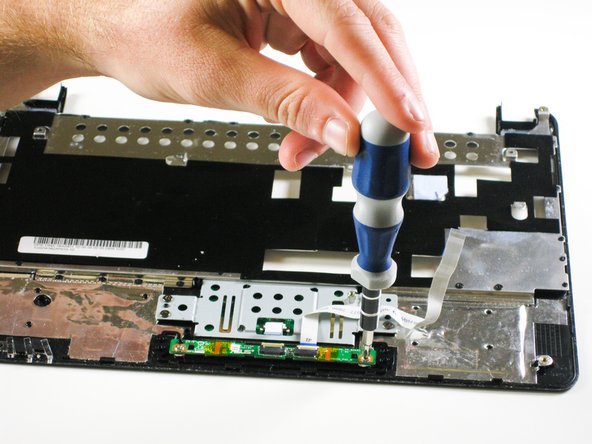

    • Flip up the retaining flap on the button ribbon cable ZIF connector.
    • Pull the button ribbon cable out of its socket.
    • Remove the two 3.6 mm screws from the button assembly.

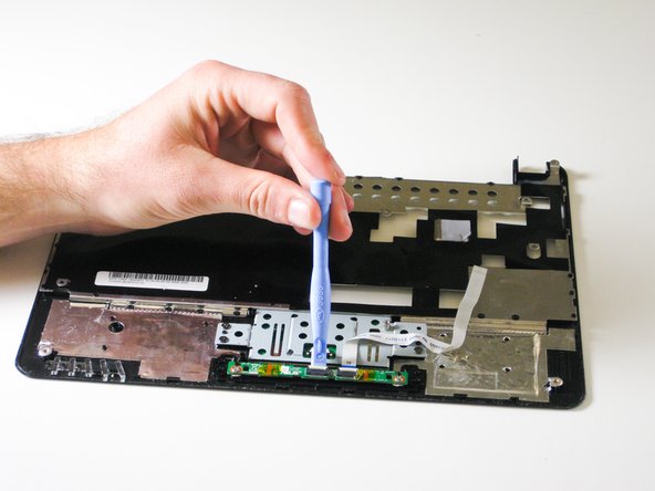

  13. Asus Eee PC 1005HA Trackpad buttons Replacement: crwdns2935265:013crwdnd2935265:01crwdnd2935265:01crwdne2935265:0
    • Remove the trackpad buttons.
