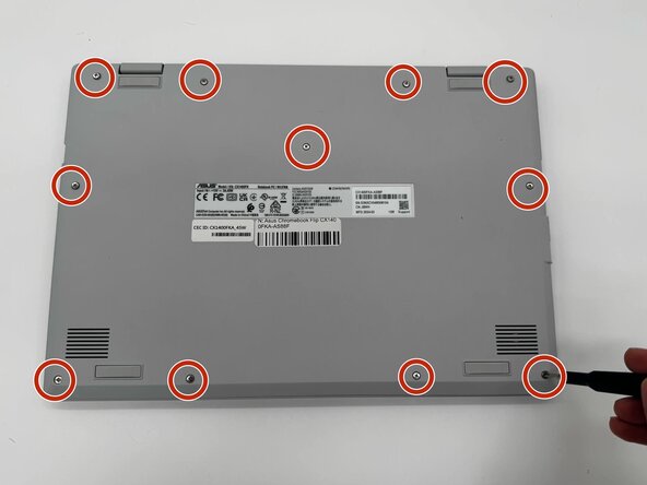

  1. Asus Chromebook Flip CX1400FKA-AS88F Speaker Replacement, Case: crwdns2935265:01crwdnd2935265:01crwdnd2935265:02crwdne2935265:0 Asus Chromebook Flip CX1400FKA-AS88F Speaker Replacement, Case: crwdns2935265:01crwdnd2935265:02crwdnd2935265:02crwdne2935265:0
    • Using a Phillips #0 screwdriver, remove the eleven screws securing the bottom cover of the device.
    • Remove the screws carefully. Applying too much force or working too quickly can strip the screw heads or damage the bottom casing.
    • Keep the screws organized in a safe and clearly labeled area to ensure an easy reinstallation later.

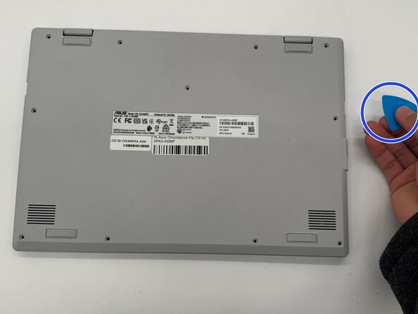

  2. Asus Chromebook Flip CX1400FKA-AS88F Speaker Replacement: crwdns2935265:02crwdnd2935265:01crwdnd2935265:03crwdne2935265:0 Asus Chromebook Flip CX1400FKA-AS88F Speaker Replacement: crwdns2935265:02crwdnd2935265:02crwdnd2935265:03crwdne2935265:0 Asus Chromebook Flip CX1400FKA-AS88F Speaker Replacement: crwdns2935265:02crwdnd2935265:03crwdnd2935265:03crwdne2935265:0
    • Use an iFixit opening tool or nylon spudger to gently separate the bottom cover from the Chromebook.
    • Only use plastic or nylon tools when prying open the case. Metal tools can easily scratch or damage the internal components.
    • Insert the tip of the opening tool into the seam between the top and bottom covers, then slide it along the perimeter to release the internal clips securing the case.
    • Insert opening picks around the edges as you go to prevent the clips from reattaching.
    • Once all clips are released, carefully lift and remove the bottom cover from the device.

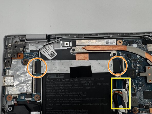

  3. Asus Chromebook Flip CX1400FKA-AS88F Speaker Replacement, Battery: crwdns2935265:03crwdnd2935265:01crwdnd2935265:01crwdne2935265:0
    • Carefully disconnect ribbon cables attached to the motherboard.
    • Also carefully disconnect the fan cables that are connected to the motherboard.
    • For helpful tips on disconnecting cable connectors, refer to the Recognizing and Disconnecting Cable Connectors guide.
    • Do not pull on the cables directly. Always disconnect by gripping the connector to prevent tearing the ribbon or damaging the socket.

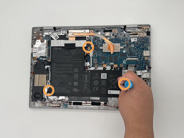

  4. Asus Chromebook Flip CX1400FKA-AS88F Speaker Replacement: crwdns2935265:04crwdnd2935265:01crwdnd2935265:02crwdne2935265:0 Asus Chromebook Flip CX1400FKA-AS88F Speaker Replacement: crwdns2935265:04crwdnd2935265:02crwdnd2935265:02crwdne2935265:0
    • Using a Phillips #0 screwdriver, remove the three 6.4 mm screws securing the metal brackets to the motherboard assembly.
    • Apply gentle, steady pressure when loosening the screws to avoid stripping the heads or damaging the surrounding components.
    • Once the screws are removed, lift and remove the brackets from the device. Keep them in a safe place for reinstallation.

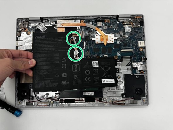

  5. Asus Chromebook Flip CX1400FKA-AS88F Speaker Replacement: crwdns2935265:05crwdnd2935265:01crwdnd2935265:02crwdne2935265:0 Asus Chromebook Flip CX1400FKA-AS88F Speaker Replacement: crwdns2935265:05crwdnd2935265:02crwdnd2935265:02crwdne2935265:0
    • Disconnect the speaker wire connector from the motherboard by gently pulling it straight out of its socket using tweezers or your fingers.
    • Avoid pulling on the wires themselves—grip the plastic connector to prevent damage to the speaker cable or motherboard port.
  6. Asus Chromebook Flip CX1400FKA-AS88F Speaker Replacement, Speaker: crwdns2935265:06crwdnd2935265:01crwdnd2935265:02crwdne2935265:0 Asus Chromebook Flip CX1400FKA-AS88F Speaker Replacement, Speaker: crwdns2935265:06crwdnd2935265:02crwdnd2935265:02crwdne2935265:0
    • Disconnect the speaker wire plug and stickers from the motherboard by gently pulling them out using tweezers or your finger.
    • Caution: Avoid bending or puncturing the battery during removal. Handle it only by the edges and do not pull on any attached cables.
