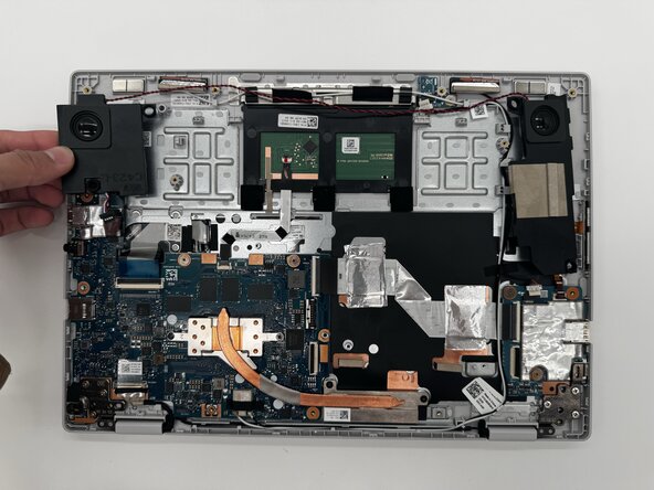

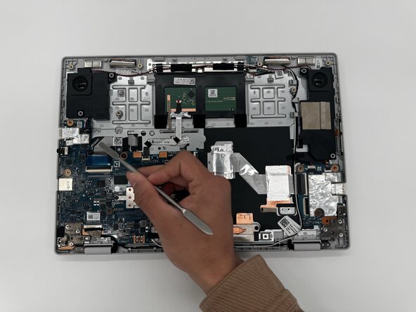

    • Disconnect the speaker wire connector from the motherboard by gently pulling it straight out of its socket using tweezers or your fingers.
    • Caution: Avoid pulling on the wires themselves—grip the plastic connector to prevent damage to the speaker cable or motherboard port.
  6. Asus Chromebook Flip CX1400FKA-AS88F Speaker Replacement, Speaker: crwdns2935265:06crwdnd2935265:01crwdnd2935265:02crwdne2935265:0 Asus Chromebook Flip CX1400FKA-AS88F Speaker Replacement, Speaker: crwdns2935265:06crwdnd2935265:02crwdnd2935265:02crwdne2935265:0

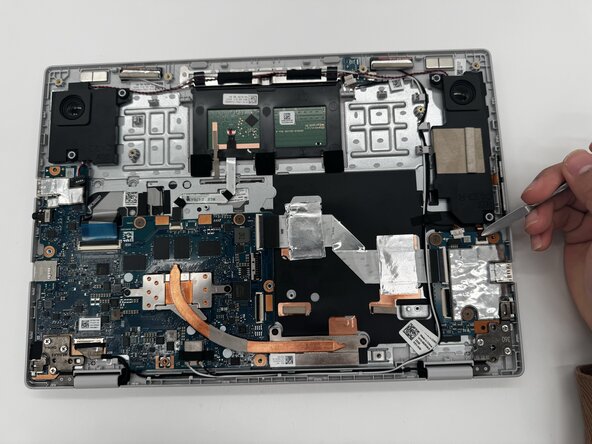

    • Disconnect the speaker wire plug and stickers from the motherboard by gently pulling them out using tweezers or your finger.
    • Caution: Avoid bending or puncturing the battery during removal. Handle it only by the edges and do not pull on any attached cables.
  7. Asus Chromebook Flip CX1400FKA-AS88F Speaker Replacement: crwdns2935265:07crwdnd2935265:01crwdnd2935265:03crwdne2935265:0 Asus Chromebook Flip CX1400FKA-AS88F Speaker Replacement: crwdns2935265:07crwdnd2935265:02crwdnd2935265:03crwdne2935265:0 Asus Chromebook Flip CX1400FKA-AS88F Speaker Replacement: crwdns2935265:07crwdnd2935265:03crwdnd2935265:03crwdne2935265:0
    • Disconnect the speaker wire plug from the motherboard by gently pulling it out using tweezers or your fingers.
To reassemble your device, follow these instructions in reverse order. Take your e-waste to an R2 or e-Stewards certified recycler.
