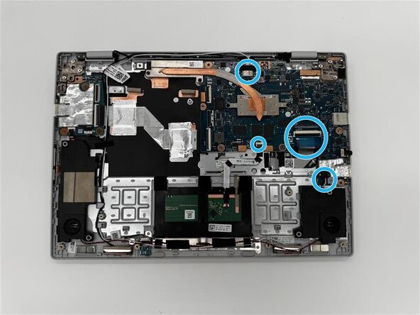

  3. Asus Chromebook Flip CX1400FKA-AS88F Motherboard Replacement, Battery: crwdns2935265:03crwdnd2935265:01crwdnd2935265:01crwdne2935265:0
    • Carefully disconnect ribbon cables attached to the motherboard.
    • Also carefully disconnect the fan cables that are connected to the motherboard.
    • For helpful tips on disconnecting cable connectors, refer to the Recognizing and Disconnecting Cable Connectors guide.
    • Do not pull on the cables directly. Always disconnect by gripping the connector to prevent tearing the ribbon or damaging the socket.

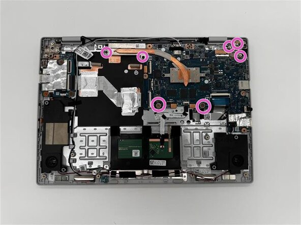

  6. Asus Chromebook Flip CX1400FKA-AS88F Motherboard Replacement, Motherboard: crwdns2935265:06crwdnd2935265:01crwdnd2935265:03crwdne2935265:0 Asus Chromebook Flip CX1400FKA-AS88F Motherboard Replacement, Motherboard: crwdns2935265:06crwdnd2935265:02crwdnd2935265:03crwdne2935265:0 Asus Chromebook Flip CX1400FKA-AS88F Motherboard Replacement, Motherboard: crwdns2935265:06crwdnd2935265:03crwdnd2935265:03crwdne2935265:0
    • Remove all tabs connecting the motherboard to other devices.
    • Unscrew all mounting screws securing the motherboard.
    • Carefully remove the motherboard from the base.
