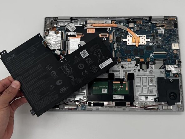

  3. Asus Chromebook Flip CX1400FKA-AS88F Motherboard Replacement, Battery: crwdns2935265:03crwdnd2935265:01crwdnd2935265:01crwdne2935265:0
    • Carefully disconnect ribbon cables and fan connectors attached to the motherboard.
    • Tip: For helpful tips on disconnecting cable connectors, refer to the Recognizing and Disconnecting Cable Connectors guide.
    • Caution: Do not pull on the cables directly. Always disconnect by gripping the connector to prevent tearing the ribbon or damaging the socket.

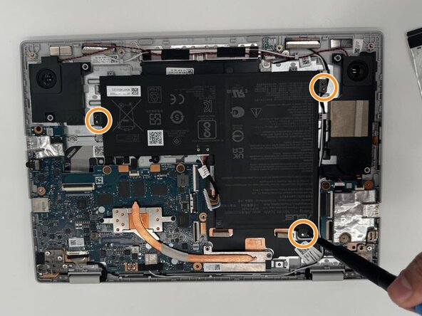

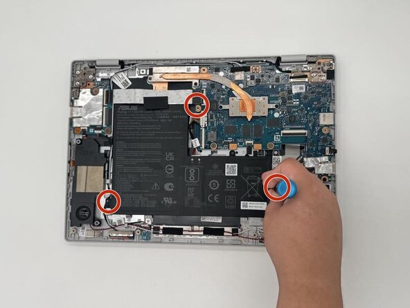

  4. Asus Chromebook Flip CX1400FKA-AS88F Motherboard Replacement: crwdns2935265:04crwdnd2935265:01crwdnd2935265:02crwdne2935265:0 Asus Chromebook Flip CX1400FKA-AS88F Motherboard Replacement: crwdns2935265:04crwdnd2935265:02crwdnd2935265:02crwdne2935265:0
    • Using a Phillips #0 screwdriver, remove the three 6.4 mm screws securing the metal brackets to the motherboard assembly.
    • Caution: Apply gentle, steady pressure when loosening the screws to avoid stripping the heads or damaging the surrounding components.
    • Once the screws are removed, lift and remove the brackets from the device. Keep them in a safe place for reinstallation.

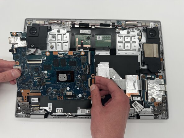

  6. Asus Chromebook Flip CX1400FKA-AS88F Motherboard Replacement, Motherboard: crwdns2935265:06crwdnd2935265:01crwdnd2935265:02crwdne2935265:0 Asus Chromebook Flip CX1400FKA-AS88F Motherboard Replacement, Motherboard: crwdns2935265:06crwdnd2935265:02crwdnd2935265:02crwdne2935265:0
    • Remove all tabs connecting the motherboard to other devices.
    • Unscrew all mounting screws securing the motherboard.
    • Carefully remove the motherboard from the base.
