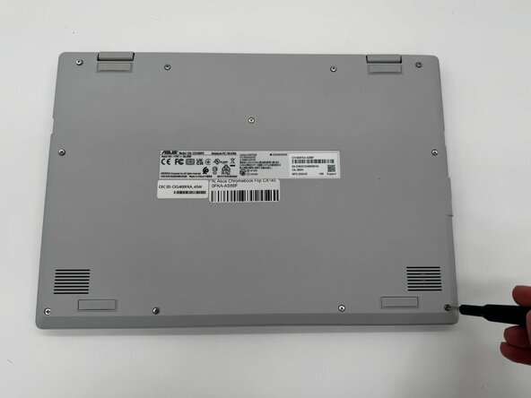

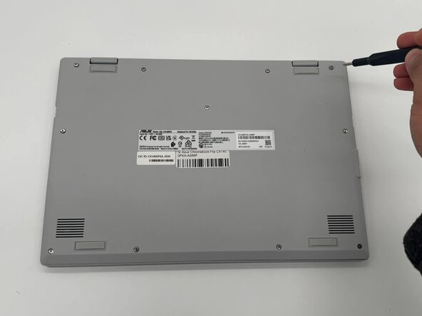

    • Using a Phillips #0 screwdriver, remove the eleven screws securing the bottom cover of the device.
    • Caution: Remove the screws carefully. Applying too much force or working too quickly can strip the screw heads or damage the bottom casing.
    • Tip: Keep the screws organized in a safe and clearly labeled area to ensure an easy reinstallation later.

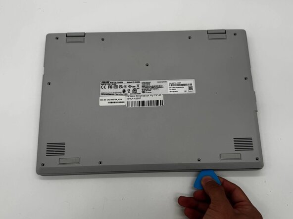

    • Use an iFixit opening tool or nylon spudger to gently separate the bottom cover from the Chromebook.
    • Caution: Only use plastic or nylon tools when prying open the case. Metal tools can easily scratch or damage the internal components.
    • Insert the tip of the opening tool into the seam between the top and bottom covers, then slide it along the perimeter to release the internal clips securing the case.
    • Tip: Insert opening picks around the edges as you go to prevent the clips from reattaching.

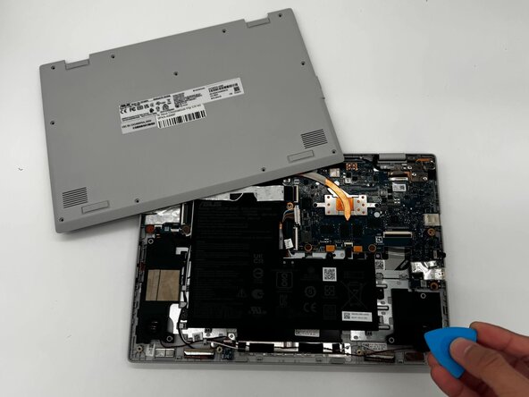

    • Once all clips are released, carefully lift and remove the bottom cover from the device.
