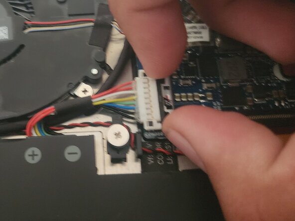

    • Slide the white lock that connects the battery to the motherboard backward. Then, lift the connector out of the socket on the motherboard.
