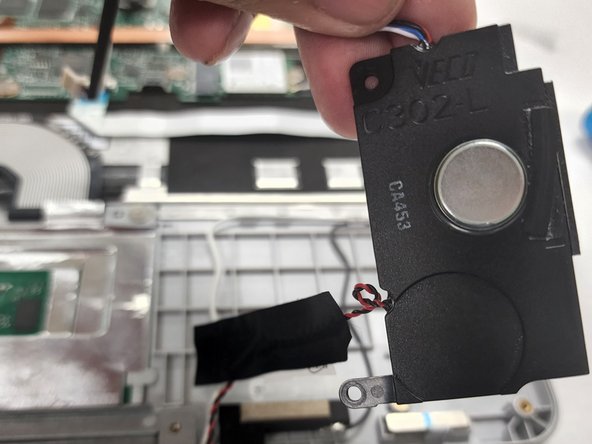

  8. Asus Chromebook Flip C302CA Touchpad Replacement, Speakers: crwdns2935265:08crwdnd2935265:01crwdnd2935265:03crwdne2935265:0 Asus Chromebook Flip C302CA Touchpad Replacement, Speakers: crwdns2935265:08crwdnd2935265:02crwdnd2935265:03crwdne2935265:0 Asus Chromebook Flip C302CA Touchpad Replacement, Speakers: crwdns2935265:08crwdnd2935265:03crwdnd2935265:03crwdne2935265:0
    • Remove the two 2 mm screws from the speakers using a Phillips #00 screwdriver.

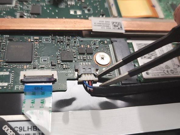

  9. Asus Chromebook Flip C302CA Touchpad Replacement: crwdns2935265:09crwdnd2935265:01crwdnd2935265:03crwdne2935265:0 Asus Chromebook Flip C302CA Touchpad Replacement: crwdns2935265:09crwdnd2935265:02crwdnd2935265:03crwdne2935265:0 Asus Chromebook Flip C302CA Touchpad Replacement: crwdns2935265:09crwdnd2935265:03crwdnd2935265:03crwdne2935265:0
    • Detach the cable that is connected to the motherboard using a pair of blunt tweezers.
  10. Asus Chromebook Flip C302CA Touchpad Replacement: crwdns2935265:010crwdnd2935265:01crwdnd2935265:02crwdne2935265:0 Asus Chromebook Flip C302CA Touchpad Replacement: crwdns2935265:010crwdnd2935265:02crwdnd2935265:02crwdne2935265:0
    • Remove both speakers from the laptop and set them aside.

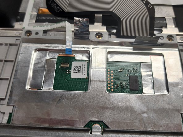

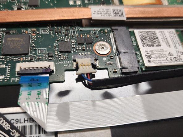

  11. Asus Chromebook Flip C302CA Touchpad Replacement, Touchpad: crwdns2935265:011crwdnd2935265:01crwdnd2935265:01crwdne2935265:0
    • Lift the tab connected to the motherboard using tweezers.

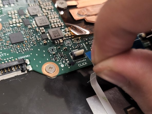

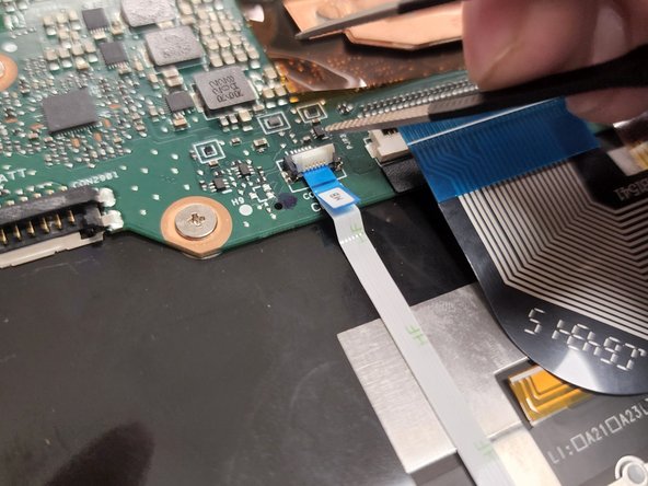

  12. Asus Chromebook Flip C302CA Touchpad Replacement: crwdns2935265:012crwdnd2935265:01crwdnd2935265:03crwdne2935265:0 Asus Chromebook Flip C302CA Touchpad Replacement: crwdns2935265:012crwdnd2935265:02crwdnd2935265:03crwdne2935265:0 Asus Chromebook Flip C302CA Touchpad Replacement: crwdns2935265:012crwdnd2935265:03crwdnd2935265:03crwdne2935265:0

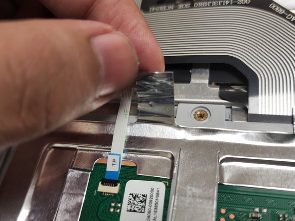

    • Flip up the ribbon cable tab using a pair of tweezers.
    • Disconnect the cable by holding the blue tab with your fingers and pulling out towards you.
  13. Asus Chromebook Flip C302CA Touchpad Replacement: crwdns2935265:013crwdnd2935265:01crwdnd2935265:03crwdne2935265:0 Asus Chromebook Flip C302CA Touchpad Replacement: crwdns2935265:013crwdnd2935265:02crwdnd2935265:03crwdne2935265:0 Asus Chromebook Flip C302CA Touchpad Replacement: crwdns2935265:013crwdnd2935265:03crwdnd2935265:03crwdne2935265:0

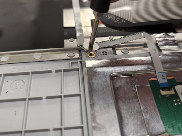

    • Remove three 3 mm screws from the trackpad using a Phillips #00 screwdriver.

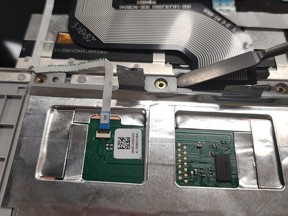

  14. Asus Chromebook Flip C302CA Touchpad Replacement: crwdns2935265:014crwdnd2935265:01crwdnd2935265:02crwdne2935265:0 Asus Chromebook Flip C302CA Touchpad Replacement: crwdns2935265:014crwdnd2935265:02crwdnd2935265:02crwdne2935265:0
    • Detach the ribbon cable and silver adhesive attached to the computer by pulling it up towards you.

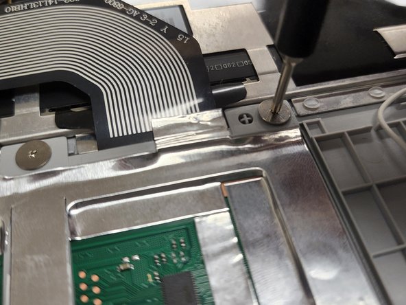

  15. Asus Chromebook Flip C302CA Touchpad Replacement: crwdns2935265:015crwdnd2935265:01crwdnd2935265:03crwdne2935265:0 Asus Chromebook Flip C302CA Touchpad Replacement: crwdns2935265:015crwdnd2935265:02crwdnd2935265:03crwdne2935265:0 Asus Chromebook Flip C302CA Touchpad Replacement: crwdns2935265:015crwdnd2935265:03crwdnd2935265:03crwdne2935265:0
    • Use a spudger to pry up all around the edges where the screws were to loosen the trackpad.

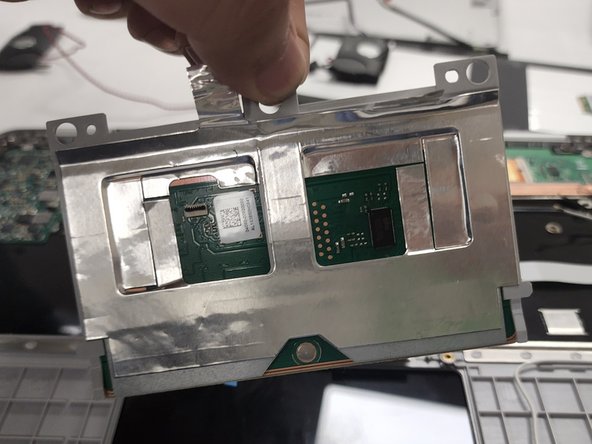

  16. Asus Chromebook Flip C302CA Touchpad Replacement: crwdns2935265:016crwdnd2935265:01crwdnd2935265:02crwdne2935265:0 Asus Chromebook Flip C302CA Touchpad Replacement: crwdns2935265:016crwdnd2935265:02crwdnd2935265:02crwdne2935265:0
    • Lift up the trackpad to remove it from the laptop.
