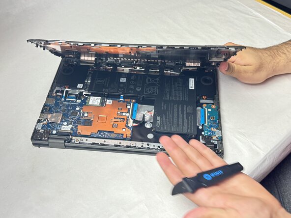

    • Use a Jimmy to detach the clips along the edges of the Chromebook.
    • Remove the bottom cover from the laptop.

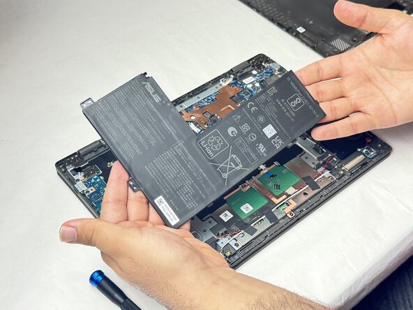

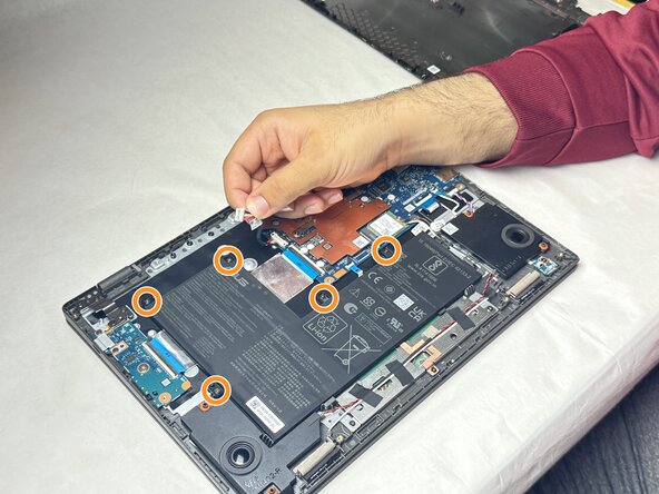

    • Detach the battery's cable connector from the motherboard.
    • Remove the five screws from the battery using a Phillips #1 screwdriver.
    • Remove the battery from the laptop.
