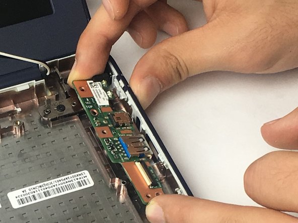

  7. Asus Chromebook C202 Input/Output Board Replacement, Input/Output Board: crwdns2935265:07crwdnd2935265:01crwdnd2935265:02crwdne2935265:0 Asus Chromebook C202 Input/Output Board Replacement, Input/Output Board: crwdns2935265:07crwdnd2935265:02crwdnd2935265:02crwdne2935265:0
    • Remove two 4 mm Phillips #1 screws connecting the I/O board to your Chromebook.
    • Slide the I/O board out from the edge of your Chromebook.
